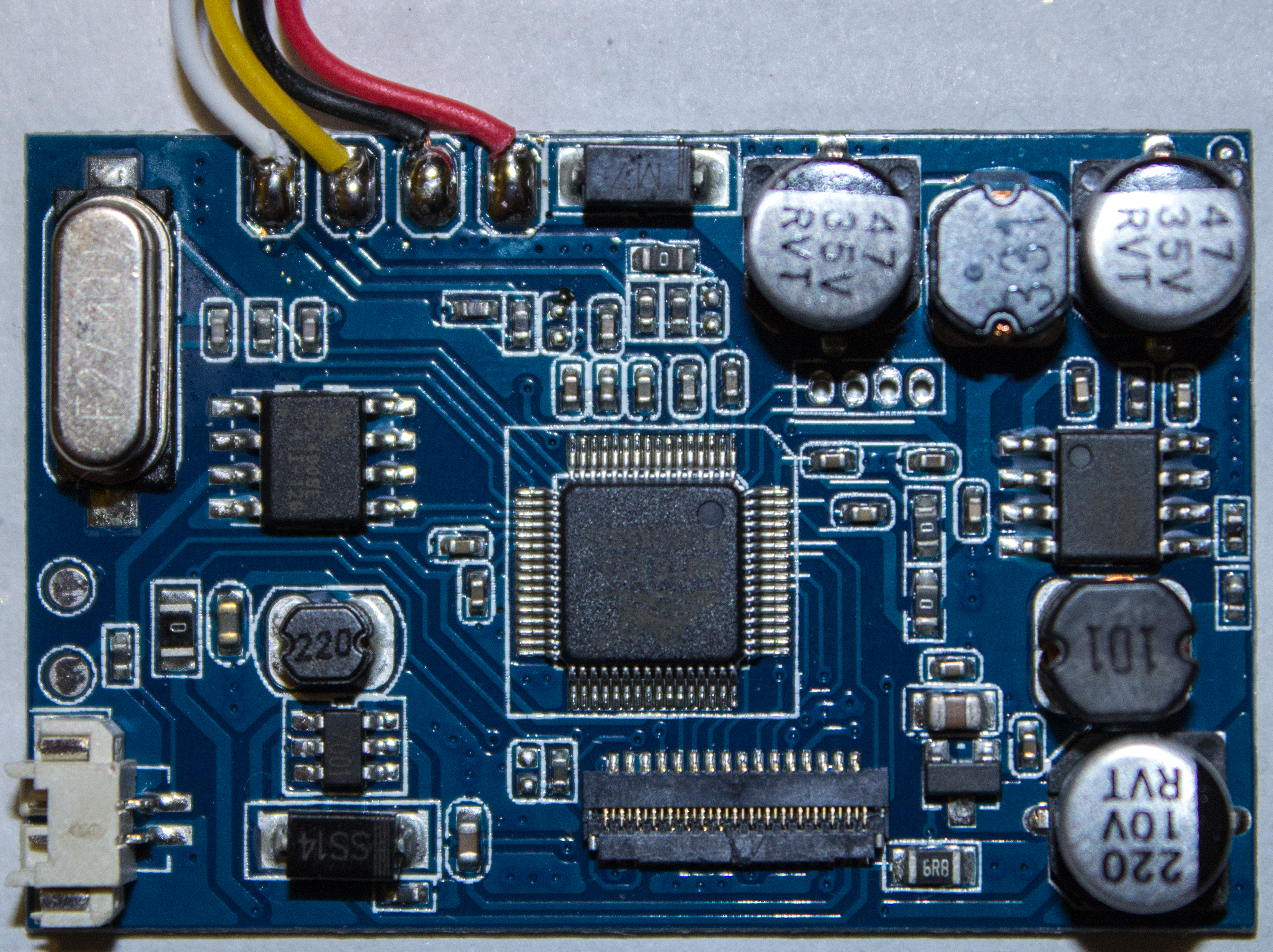

So I have been poking around and thought that the GBZ would be a sweet project to embark on. I followed wermy's link on the GBZ Custom to the amazon page and purchased the BM screen there. It came yesterday and I cracked it open only to discover that my board was quite a bit different than the one in wermy's video. He mentions this but...unfortunately for my bad luck...Mine is the only set up without a solution for 5v conversion. It's Version 9 in the Wiki and I have no idea where to begin. Any advice is appreciated.
Thanks guys.
http://sudomod.com/wiki/images/3/32/BW_V9_Board.jpg

See this image below and do the same thing to the chip on the right side of the board:

Perfect. I wasn't sure if it would be that simple. Thanks a million.
