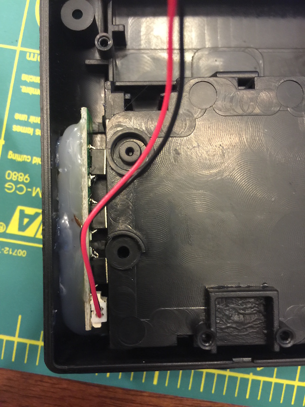

One of my main goals is to save the battery bay and drill little to none of it. Still working on power source but I'm planning on using 4x14500 li-ion cells in parallel which should give me about 3200mAh battery at 3.7V and it'll fit perfectly in the battery bay.
Latest status Screen buttons in battery bay
I replaced the buttons that came with the screen with 3 that I bought from Fry's. The buttons are lower profile and just long enough to peek through to the battery bay.
Button holes

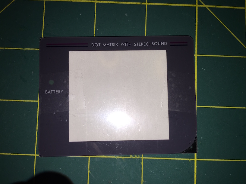

I didn't have tracing paper so tried to use some tissue paper but it wasn't white. The black case also made it hard to see the graphite transfer so I drew some parallel lines to the existing buttons to get a general position. I also used an xacto knife to score out the portion of the screen I wanted to take off. I'm using the screen protector that came with the screen and cut it down to size with an xacto knife. I found that I could make really clean lines by repeatedly scoring and breaking it off.
You can see here. I tried to use the dremel to cut the top edge first and it's a little rough. The other 3 sides, I scored with an xacto knife and breaking off.
Button holes

Looking great. I like what you've done with the screen buttons - I'll be interested to see how the space works out and might try something similar

What did you use for the screen cover?razor wrote:Parts list so far:

Thought I'd just mention that other users are using the plastic screen cover that came with the screen.
Re: Razor's GBZ progress
@Rod2D2 I actually took the idea from @chiz
The screen I got from amazon comes in a housing and if you use a heat gun, you can soften the blue holding the screen cover to the housing.
Once it was off, I measured the black bevel to make sure it would be the same size all the way around the screen area by using the original gameboy screen as a guide. Then, I just used an xacto knife to score the screen protector repeatedly (with a ruler) until I could break off the extra parts.
