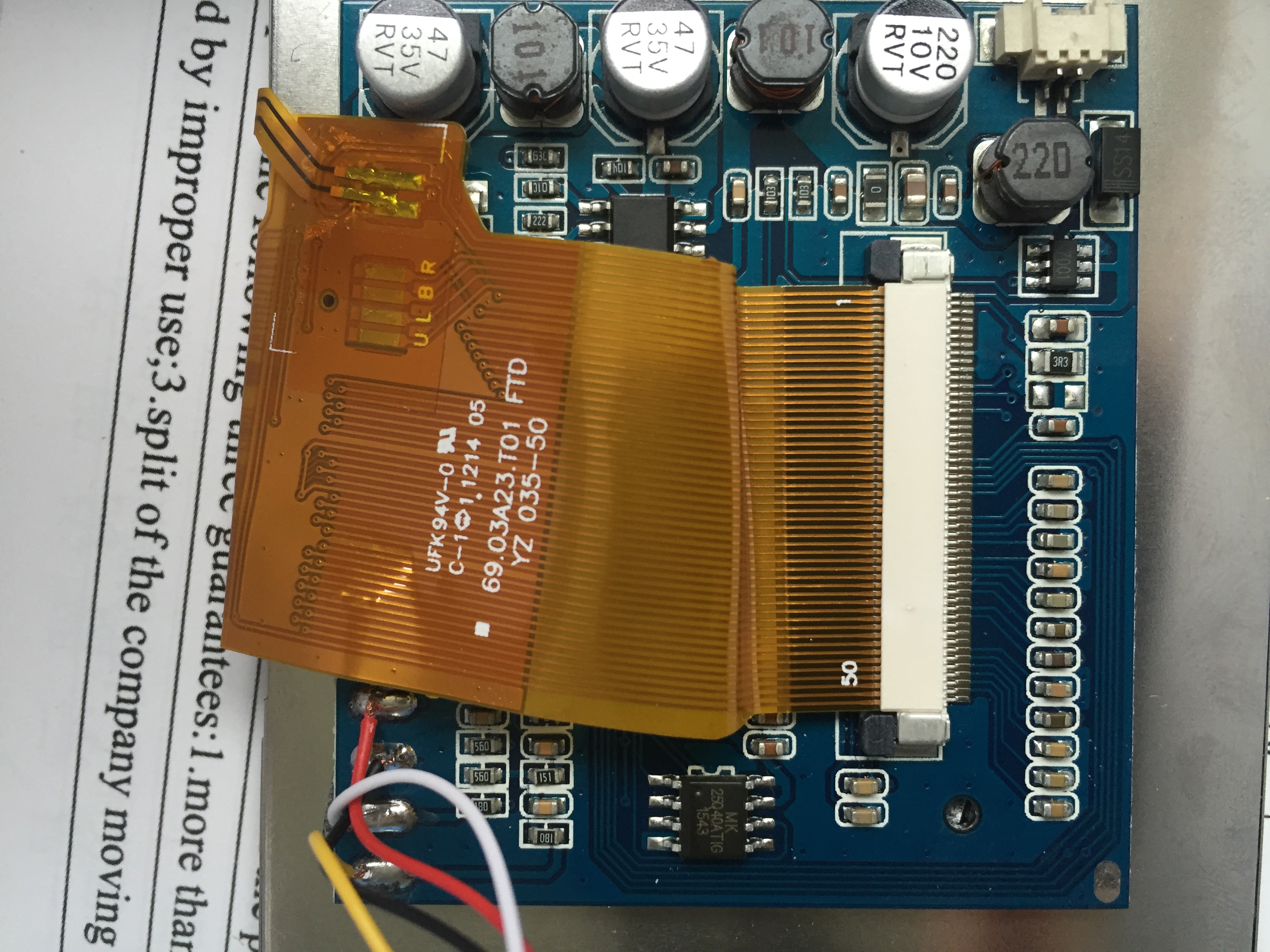

Sorry to jump on your thread but does anyone know if this display i have will work out of the box at 5v?
its a bw model sold by bw corp on amazon uk
heres a picture of the board
is there any easy way of testing without soldering it all together?

Post by Fleder » Wed May 11, 2016 2:01 am
Robots86 wrote:is there any easy way of testing without soldering it all together?
Yes, there is, but it would help t see the whole board.
It looks like this one: https://s20.postimg.org/6jvbxrfml/mamo_board_2.jpg
As you can see on my spreadsheet.
But i am not sure, so you should use a multimeter before getting started,
or you will end up like poor 1461748123 here.
Compare the ICs names with the one from my picture guide here,
if those are the same and everything else is in the same place,
you should be fine with following it.
yeah looks like the one on that link. was hoping no mod required
