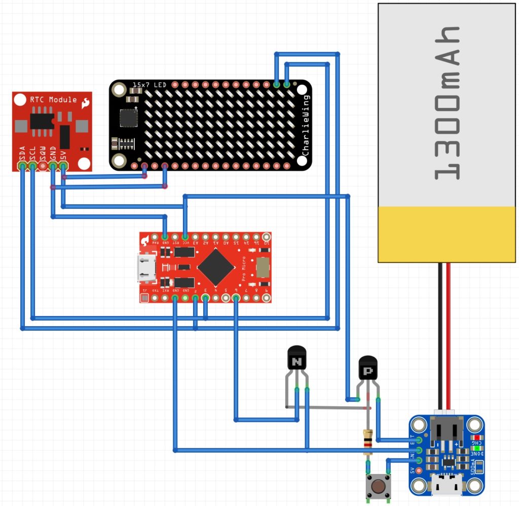

And here is a wiring diagram, which should help (ignore the battery capacity – I used a 500mAh):
