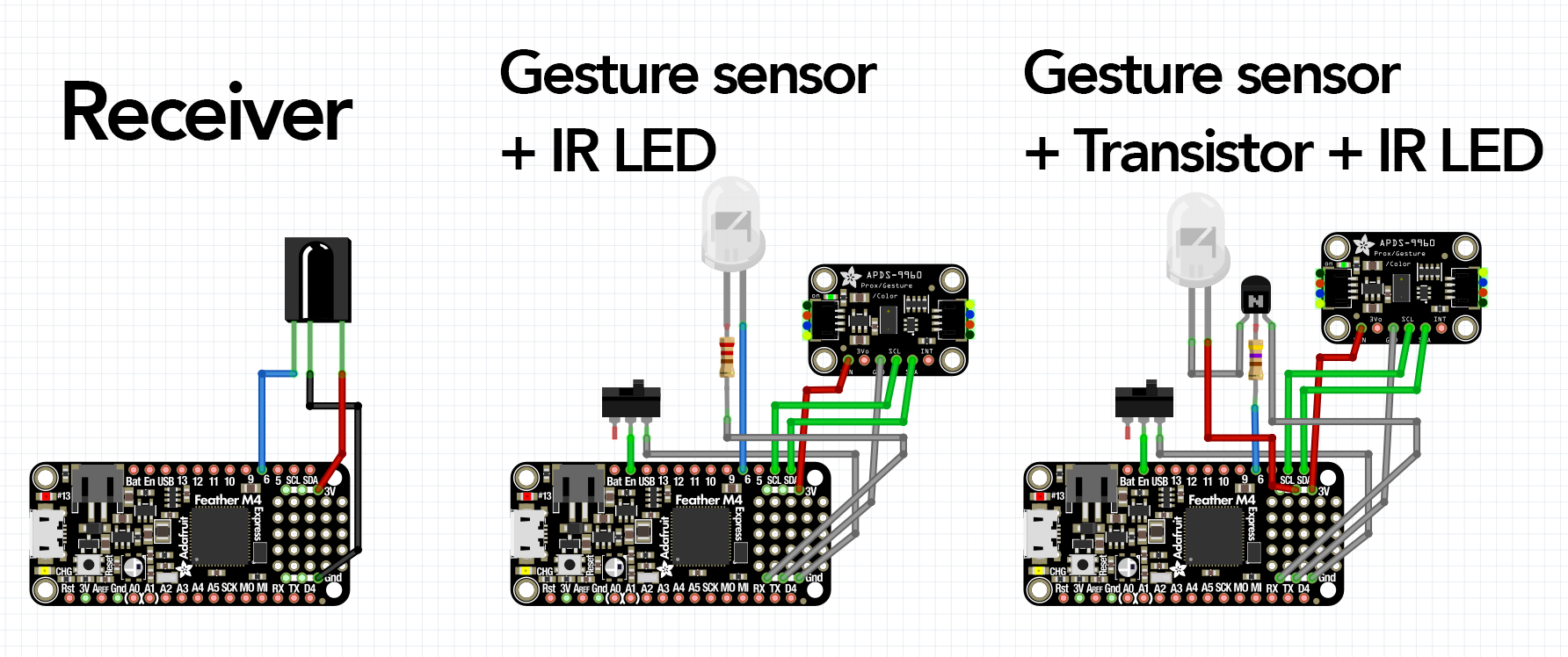

- Wire up an IR receiver to a Feather M4 Express
- Load some CircuitPython code that will print out what the IR receiver captures
- Grab all the IR codes you need from your TV’s remote
- Wire up an IR LED and APDS9960 gesture sensor
- Drop your IR codes into another CircuitPython script
