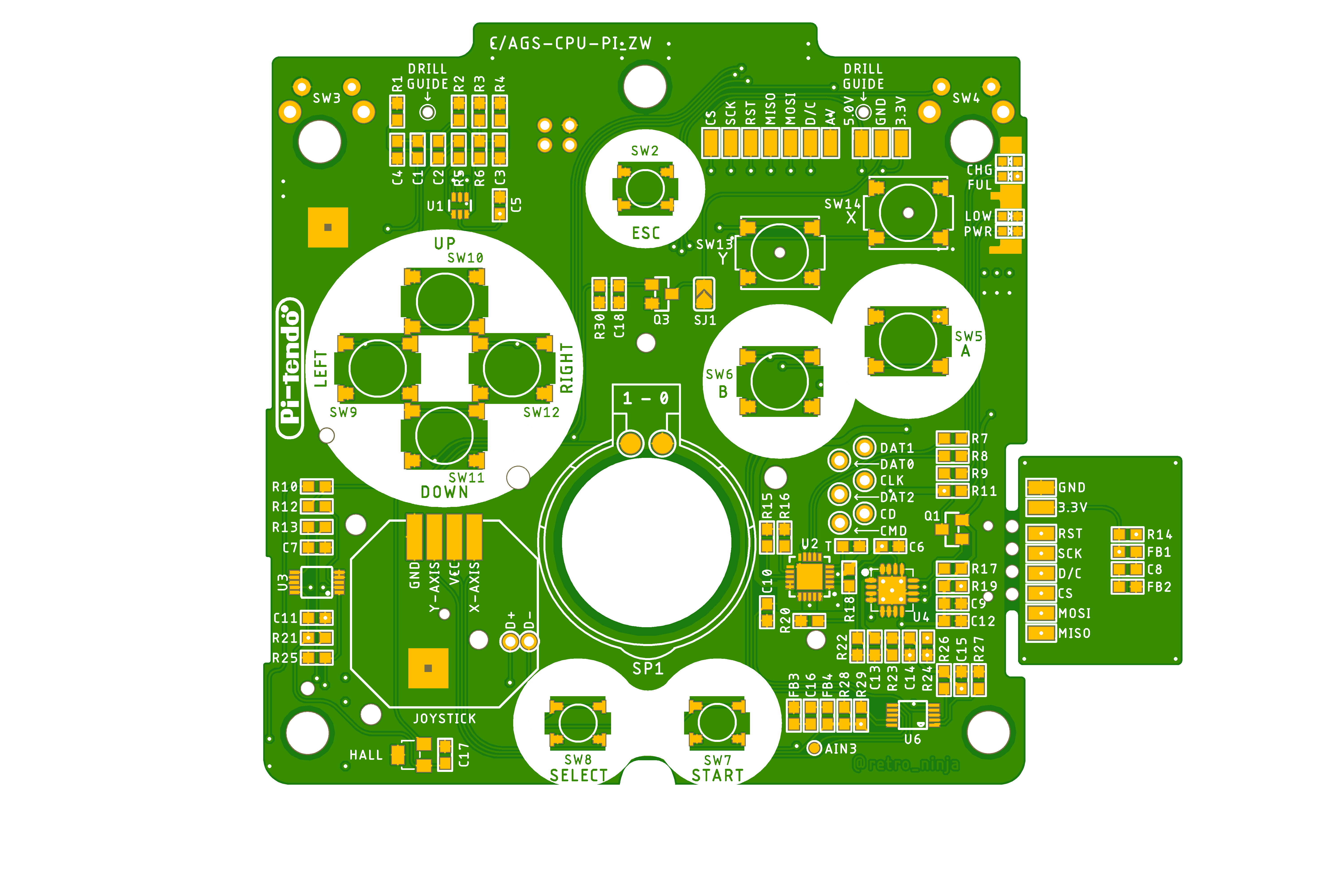

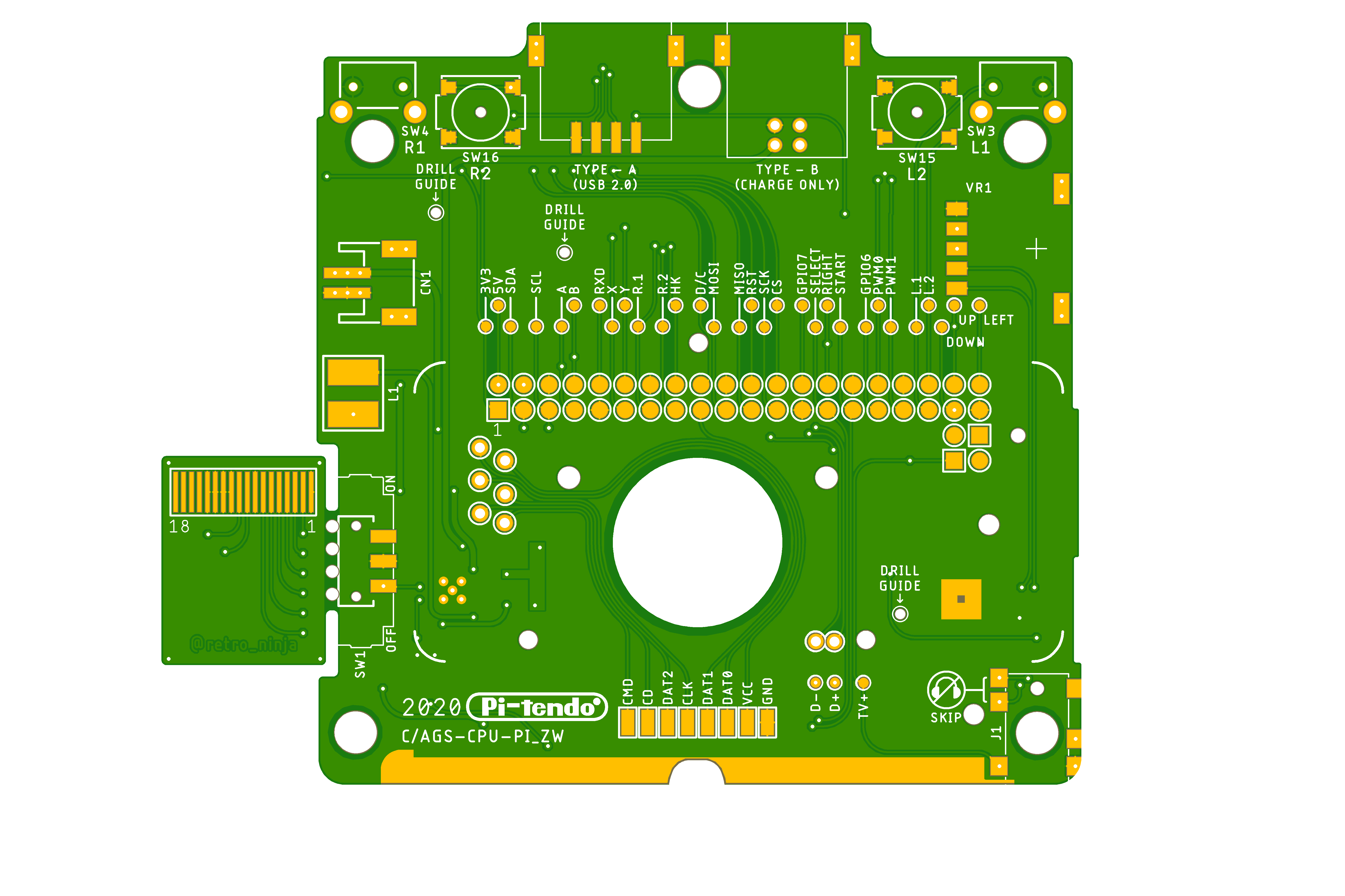

Good day to you guys. Let me present to you my own design, the GBA Pi-SP Zero. Please give me some feedback and suggestions to improve the board. Also, i have no prototype yet, sorry. This is mainly influenced by Wermy's Mintypi and Helder's works. A big thanks to both of them. :D :D
Features:
- Type - A USB port
- can use SPI LCD or Composite LCD
- Hall effect sensor turns off the LCD instead of shutting down the rPi. (tho it is optional)
- external micro SD card breakout
- LED indicator for Low Battery
- 3.5mm headphone jack (optional)
- L2 and R2 buttons (optional)
- PSP joystick (optional)
PS: i can give you the gerber files if you want to make this on your own and also to help me with improvements of the board.
PPS: english is not my primary language. :)

Looks excellent, I'm definitely interested in this project.
Hall effect sensor is a great idea, however I wonder if the placement just below the analog stick is the best one?

Pretty interesting and you crammed a ton in there and put most of it in the front. Have you held one of these GBASPs before? Its not very big and that joystick would get in the way and I'm not even sure how R2/L2 would even possibly work either.

How do you mean the joystick would get in the way? It's a bit far down maybe but not unreasonably much so compared to designs such as Kites Circuit Sword.
The placement of R2/L2 is comparable as well, I think it's a clever way of adding another optional two buttons. :)
