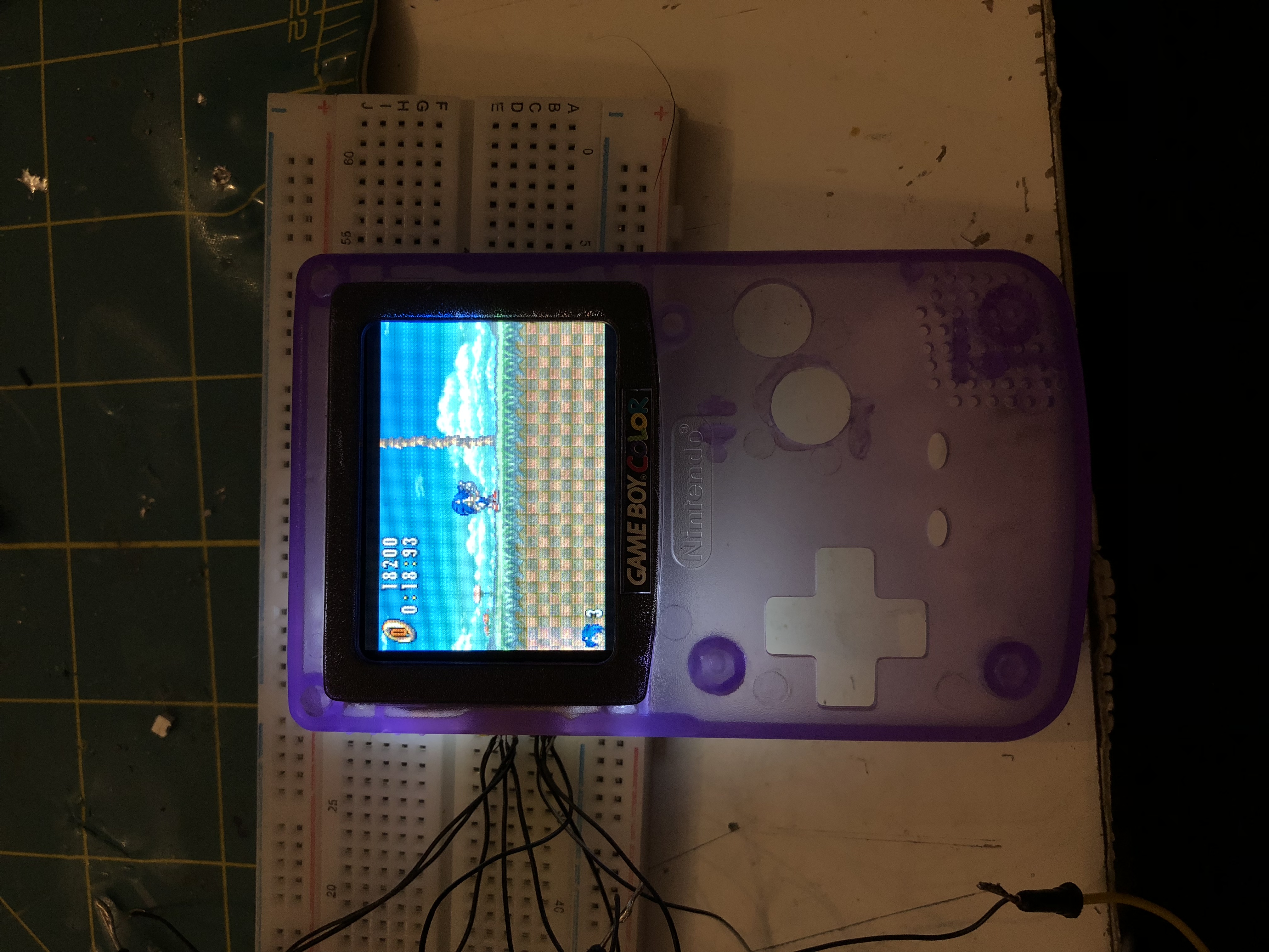

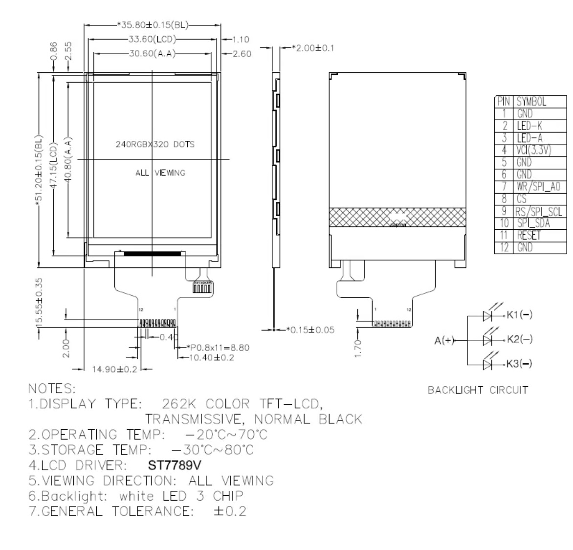

Yes I will use ST7789v 2.0 screen this one
https://m.aliexpress.com/item/329063894 ... sstype=600
Yesterday day I've been able to run it, but there are some software problems I think, everything is excellent, but the colors are a bit dull. “I'm not good at this type of programming I can say it works by luck”
Screen in action
https://instagram.com/p/Bmr-SuPluWv/
Screen datasheet and wiring if someone interested 1- GND
2- LED-K —-> GND
3- LED-A —-> 3.3
4- VCC —-> 3.3
5- GND
6- GND
7- WR/SPI_A0 —-> D/CX GPIO24
8- CS —-> CSX GPIO8
9- RS/SPI_SCL —-> SCL GPIO11
10- SPI_SDA —-> MOSI GPIO10
11- RESET —-> RESET GPIO25
12- GND
