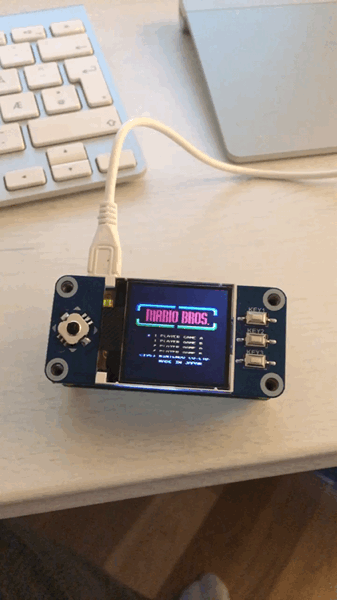

Here are the things I changed to get the screen and buttons working.
/etc/modprobe.d/fbtft.conf
# /etc/modprobe.d/fbtft.conf
options fbtft_device name=adafruit18_green gpios=reset:27,dc:25,cs:8,led:24 speed=40000000 bgr=1 fps=60 custom=1 height=128 width=128 rotate=180
/boot/config.txt

dtparam=i2c_arm=off
#dtparam=i2s=on
dtparam=spi=on
# Uncomment this to enable the lirc-rpi module
#dtoverlay=lirc-rpi
# Additional overlays and parameters are documented /boot/overlays/README
# Enable audio (loads snd_bcm2835)
dtparam=audio=on
gpu_mem_256=128
gpu_mem_512=256
gpu_mem_1024=256
#overscan_scale=1
hdmi_force_hotplug=1
hdmi_cvt=128 128 60 1 0 0 0
hdmi_group=2
hdmi_mode=1
hdmi_mode=87
display_rotate=1
#disable uart to boost boot speed
enable_uart=0
start_x=0

However, I have a problem with this 1.44" LCD Hat on a Pi Zero W. The color flickers..
It's like some of the signal got lost, as if color depth was dropping sporadically. It's particularly frequent in Retropie (ES and retroarch).
I tried both a fresh raspbian lite + these instructions and a TinyPi image with JamesW's changes above. This glitch occurs in both cases.
Could it be related to system activity? For example, in console this occurs much less often than in Retropie, but I can still trigger that glitch by just opening a text file, or connecting over ssh. It also happens noticeably when starting a video with omxplayer or a gif with FBpyGIF.
I thought, maybe this LCD is defective somehow, or maybe the power supply isn't good, but I tried with a Pi 2B using the the same SD card, same power supply and power cable: it works perfectly despite the additional power draw of the Pi2 vs the Pi Zero.
Then I thought okay, then it has to be the WiFi or BT causing some noise; but I disabled both to no avail. Heck, I even soldered headers on a Pi Zero 1.3 (no W), put the hat and the SD in it, and got the exact same result. I also updated the firmware on both Zeroes.
Would somebody here know what could cause this glitch in the Pi Zero (W or otherwise) ?

My first thought is to check the speed, you might has a screen that doesnt like the speed you are using
ptitneo
Posts: 10
Joined: Fri Jun 17, 2016 4:53 pm
Re: 1.44" 128x128 pi zero hat
Post by ptitneo » Mon Oct 01, 2018 6:16 am
moosepr wrote:
Mon Oct 01, 2018 5:11 am
Thanks for the advice. I assume you are referring to the speed in /etc/modprobe.d/fbtft.conf. I used the param from this thread (speed=40000000) which also matches the one given in waveshare's blog post. I have no idea what other values to try though (or what impact to expect).
Edit: I randomly tried speed=20000000 and it works! Thanks a lot moosepr!

awesome news!! you could try playing with the value. It will impact the speed of the comunication if its low, stopping you being able to get a good fps.
The number is used to calculate the multiplier that gets used in the actual communication speed, so it is actually impacted by the cpu clock speed. If you have any overclocking in place, the multiplier doesnt change, so you will end up with a higher speed comunication and thus upsetting the screen, so you may need a lower speed value
if that makes any sense :P
