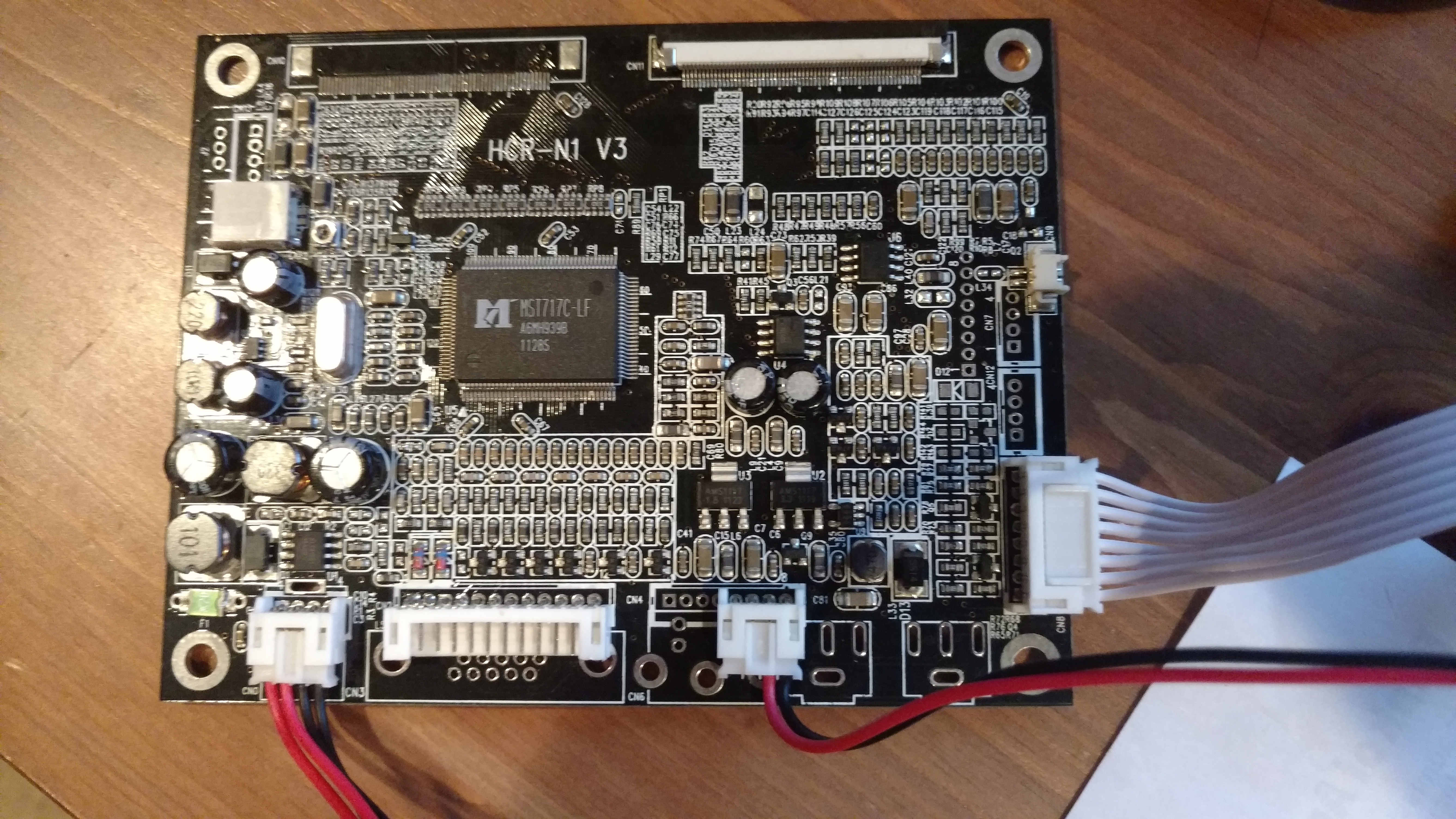

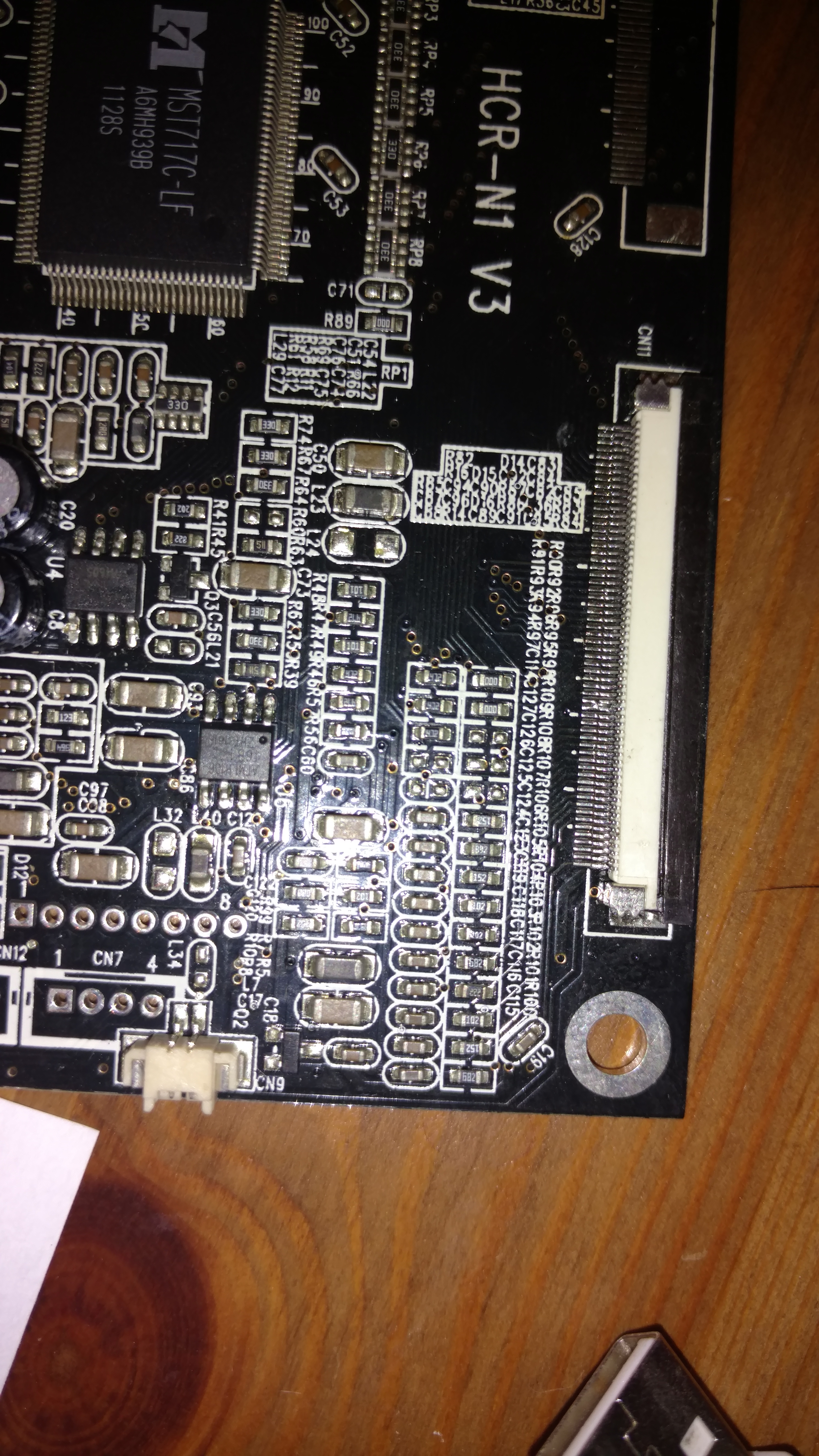

I am planning to build out a Wii U controller as well. Space is at a premium inside this thing for sure. I am going to attempt to keep the stock buttons, sticks, dpad and triggers by using FPC sticks and cable mounts. everything is already there to use and I realize it takes up precious space, but I figure to give it a try first. Due to space I might use the Zero but I have some ideas and I think I can fit a stripped down Pi 2/3 inside. We'll see what happens. The route I take with that will also determine battery used, whether it is the 2500mah flat lipo or a 4400 cylindrical. I will have all of my parts for the weekend so I will have a better idea soon of which way I am going to go with this.
I also bought a screen, the 6.2" TM062RDH03 60-pin with controller board. it is not a direct fit as the bezel is a little large, width-wise, by about 1/4 inch, so there is some trimming necessary inside the case. It was cheap enough to try out and from what the guy posted about it who built one already, he said he did not modify anything and just plugged it into 5V and it works. I bought a 5v step up to 12v module just in case, but if someone here knows how to modify the regulator, or makes a board for the screen, that would be awesome.
So pictures are OK, as good as my phone seems to want to take, but if you need numbers or other pictures, let me know and I will break out the real camera (needs a charge, so cell pics is all I got for now).

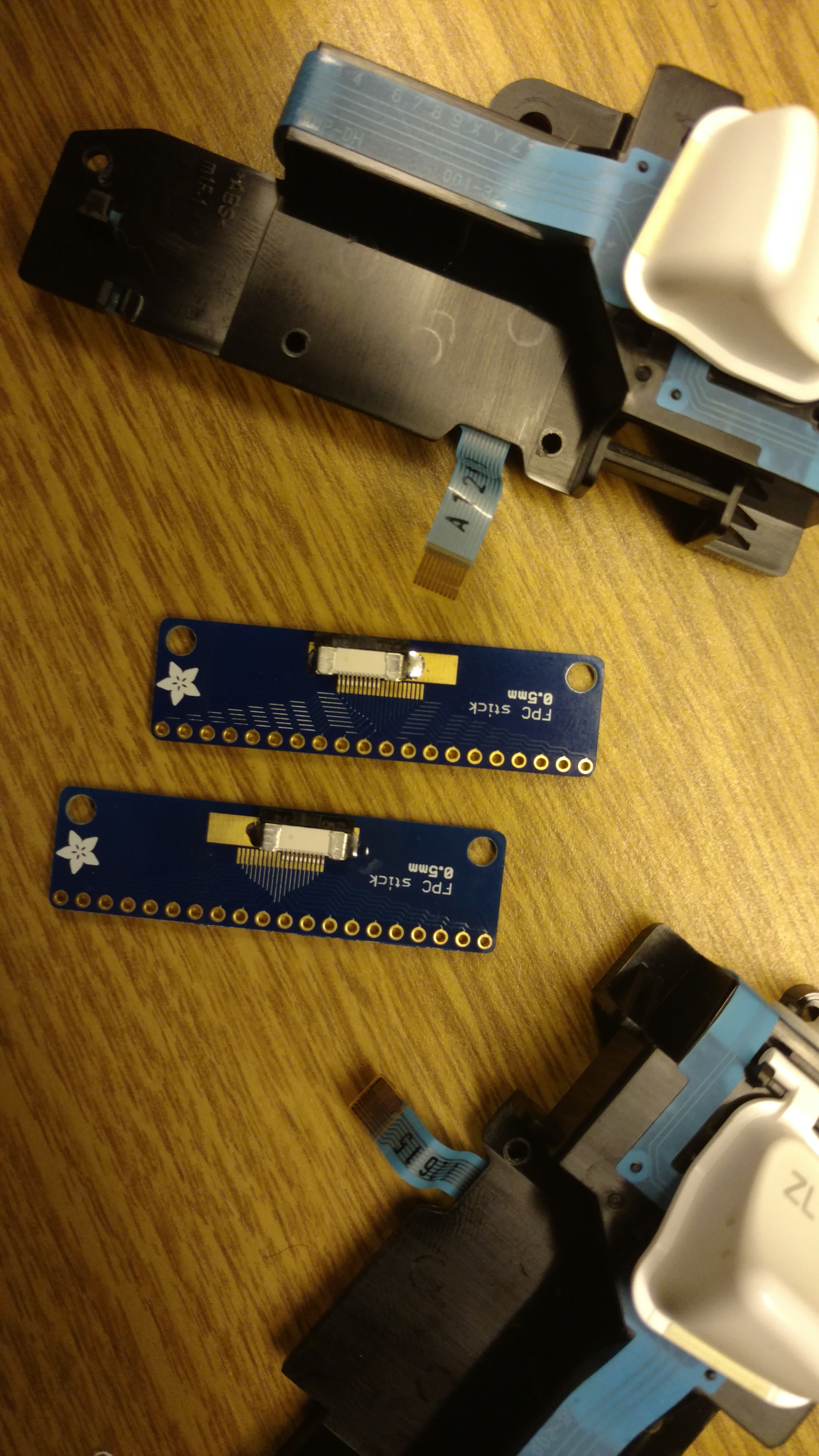

Adafruit has the FPC Sticks. They are about 2 inches long so not horrible in size.
https://www.adafruit.com/products/1325
I bought the 10-pin ribbon connector from Amazon since I had some GC to burn. I am sure they are found cheaper elsewhere, I just didn't bother to look.
https://www.amazon.com/gp/product/B00EQ ... UTF8&psc=1
the guy who did this and said to never do it again said they were 10 pin ribbon cable but he got 12 pin connectors which made it more difficult for him. I think with the correct parts, it will be much easier.
For the bottom buttons (control and power) I plan to just use 2 tactile buttons.

Sweet! Let me know if they fit (have the right pitch, etc) and I'll order some too.lotus1994 wrote:Adafruit has the FPC Sticks. They are about 2 inches long so not horrible in size.

The cables have those ears on the sides, which I will have to remove to fit in the connector. The Wii had the flip up style while the ones I got are the push/pull kind. I should be able to get something connected up this weekend when I have some time to put into this.
I probably will not use the bottom button for power but will put a switch somewhere else for that. I figure to use the bottom buttons for ESC and maybe something else that would be handy.
Re: Wii U Gamepad zero/gamepi project thread
Just can't leave well enough alone, I had to go play with all of my toys that came today for this project. I ended up soldering the connectors to the board, just to hold it in place, I did not solder each point yet. Had a migraine all day and trying to focus on such small stuff made me start to feel crappy again. And I need all of my faculties for soldering that small. I am not great at soldering and hope I can even do it! But I got them on the boards, trimmed the ears off the ribbons and test fit everything. Definitely no time tomorrow or Friday, but I should have some time over the long weekend to make some progress.

Looks good! Where did you get those boards?
