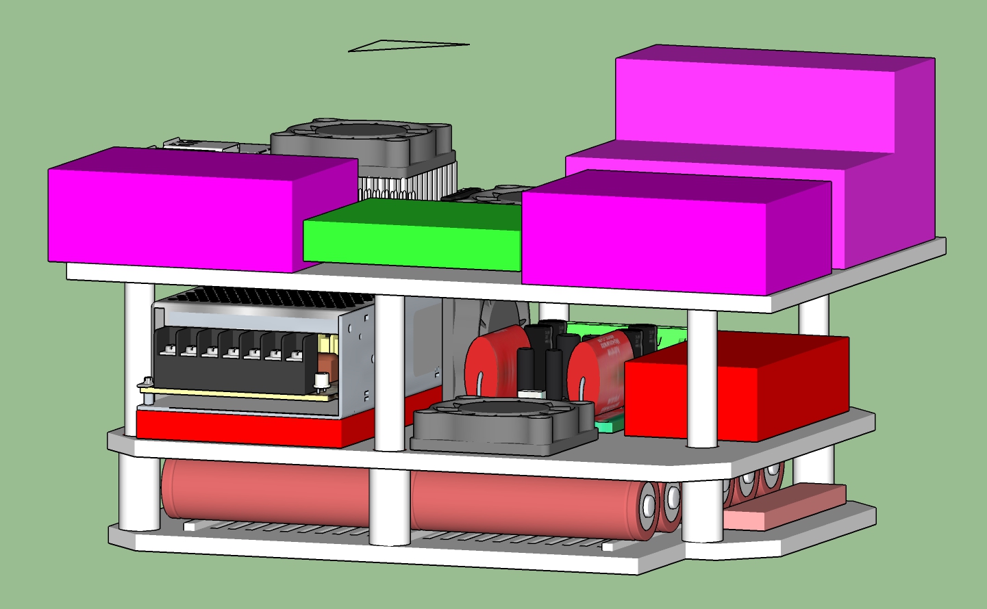

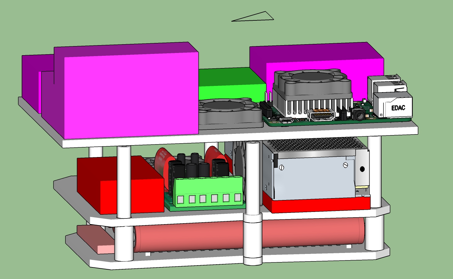

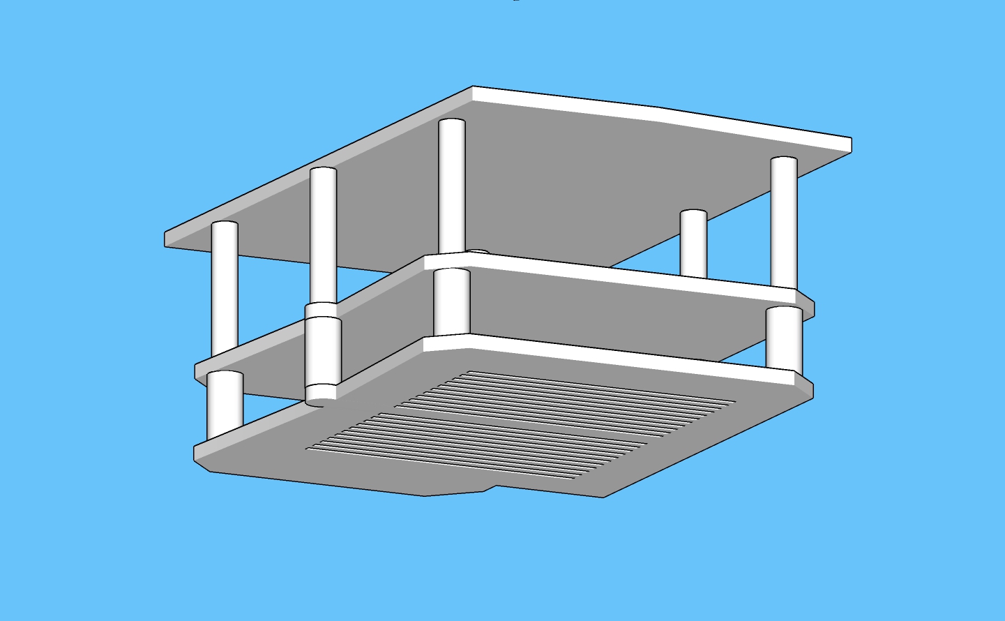

The internal structure
The battery stage is ok with all the ventilation holes, but i still need to work the power and computer stages.
On the right side of the battery, you can see the BMS.
The second stage (with red components) is dedicated to the power (AC/DC power supply, 12V/5V buck, UPS module)
The third stage is dedicated to the PI, the HDMI splitter (in green), and the power amp and sound filters (sound components are in purple)
There is still a lot of work to do with the structure as i want to add feets to PCB directly to the print but for this, i will need to have the components in my hand to make sure of screw placement (not all the sellers on ali give the schematics of their board)
The ultimate stage is supporting the speakers (still need to add the subwoofer and rework the ventilation holes)

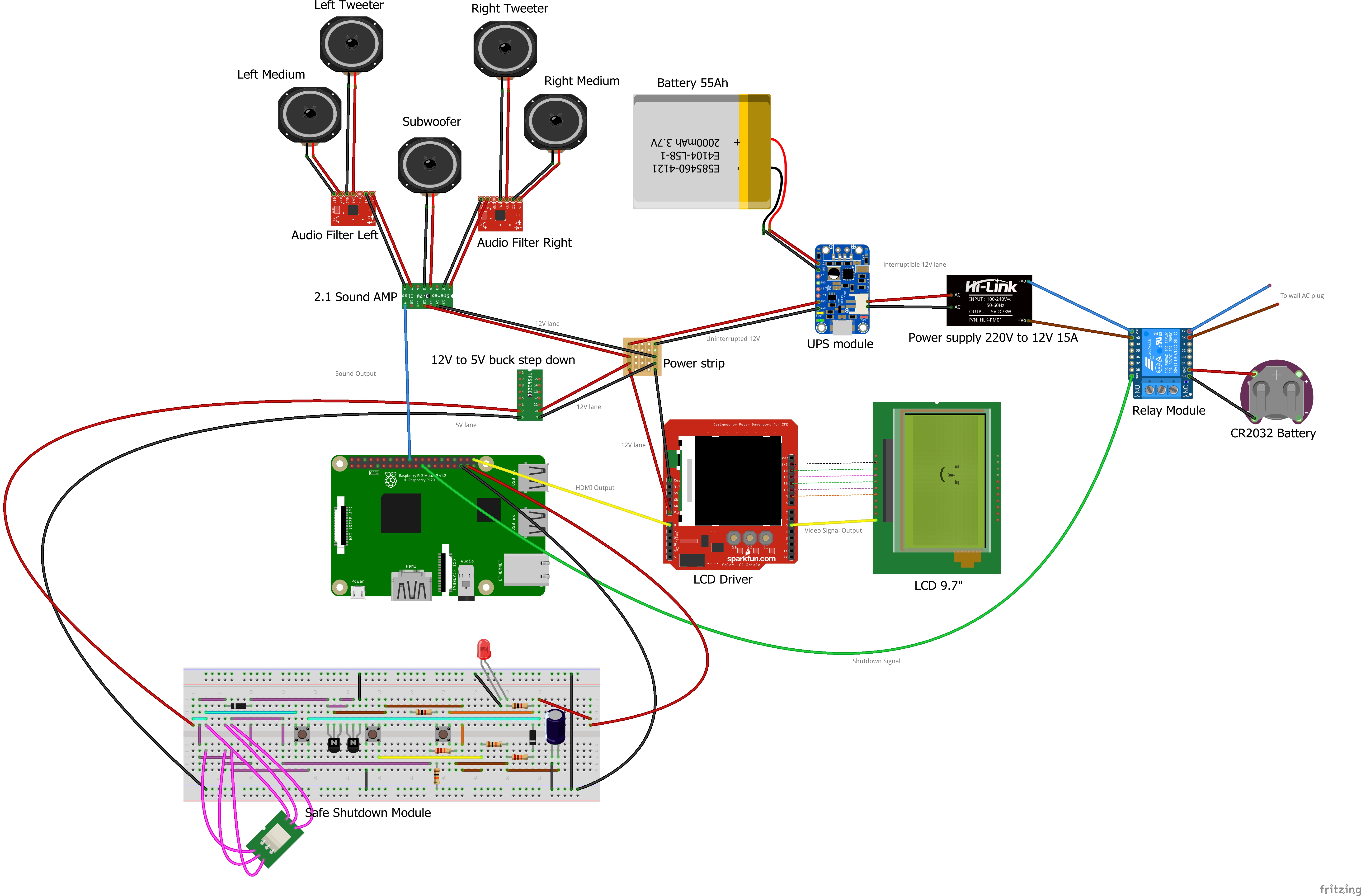

Global schematics (don't pay attention to the modules i have used, they are not the right one as Fritzing does not have what suits my needs) This schema is for reference only and understanding the internals.

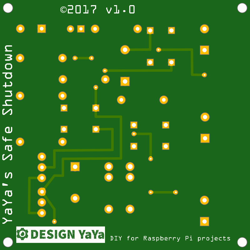

The safe shutdown board
The circuitry is taken from here https://www.pi-supply.com/make/adding-a ... pberry-pi/ thanks to them for sharing their knowledge. I'm using THT only because i'm not a super expert at soldering (even if i'm not a beginner)

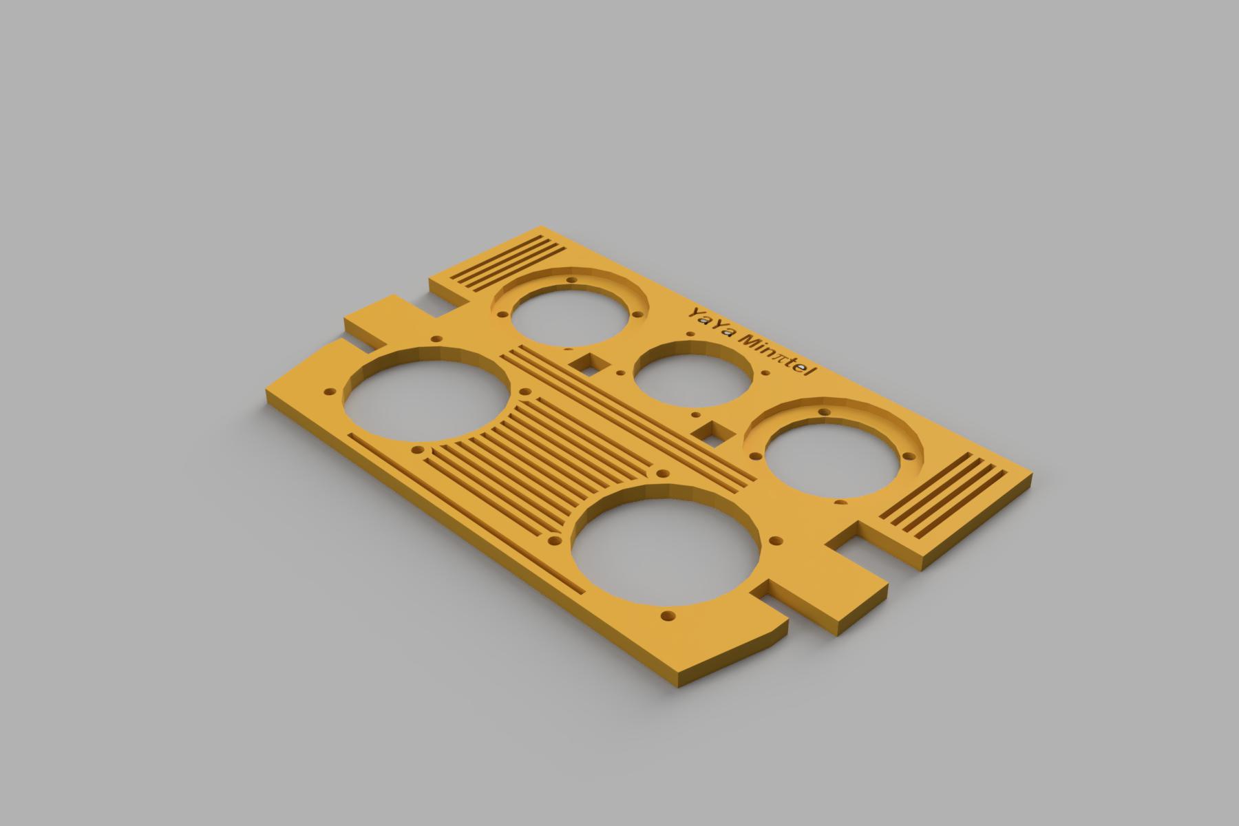

The most top stage is ready to go : Speakers support.
The embossed area is for tweeters, the small hole for a 40x40x10mm fan to extract heat, and the 2 others are for the medium speakers.
Unfortunately, i have no room available for the subwoofer so i need to find another room for it.
I found on ali express an extra small bass subwoofer (15mm thickness) so maybe i can put it under the battery tray. :?
I will see otherwise, it will be a stereo system with 2 ways. :roll:

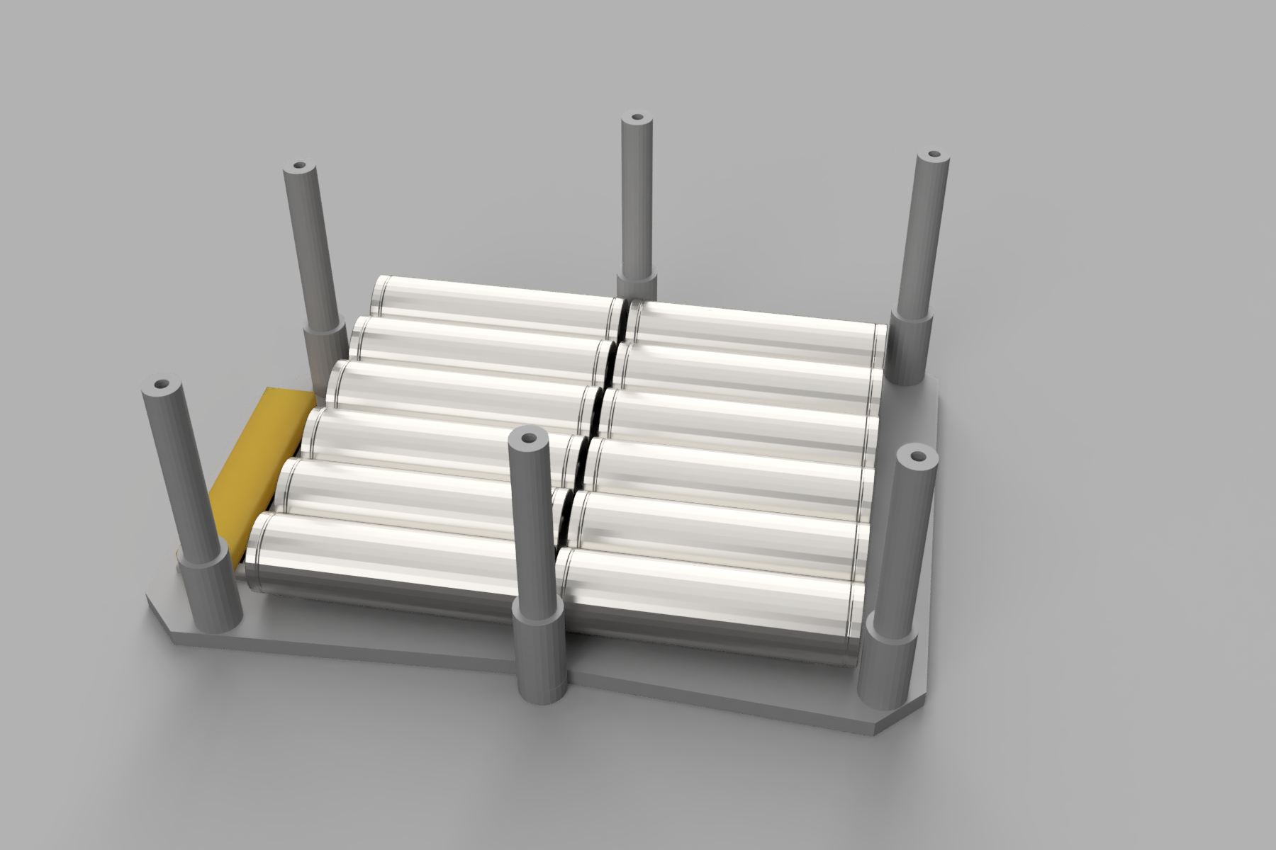

The first stage is complete : Battery Tray
The batteries will be packed with a heat shrink plastic and will be maintained by the pillars and the upper stage that sit on the bevel on each pillars.
On the left side, the battery management system (BMS)
