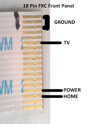

MENU is wired to home button and in my code it switches between joystick and keyboard mode. You can tap wires directly to all led's and front buttons as I did.ZarkWizard wrote:Ok.. I have most of it working.. Although there are a couple of minor questions..
On the Teensey there is a connection for "Menu". What is that connected to? I didn't see anything saying what it was connected to, nor do I see any available pins left on anything except for :
TV / Power / Home
Does anyone have the pinouts connections for that little board? I'd like to add a few more buttons as well as the "Menu", but I'd like to use the small board from the bottom. I figure I could wire it up if I could manage to find the pinouts.

That brings me to another point. I wired up the TV, Power, and Home buttons as well. It's not listed in the above docs, but I included an image in this message with the pin locations on the FRC. Remember to connect your ground (any one of the 3 pins to any ground on the teensy). I used the following Teensy pin locations for the buttons:
- // ------------- Bottom Row
const int ButHome = 8;
const int ButTV = 9;
const int ButPower = 10;

- TV-HOME-PWR Pinouts.png (116.03 KiB) Viewed 14307 times
