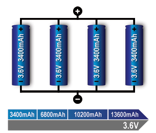

The batteries are all charged separately. But connected must be in the gamepad in row. How do you solve that?
are you sure? the voltage should remain stable and capacity should be doubled, so I thought that batteries in gamepad should be connected in parallel. can banjokazooie confirm the battery setup?
I can confirm that batteries are connected in parallel.

ok i am sorry. parallel... how do you want soldier it ?
http://batteryuniversity.com/learn/arti ... igurations
This site gives instructions on how to wire batteries in parallel.

Will this work so?
