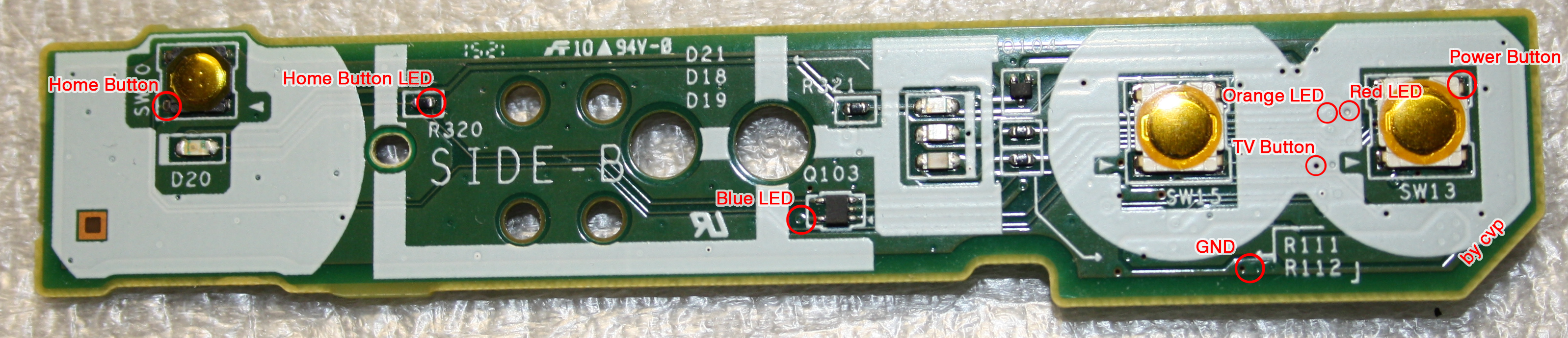

I need some help with the board. Can someone edit the image and mark where I need to solder the wire?
There is a photo here, but unfortunately it is not very clear. If the quality is too bad, I could try to make a better one
- board.png (2.96 MiB) Viewed 11016 times
i can´t help you, maybe @lordarkscream, he send me a photos afew months later, this is all i have
maybe the easy way is like @marty33, he use and fpc adapter, but i dont know how he wired to teensy
Thanks for pics. I think i have all points. See attachments, i hope thats right. But two questions:
1) for what does one need the "Isolated" cable?
2) and which cable we solder exactly where?
- board2.png (3.3 MiB) Viewed 10992 times
i dont know man, the only i know is that, but i don´t understand anythingcvp wrote: ↑Mon Aug 21, 2017 9:13 amThanks for pics. I think i have all points. See attachments, i hope thats right. But two questions:

Thanks to banjokazooie, I have created a board and sent it to Oshpark. It has the home, TV and power buttons. The power button is separate for use with the POLOLU switch. I used surface mount components (0805 size) for resistors and LEDs. The resistors I used were 270 ohm. The top 3 pads are to wire to the charger LED for full battery/charging indicators. I used 0 ohm resistors for those.
If anyone is interested, please let me know.
- 4b262adafd23fbd4f013af98640d27b6.png (9.33 KiB) Viewed 10842 times
