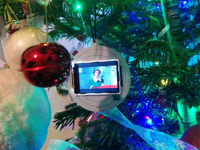

You may know, im no stranger to custom PCB's with screens and a pi all packaged together. So i had the crazy idea of making the PCB look a little like a Christmas decoration.
Now my design skills are weak, so the best I could muster was a bauble. It is currently just set to play Elf when it boots, but it could technically do anything (retropie on the tree anyone?)
on a side note, i have a bunch of spare boards if anyone wants one :) just drop me a PM

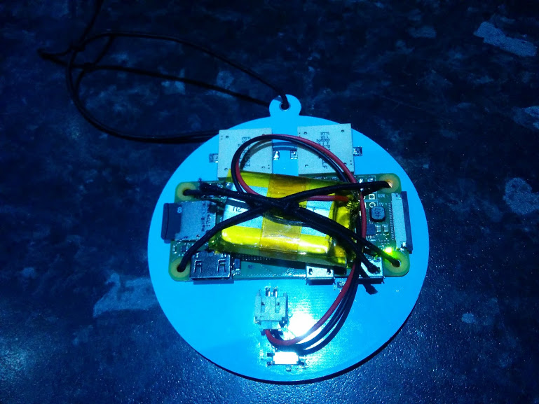

So what did you use in this project, i see two what seems to be speakers ? Maybe piezzo buzzers ?
Where is the charging board ? Under the battery ?
And the screen driver ? On the front side under the screen ?
Thanks for sharing this with us. Ho ho ho
Thanks for the nice comments 😀
You are correct, the piezo makes an appearance here, to provide token audio.
There is no charging board here, you have to take the battery off, and plug it in to another board to do any charging. There is also no protection or safe shutdown.
There is also no driver board needed for the screen, it is soldered straight onto the PCB and talks to the pi directly (like mintypi)
So yeah, a quick and dirty hack job 😉
