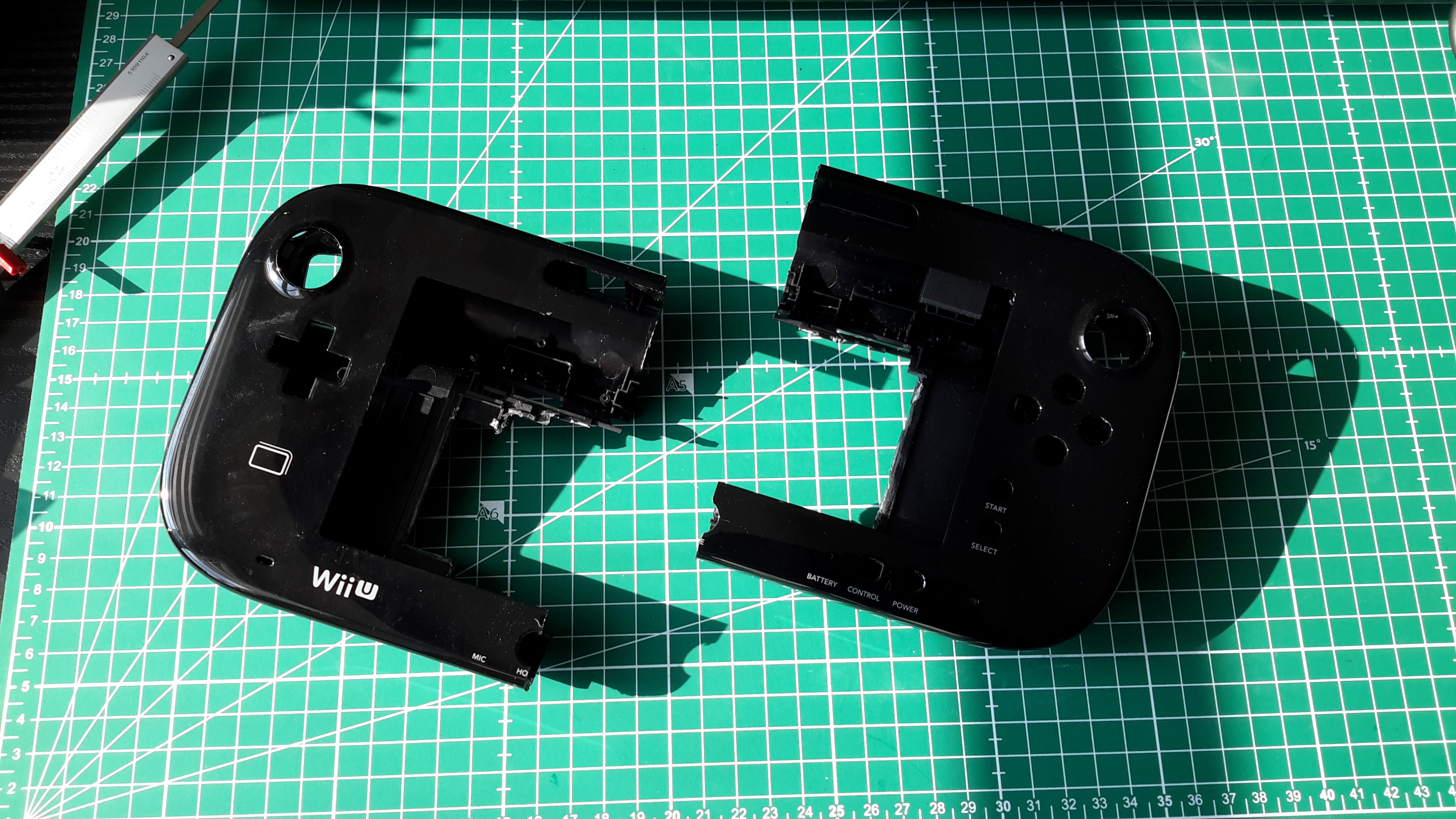

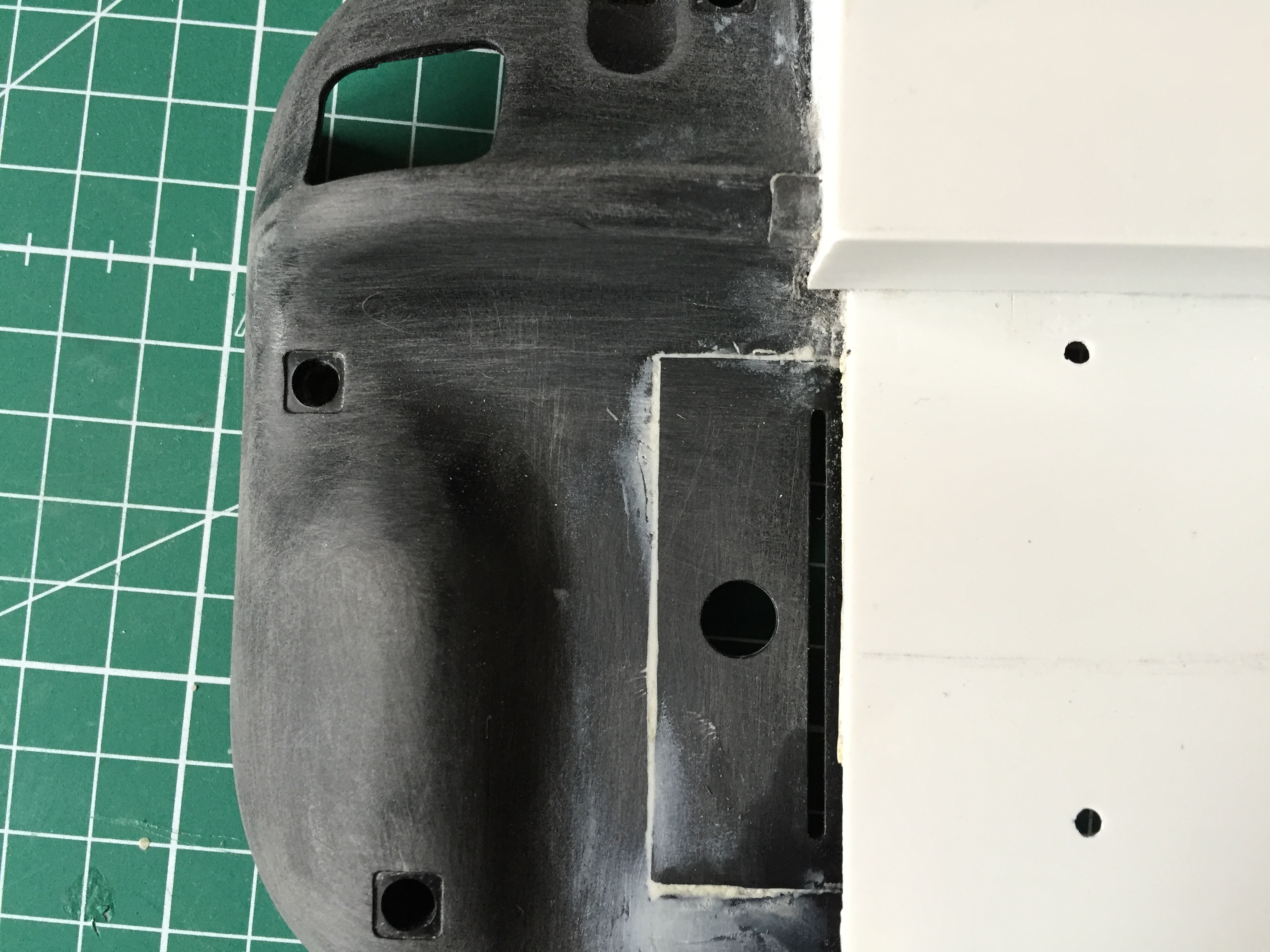

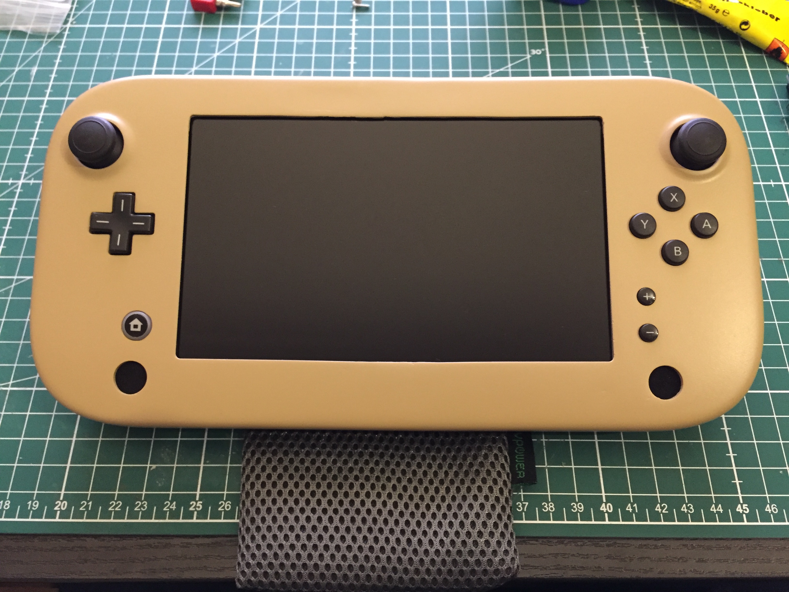

This is my Wii U Gamepad.
I build with many breaks 9 month and finish last two days and works fine :D

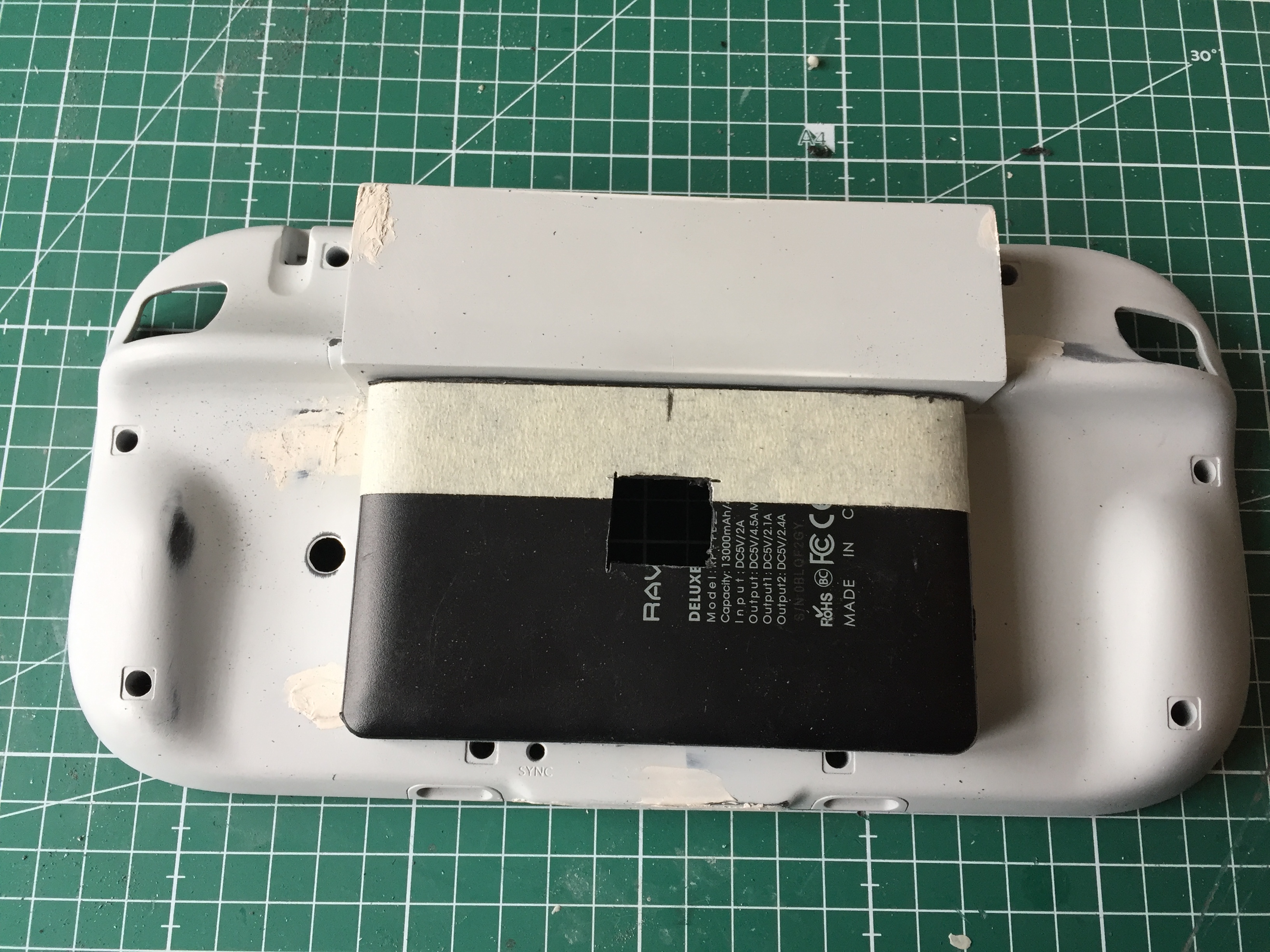

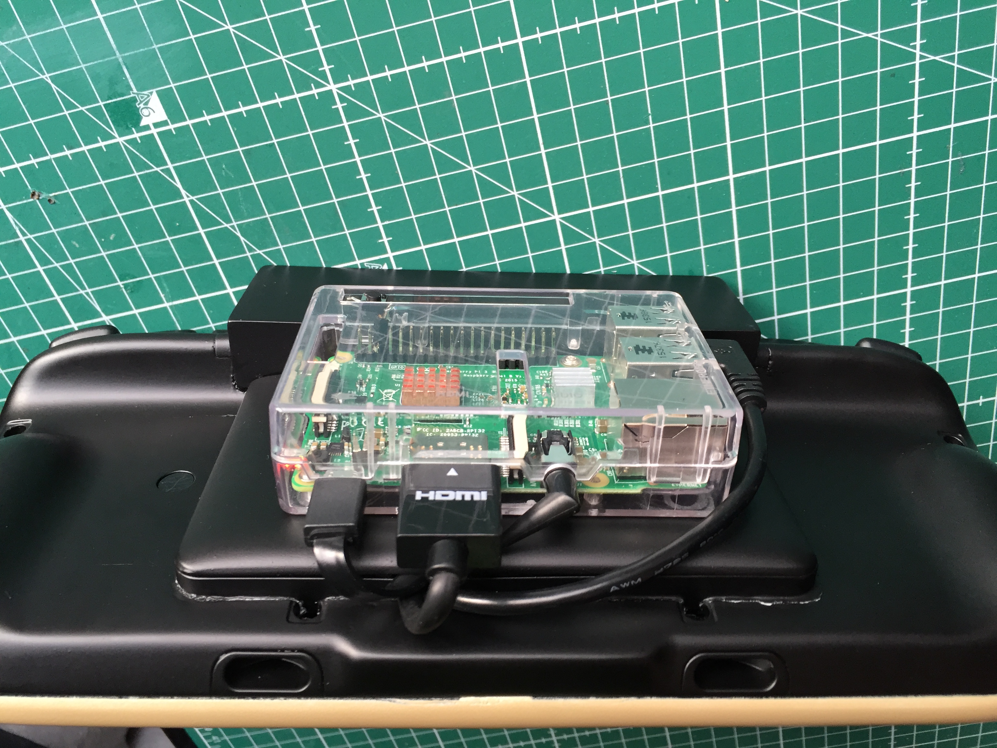

Part list
-Raspberry Pi 3
-Wii U pad
-China 7 Inch Screen / 1024x600
-Adafruit FPC Stick - 20 Pin 0.5mm/1.0mm Pitch Adapter
-FPC FFC 0.5mm Pitch 14 Pin Flip Type Ribbon Flat Connector
-Teensy 2.0
-Mini PAM8403 two-channel Double Track Power Amplifier Module Volume Adjustment
-5 Pin 3.5mm Female Audio Stereo Jack Socket PCB Panel Mount
-2x DS Speaker

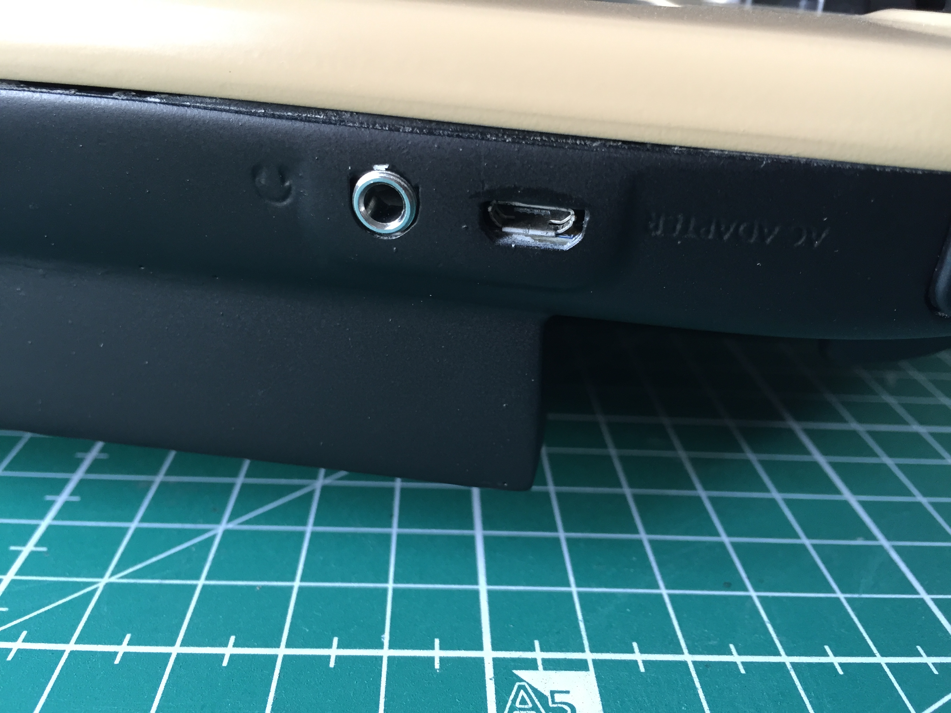

-RAVPower 13000mAh 4,5A Powerbank
-Many Cabels
Color
Front: is Tamyia TS46 Desert Color
Back: Matt Black
I can also use for PC / Display Gamepad :)

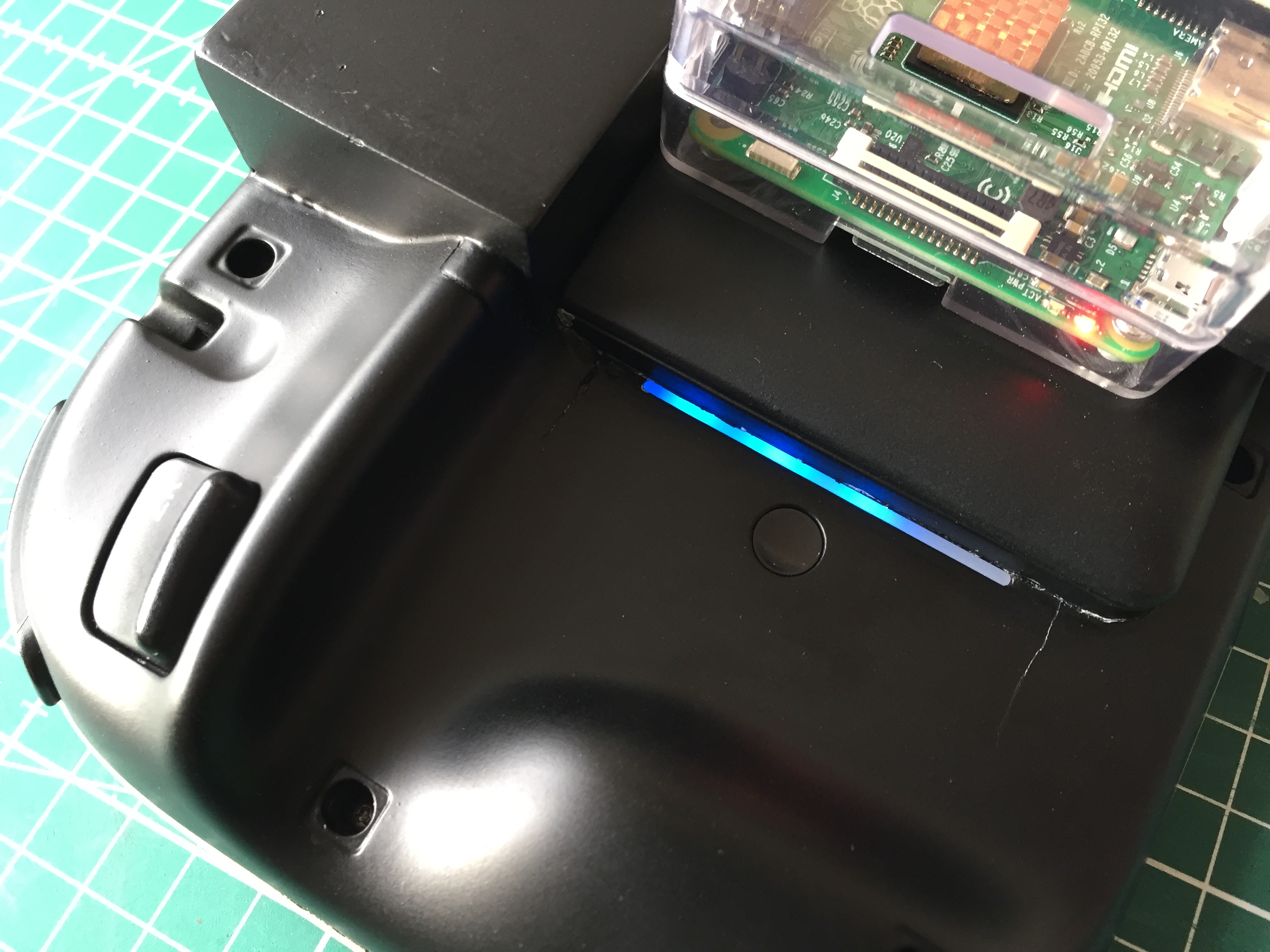

Batterie lifetime is 4 -5 Hours
Many thanks goes to.....
banjokazooie’s for the Teensy Code
and
SpaceAgeWizard from another Forum for the technical overview
best regards from Germany ;)
(sorry for my bad english)

the home button is usable? how to wired to the teensy??
Flippy
Joined: Sun Oct 16, 2016 8:55 am
Re: Wii U Gamepad with Pi3 Finish
Post by Flippy » Mon Aug 14, 2017 6:25 am
reke wrote:
Thu Jul 27, 2017 8:57 pm
Home works, with button D3 on teensy

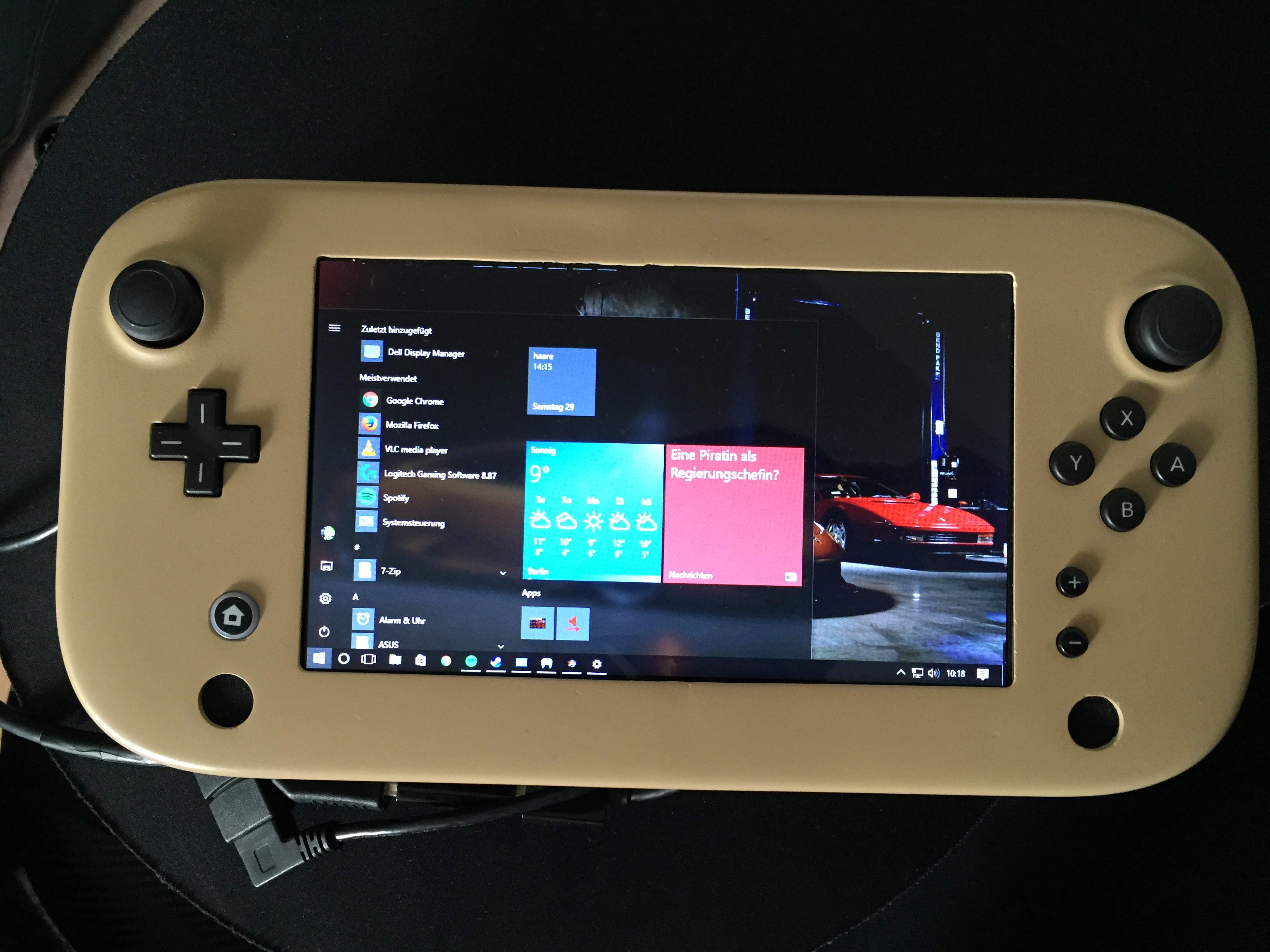

@ Flippy What Kind of screen did you use ? Is it compatible with RP and Windows ?
regards from Germany ;-)
Flippy
Post by Flippy » Tue Jul 17, 2018 6:08 am
xouliox wrote:
Mon May 14, 2018 5:27 pm
Hello
Part List Point 3
-China 7 Inch Screen / 1024x600 with HDMI
I disconect from PI and connect on the PC with female HDMI adapter

What version of windows is that?^?
I liked the idea of cutting the case in half to fit the 7" lcd! sool cool!
