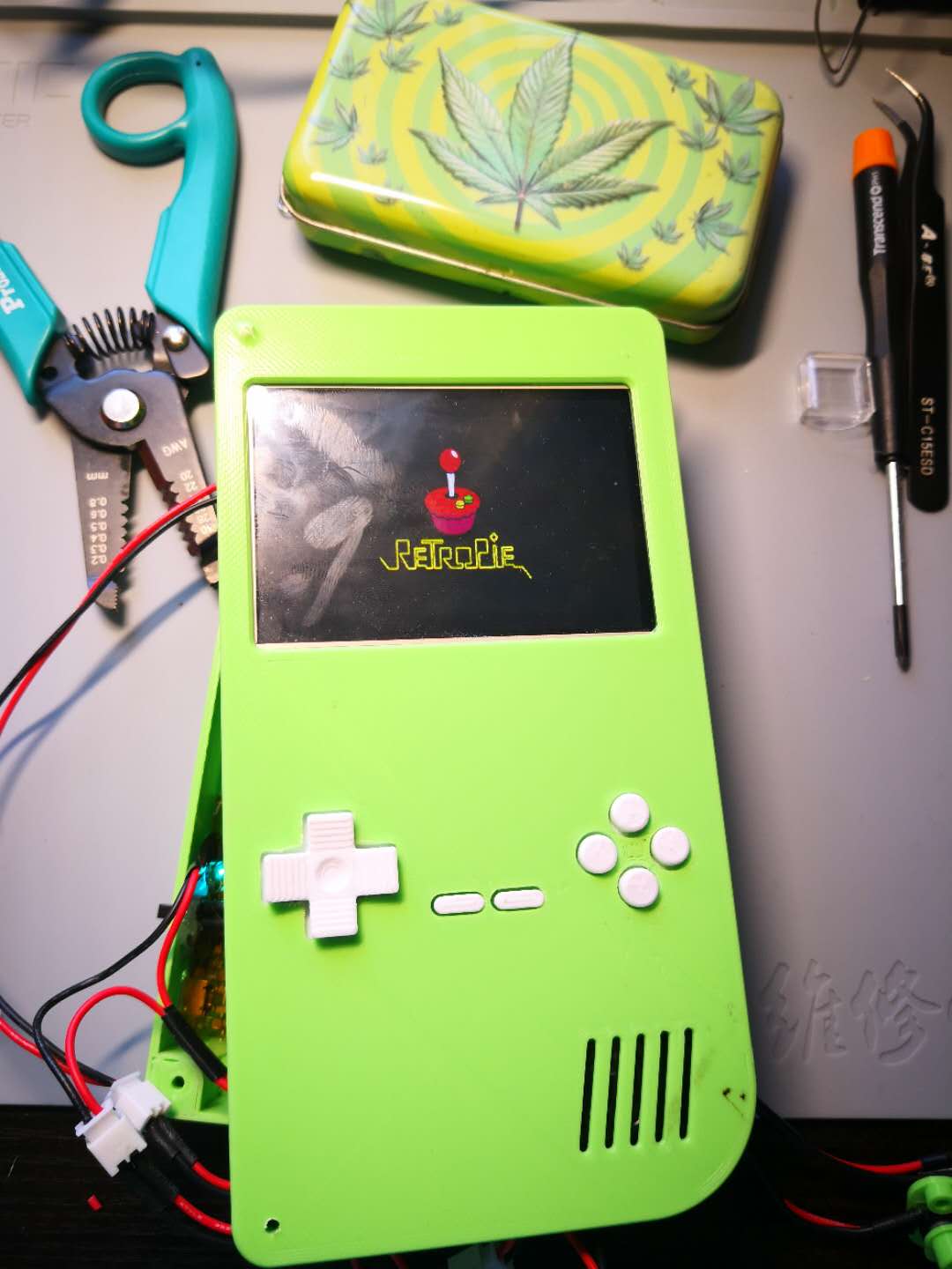

Hi Guys,
I’m new to modding,here is my attempt on retro handheld gaming console.

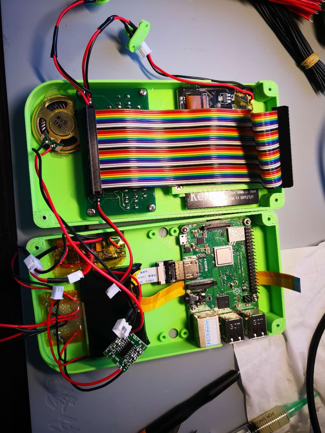

I'm using a Adafruit Pigrrl gamepad PCB, Banggood 5v psu, a kedei screen and a pi3b plus.
I'm still having trouble on the button pcb, the button seems not working on the pi3.

regarding the buttons, did you configure Retrogame on your Retropie image?
https://sudomod.com/forum/viewtopic.php?t=57
also do the handheld work properly with that psu, HDMI screen and a pi3b+? that setup would require a lot of power ?

Sadly,the power supply seems that not have enough power, it get pretty hot when running,later I’ll try replace that with more powerful one(or replace the pi3 with a pi zero).
As for the button, yes i installed the Adafruit-Retrogame pigrrl 2.0 option, I'll give the post method a try. Thank you.

Welcome and thanks for sharing. :) You should check out Helder's Retro PSU - it should be able to power all that no problem: https://sudomod.com/forum/viewtopic.php?f=38&t=6421
