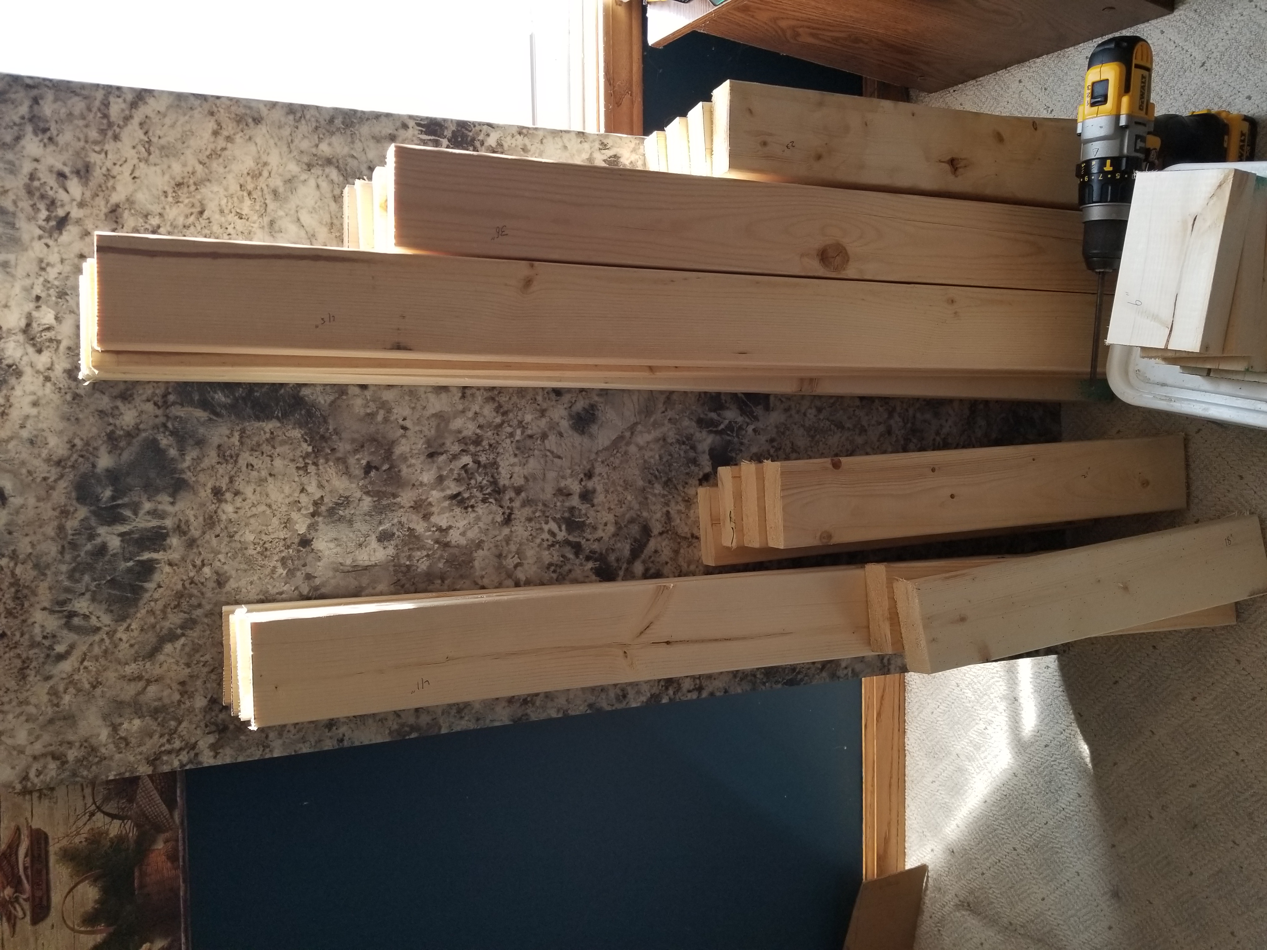

Anyway. I turned this:

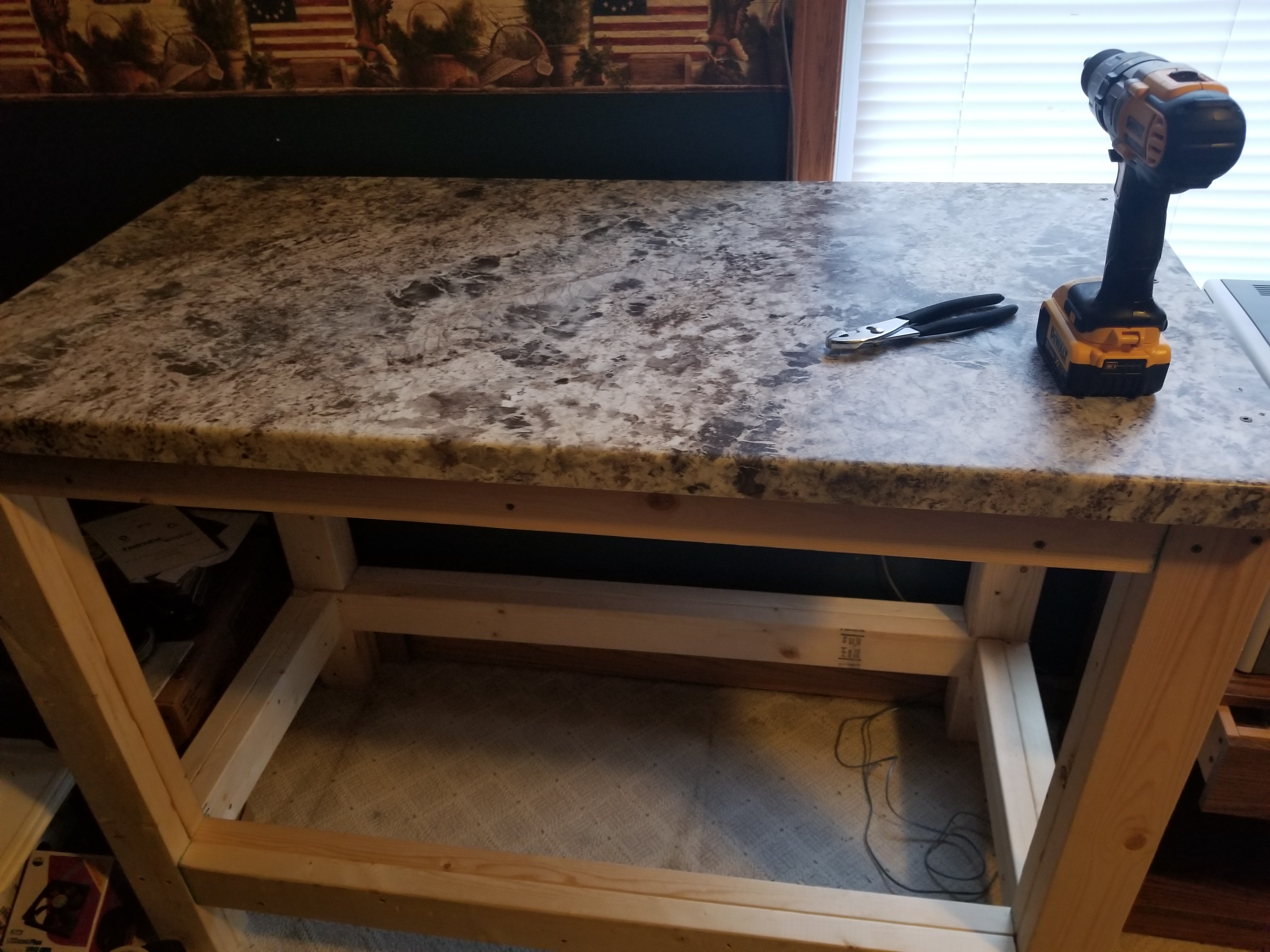

Into this:
I cut the plywood for the bottom shelf wrong and have to get another one, but there you have it.

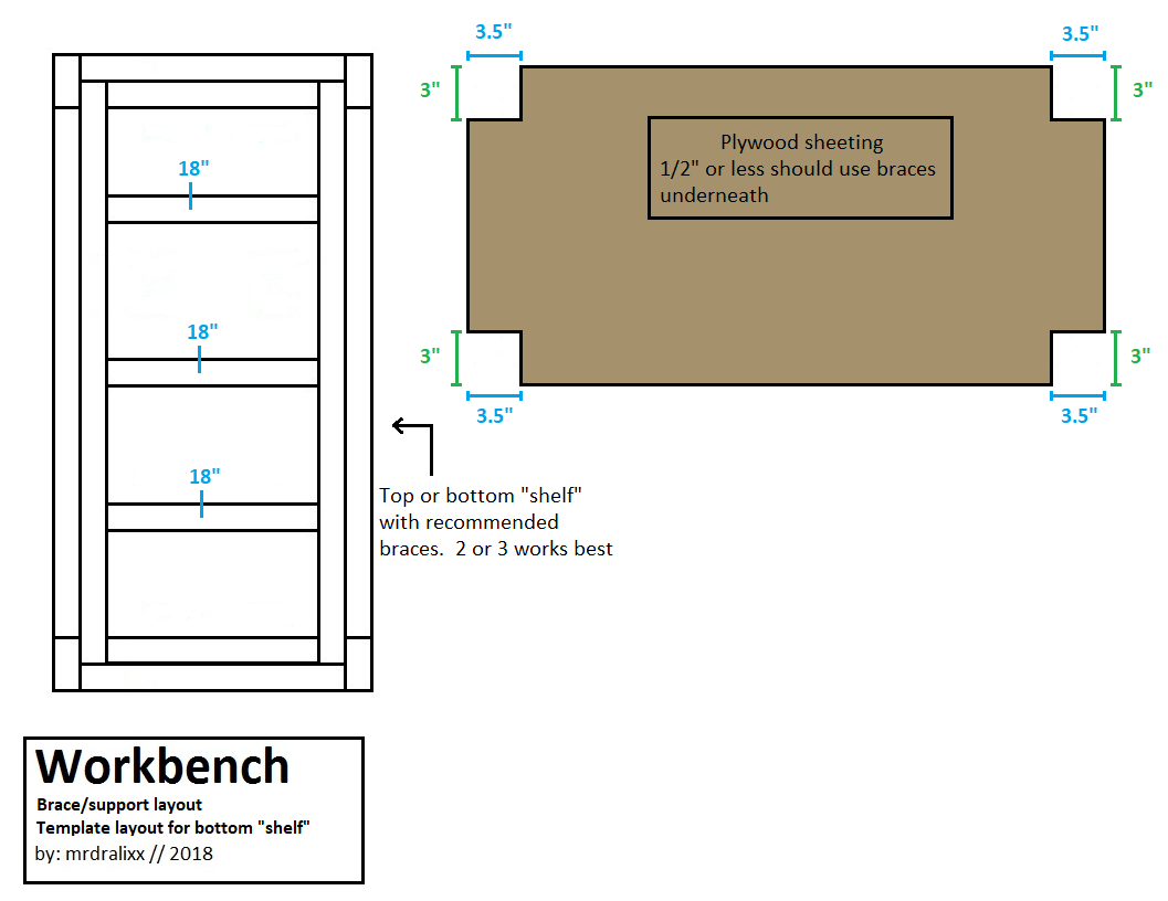

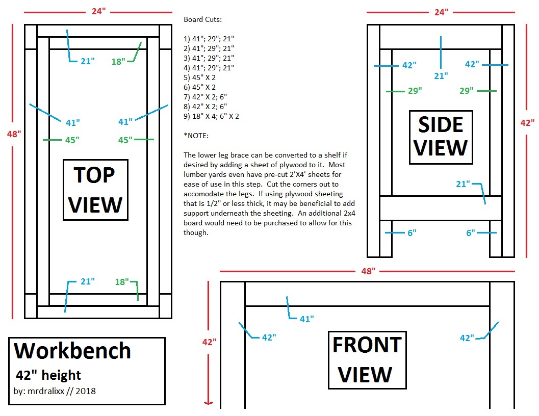

Here's the sketches. Any questions, feel free to ask:
