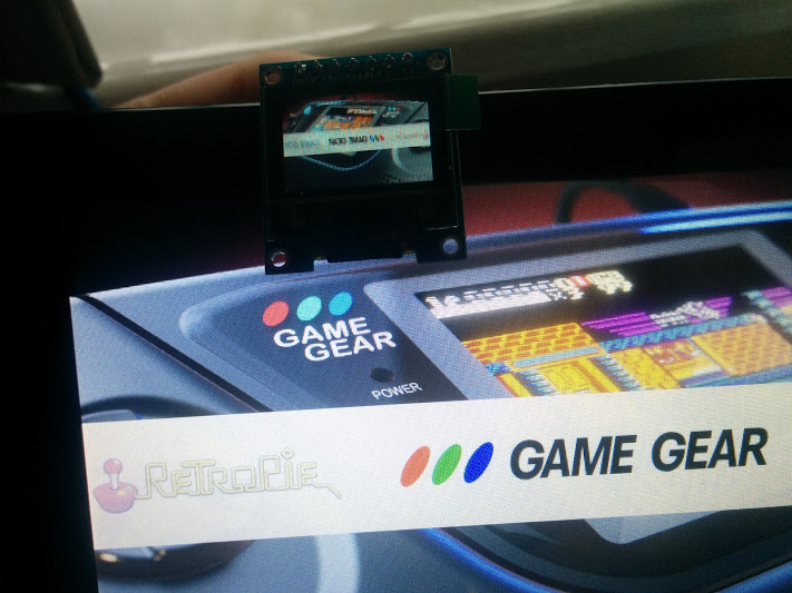

so i was having a little play with my super accurate power meter
the highest i could get it to go, was while just being sat in the retropie menu. a quick sonic speed trial actually dropped it to 0.15-0.17ma so we could easily cope with a tiny drone battery
maybe 400mah to get 2 hours
as a sideline, i have already been playing with some other ideas to go even smaller still!!! pushing the boundaries a little with this screen!!
maybe 96x64 is no good for gaming!

i used the good old fbtft. need to play with the speed, you get flickery 'brighter' linesabrugsch wrote:No but 128x128 is workable... Especially with pico-8 running natively at that res![]()
How did you set the iled screen up by the way?
sudo modprobe fbtft_device custom name=fb_ssd1331 gpios=reset:25,dc:24 speed=16000000
but can you spot the deliberate mistake?

I can spot a missing image...moosepr wrote:but can you spot the deliberate mistake?
or did you mean the reversed screen in the first tetris pic?
- moosepr
- Posts: 524
- Has thanked: 69 times
- Been thanked: 241 times
Re: My take on a GBz
hmm seems my image didnt upload properly!! I can still see it, but maybe nobody else canabrugsch wrote: I can spot a missing image...
yeah the image is reversed. apparently its down to the initialization command on the screen. Sure adds another layer of difficulty to playing games

now there's an idea!! you can fix it by tweaking the code apparently, but im not sure im happy with the screen.abrugsch wrote:Just reverse your left and right and you'll be fine
