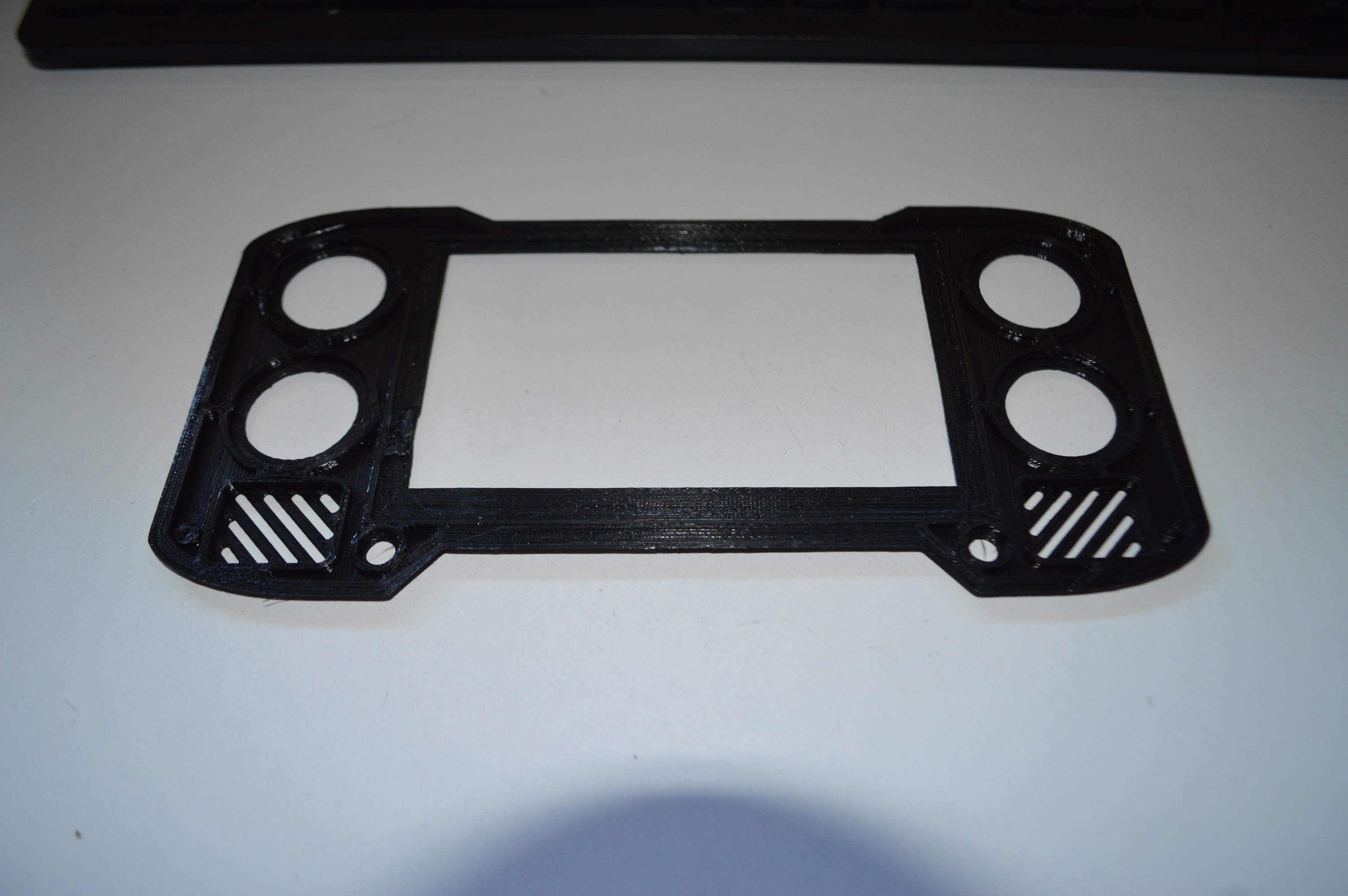

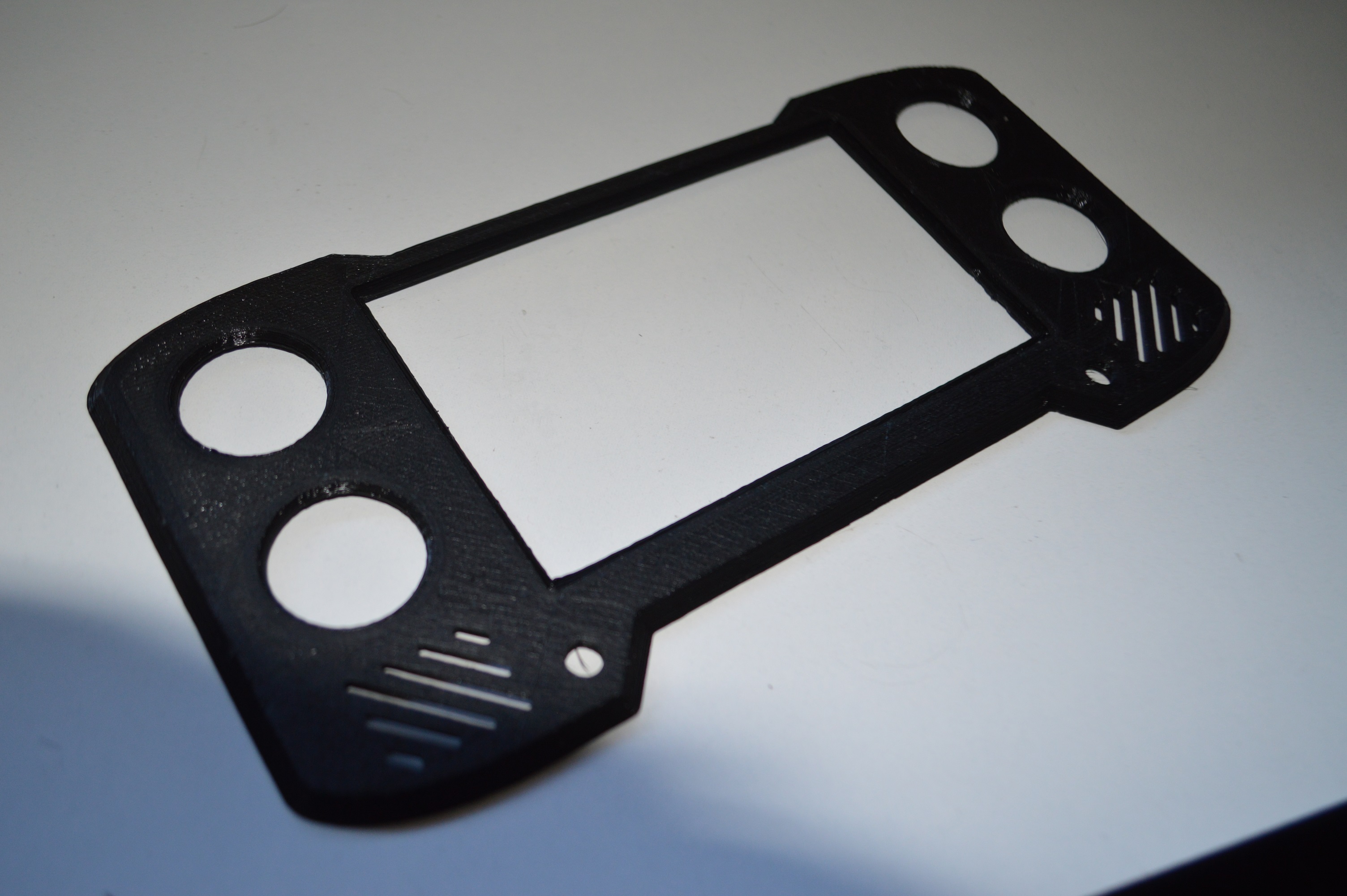

Alright, I got my 3D printer up and running and managed to shoot out a couple trial runs in PLA. I ran into an issue and then promptly broke my hotend nozzle, so I won't be able to update until this weekend. Regardless I was able to test my model and found the sockets I made for my stereo speakers were a touch too small. I reworked them and also reduced the speaker vents.
A few other tweaks and I think the front shell is finalized. The control placement feels good and will feel better with the bulk of the back shell in place.

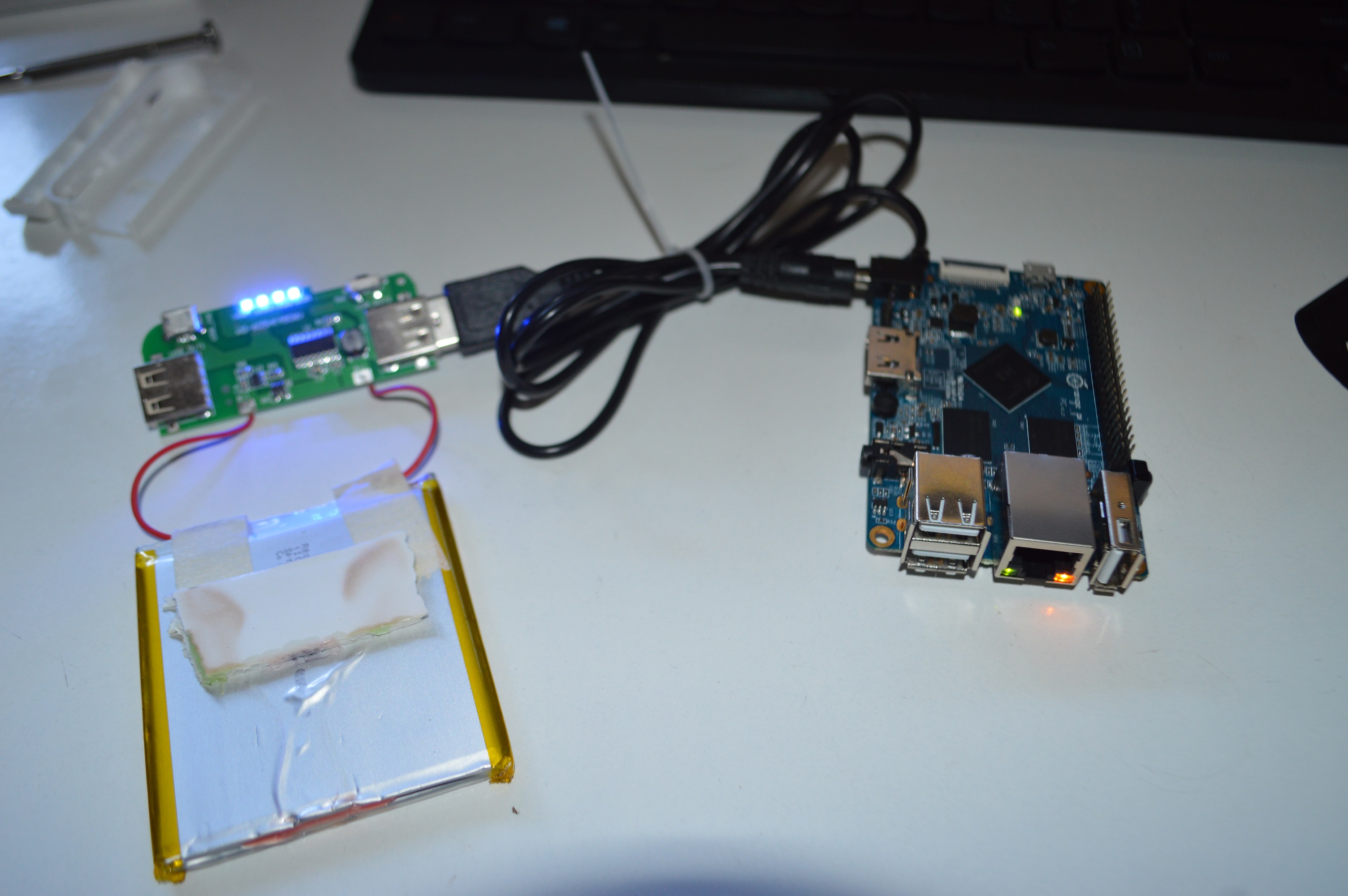

I also butchered a falsely advertised USB charger and managed to get it to run the OPi PC. Capacity is far too low and I think I'll still need to boost it for more demanding emulators but it booted!

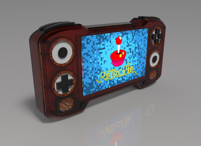

Since I'm waiting on a new hotend for my printer, I decided to pretty up my CAD just for fun.
RetroBro Assembled.jpg (171.57 KiB) Viewed 14772 times
Myoriginal intention was to sculpt this out of wood...
RetroBro Assembled-Wood.jpg (158.74 KiB) Viewed 14772 times
But thinking metallic automotive paint
RetroBro Assembled-Glam.jpg (136.47 KiB) Viewed 14772 times
Or maybe two-tone
And here's a fancy animation, for the lulz.
Still have to tweak the back shell a bit and add ports for headphones, hdmi out, battery charging, USB inputs, and possibly ethernet (if I decide not to desolder it from the OPi PC. Then comes the final screw posts and positioning!

Thanks all! I whipped up a little splash screen for presentation purposes, but I might end up using it to replace the godawful standard Retrorange Pi one. I think I'll want to make my own lineart drawings of consoles in place of the images however.
Printer is up and running, so I should be able to test the component fit and get on with the electronics this week!
