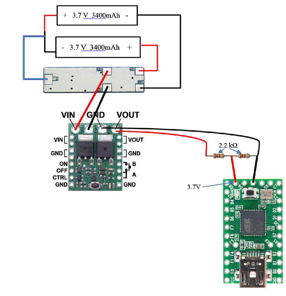

Thank you very much for you response.
Can I read the voltage directly from the step down converter? So I don't had to use a voltage divider. I draw a this for better understanding:

Post by banjokazooie » Tue Feb 27, 2018 4:06 pm
phdirnou wrote:

No you have to read the voltage from battery. From step down you'll get always 5V so no point of doing it. Best place to read the voltage is on the output from the pololu switch - no battery draining when device is off.

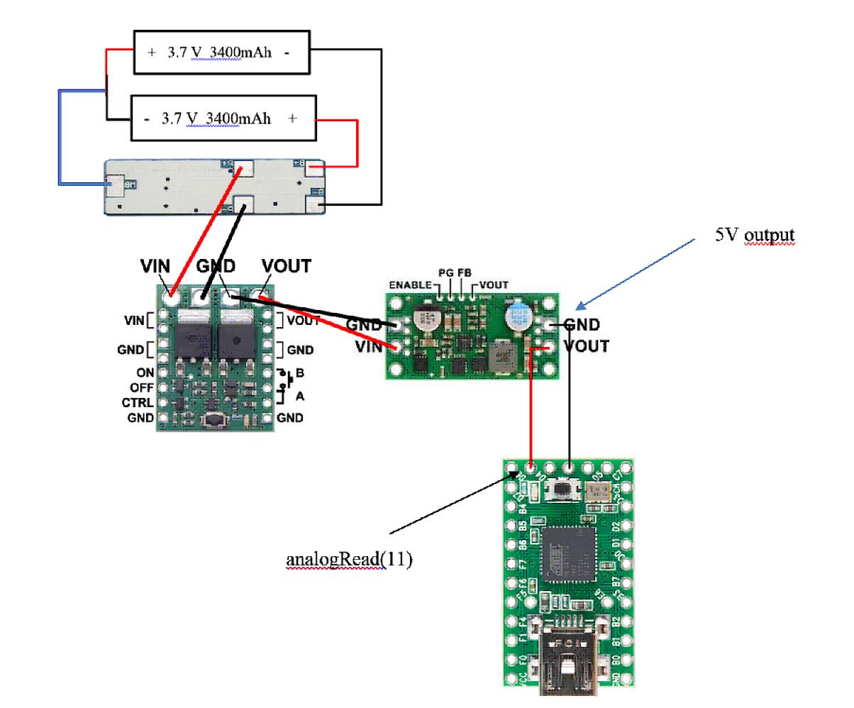

Perfect :)
I made a new drawing:
Picture (Device Independent Bitmap) 1.jpg (84.61 KiB) Viewed 10495 times
What do you think banjoo? Is it possible to build it something more elegant?
Thank you very much

Post by banjokazooie » Thu Mar 01, 2018 6:09 pm
Yep this will work
