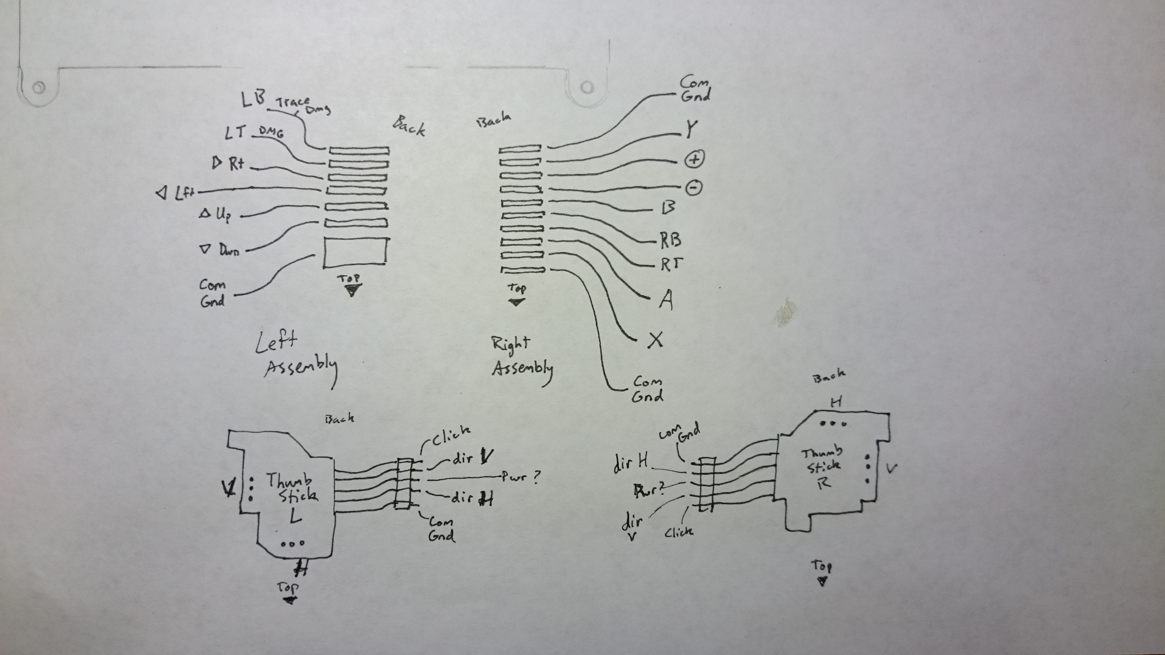

How did you ID the grounds on both button ribbons? I assume the left ribbon ground would be the larger one. But what about the right ribbon?

Post by IrieMars » Wed Oct 26, 2016 4:08 pm
IrieMars wrote:
banjokazooie wrote:
grenade44 wrote:
Picture doesn't work but I removed the img tags and replaced with url tags and it now works.
Thanks for those they will defiantly help when when I build mine.
Do you have the pin layout for up down left right and abxy buttons cable?
You can mix wires as you like all will be read as numbered buttons but GND is important :D
Found an answer to my own question if anyone is interested in the pin-out for the button circuits. It's a little crude but it should be helpful to some.
http://i.imgur.com/NbWz1H9.jpg
