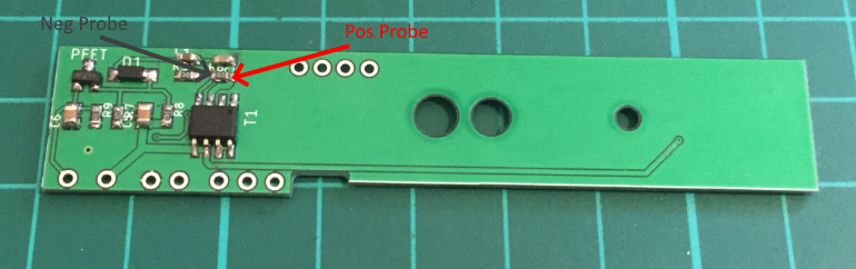

I'm really hoping you/someone can help me with this:
I'm on the verge of closing up my wii u gamepad; so close to it being finished. I've been testing as I go and things have been going well, until now. I had some Wii U button boards made from Oshpark and somehow managed to get all the components soldered on with shaky hands. I press POWER and nothing happens. I started to meter the resistors (with continuity not ohms, probably important for this next part) and when I hit R6 (negative probe on left side, positive on right) it turned on! I know measuring with continuity applies a very small amount of voltage, so I'm assuming I bypassed something and thats why it worked. Oddly enough, if I hold down the power button once its on it turns off properly after a few seconds (haven't setup safe shutdown with the tv button yet obviously). So shouldn't that mean my connections are good on the board? I reversed the diode thinking that could be the problem and then it stopped shutting off. I put the diode back and its shutting off again but still not turning on.
I'm hoping with this information someone can help me identify what I'm doing wrong or what component is bad/malfunctioning on my board.

can you provide clear images/photo of what you have done.....
also can you clearly outline where you have everything connected to (and to what its connected... Powerboost, RPi)
(also please confirm/clarify what you have added to your config.txt)
as most of these component, you are buying a reasonable quantity you shouldn't really have any issue with bad components
even thou it can happen (very rarely), its fairly straight forward to swap out, you should have 3 boards if you bought them from Oshpark

He had the mosfet on backwards like you did at first, it solved his problem. I also uploaded my version of the board on OSHPark it's exactly the same as the one you uploaded but the silk screen is easier to read and will avoid any more confusion on which way is which for the dualfet.
I also changed the dualfet to the 4562 one which is more stable on lower voltages from the battery so try to use that one in the future.
https://oshpark.com/shared_projects/JgtcBIyb

Helder wrote: ↑Sun Apr 07, 2019 5:05 pmHe had the mosfet on backwards like you did at first, it solved his problem. I also uploaded my version of the board on OSHPark it's exactly the same as the one you uploaded but the silk screen is easier to read and will avoid any more confusion on which way is which for the dualfet.
Thanks....
I did put a dot in the place (on the board) where the dot/mark on mosfet is...
(Maybe I should have explained that better)
There was one other addition that I made to the board before posting it on Oshpark...
https://oshpark.com/shared_projects/Bxg2oYRw
Which was to change the solder points for the wiring...
On the first one (which I used in my build)...
The copper was only really exposed on one side rather than both....
(and not on the side that most will be applying solder to)
It’s not a major thing, as you can just flow the solder through, but some may end up butchering things or find it difficult to solder....

IMHO the files were OK as they were (but I'm a NOOB, so what do I know
I could have explained it better....
(but I feel i did a pretty decent job of trying to cover all the bases in my initial post)
boards (and there a dot/mark there, so people don't make the mistake i made)
also showed where everything should go
and even showed a completed board (just for reference)
but it is what it is.....
(like me a lot of people are NOOB at this, and its easy to make a silly mistake... especially when you don't know what your doing)

For me it wasn't the board that confused me with the Dual FET it was the the Dual FET itself. The one's I bought had no orientation indicator. When Helder suggested I had it backwards I pulled the data sheet and saw on one side there was 2 sets of identical pins. Once I saw that I was able to measure continuity between pins to determine which side was which.
