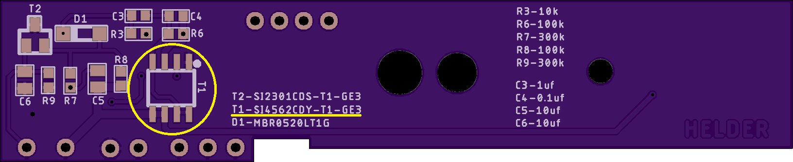

It looks like the Dual Fet part linked is no longer available. I also tried searching for the 4562 version Helder recommended. Not sure if I need to buy one with that exact model#. Any ideas on where I can get one, or anybody willing to sell me a spare?VeteranGamer wrote: ↑Fri Feb 22, 2019 2:21 pm
Parts required are:
Dual Fet is : SI4532CDY-T1-GE3
P-Channel Fet: SI2301CDS-T1-GE3
D1: MBR0520LT1G
Can someone tell me if the link's MOSFET is compatible with T1? https://es.aliexpress.com/item/33057594 ... c64e60[img][/img]

llonden wrote: ↑Mon Jul 08, 2019 1:22 pmIt looks like the Dual Fet part linked is no longer available. I also tried searching for the 4562 version Helder recommended. Not sure if I need to buy one with that exact model#. Any ideas on where I can get one, or anybody willing to sell me a spare?VeteranGamer wrote: ↑Fri Feb 22, 2019 2:21 pm
Parts required are:
D1: MBR0520LT1G
Ema908 wrote: ↑Mon Jul 08, 2019 1:26 pmCan someone tell me if the link's MOSFET is compatible with T1? https://es.aliexpress.com/item/33057594 ... c64e60[img][/img]
https://es.aliexpress.com/item/33055381 ... f7db908bbe
https://es.aliexpress.com/item/33042117 ... 4c570dd50f
its still about....
i'm sure if you search you'll be able to get the correct ones....
if people are that stuck....
I think I have a few knocking around, I just have to find them
(but i'd suggest searching online first as they are out there, as postage alone is gonna be around £3.50/$5 from the UK)
