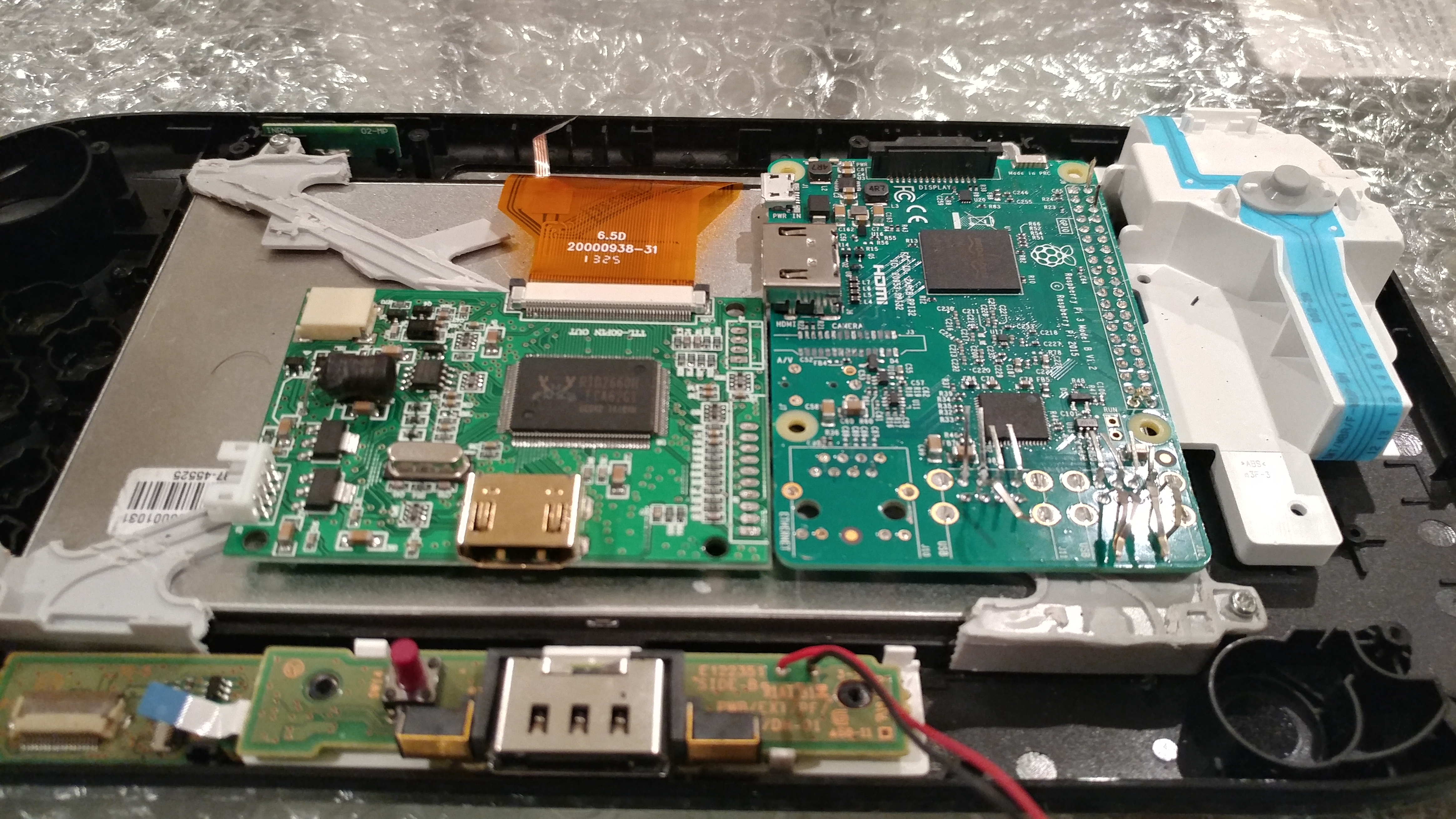

Heavily modified Pi3. Removed everything I could. Left the display pin out alone as it is pretty close to the SD mount and I didn't want to risk damaging that. Removing these parts wasn't easy, clean, or pretty. The solder iron I have wouldn't heat up the solder on the Pi3 high enough to the melting point. So I had to basically get a pair of pliers and destroy them the parts as delicately as I could.

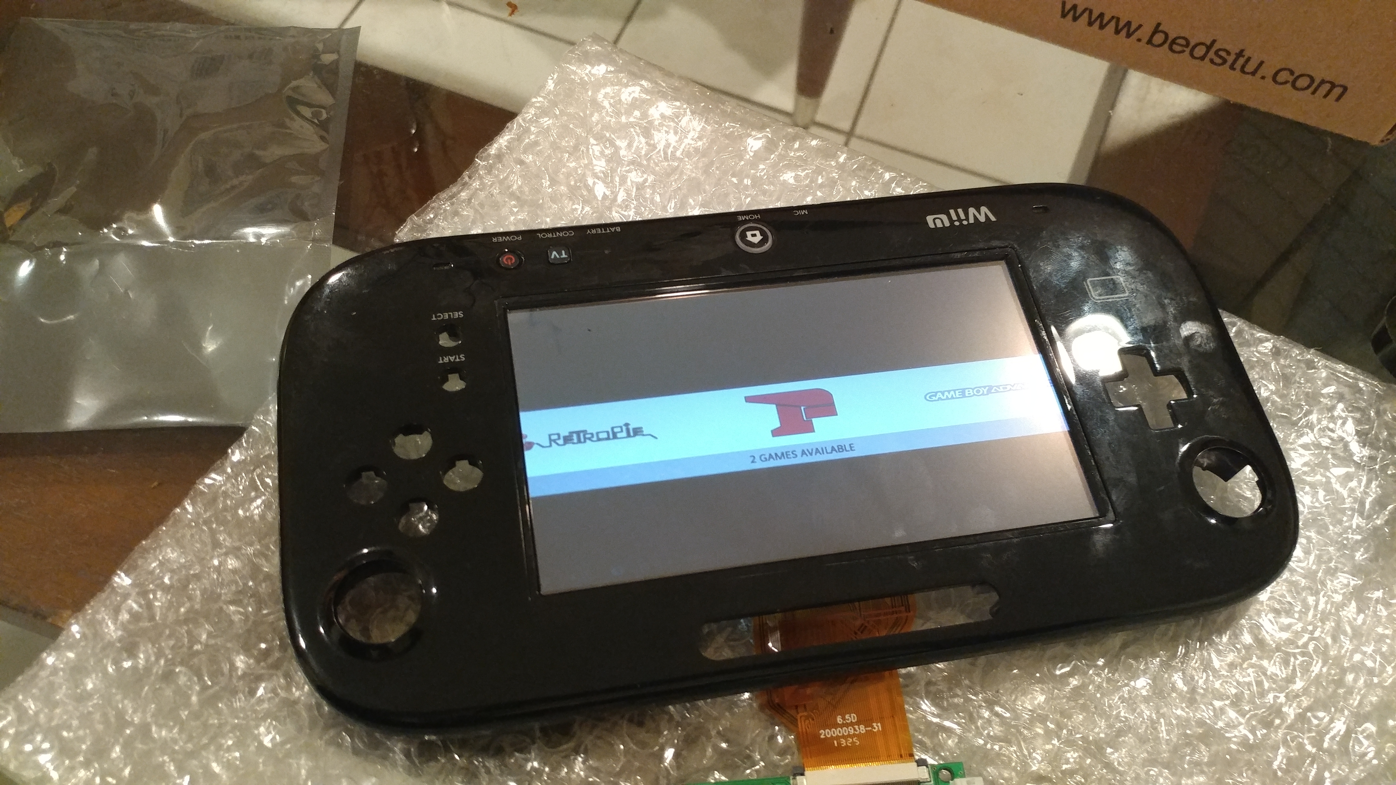

This is big for me. I was loosing my $hit trying to figure out why my LCD screen wouldn't stay on. Turns out the HDMI cable I was sent just wasn't working. So I swapped it out with one I knew worked and eureka! The screen is currently inverted because I used this Pi with the 7" Pi LCD screen, which required the screen to be flipped. Its a simply script change to swap it back. But it's coming along now. I'm pretty stoked.

Pi, charge boost, and LCD board all wired up. Look good but I can't figure out how to keep the screen on. It keeps going black even though I know I have power to it. Might be as simple as hitting the on button on the control that came with it. I'll need to pick up a battery today and test. If this doesn't work I will have to figure something out.

Here are the two boards in the case where I think they will sit. I'll have to go back and strip down both the Pi and the LCD board some more to make extra room. I'll do this once I figure out how to keep the screen on, just in case I have to return it.
Even though I have more room to make, it fits the case. I plan on going back and completely grinding down everything not needed on the Wii U gamepad to make more room. I still have the Teensy, sound card, battery protection, control boards, etc to go. So I'll be needing all the space I can get.
