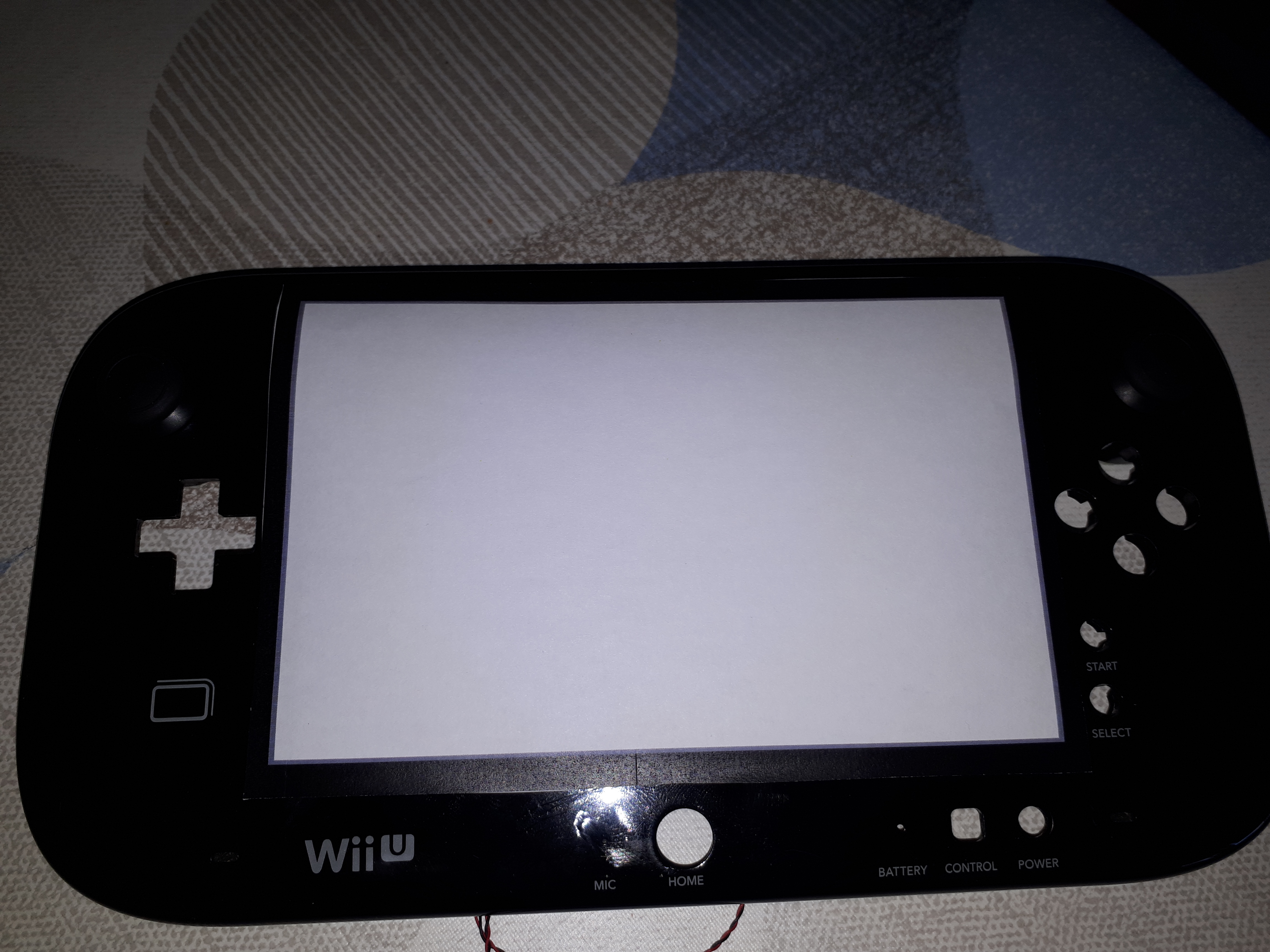

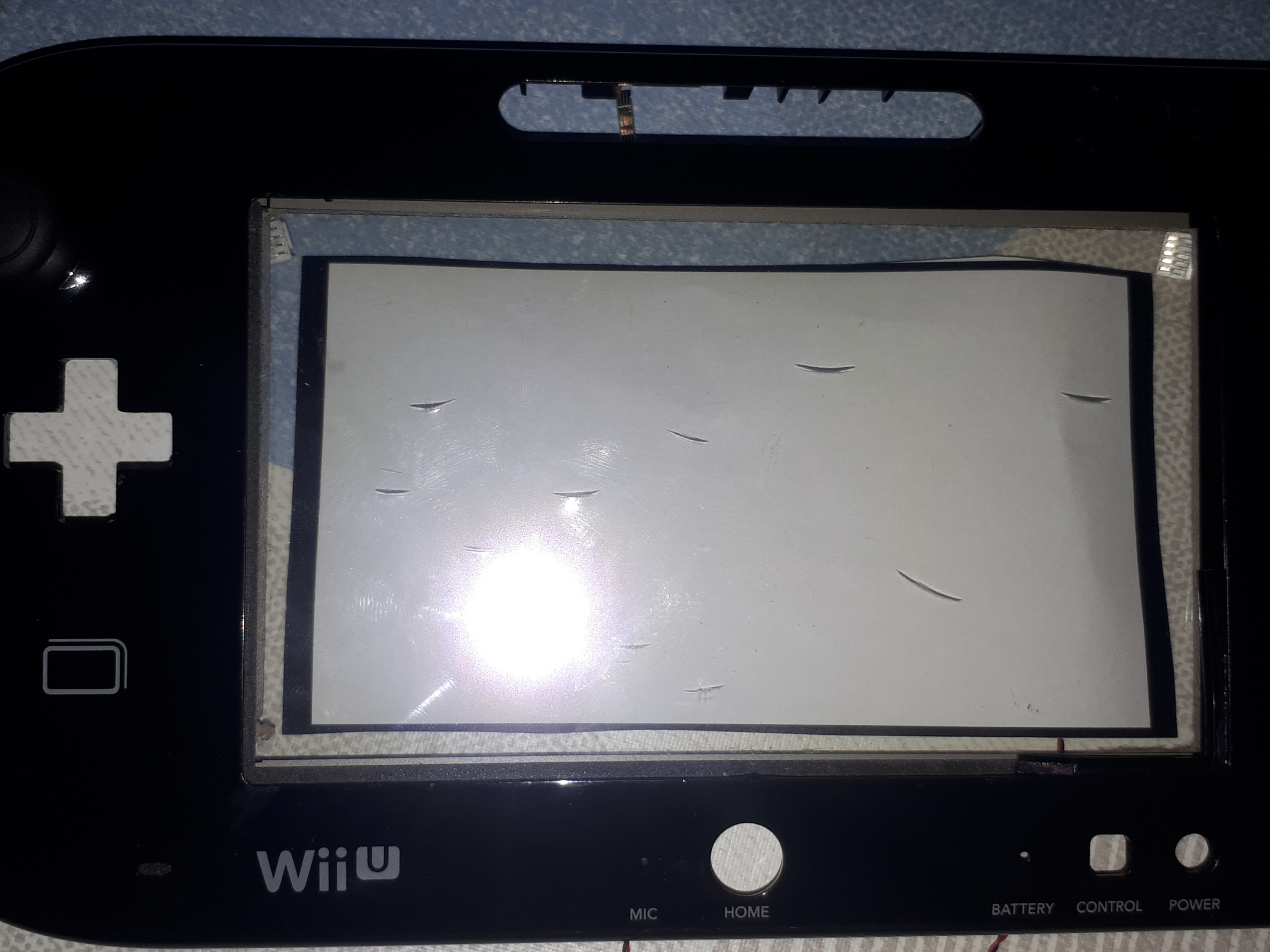

Post by xouliox » Sat Jun 02, 2018 4:03 am
With the 5.9 1080p screen and the standard digitizer there is a lot of space between display and gamepad frame so i need a wider bezel or something.
Any ideas how to handle this ?

Post by banjokazooie » Sat Jun 02, 2018 5:04 am
I have used the original bezel from wii u touch screen
https://www.ebay.com/itm/Original-Ninte ... SwCmZZUw5-
and printed frame with small lip around lcd
