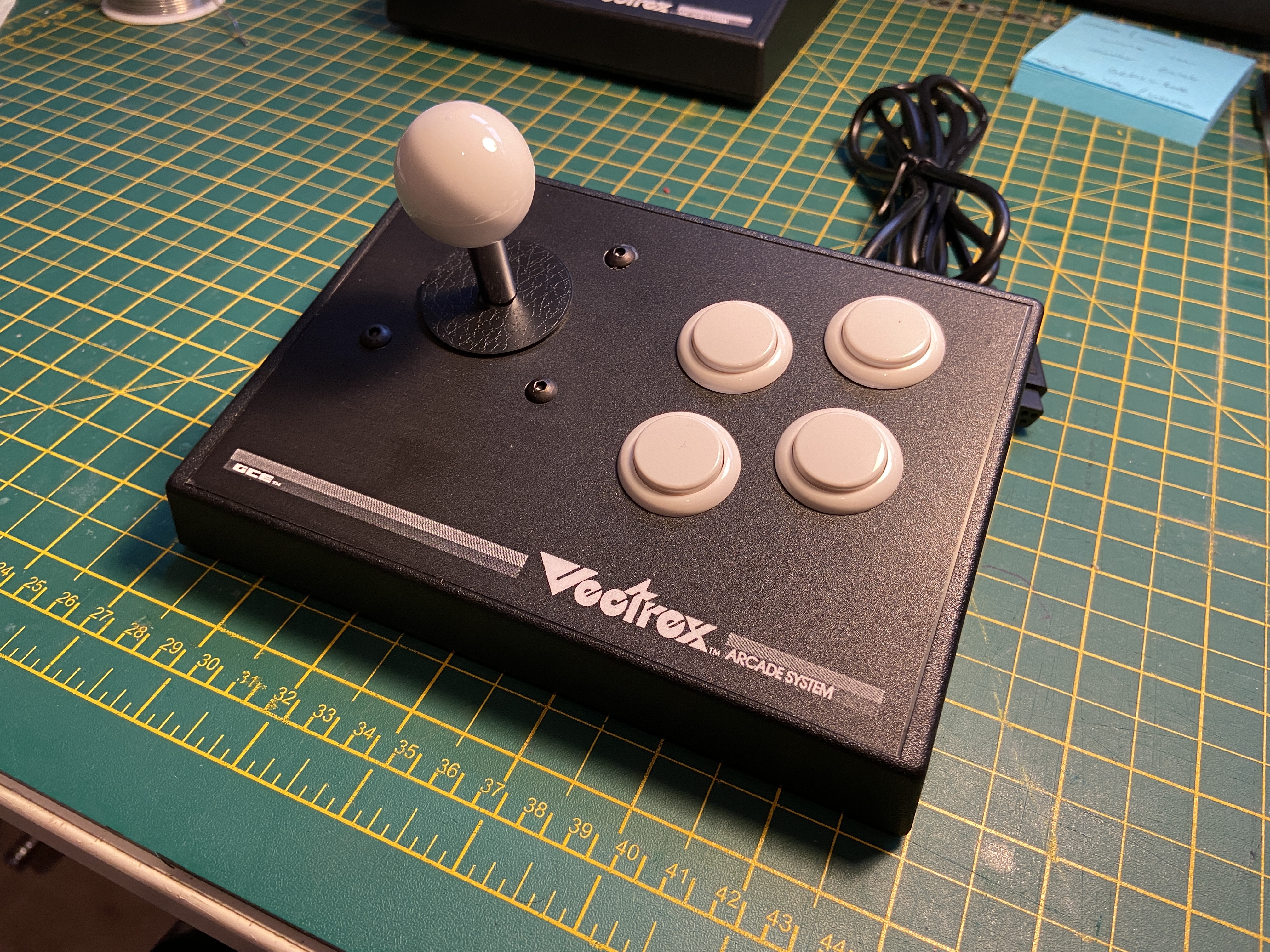

Seeing as the origibnal Vectrex controllers are analog and there's only 2 original analog games - I thought we needed a decent digital arcade style stick for the vectrex.
I use these boxes on nearly all of the sticks I make and vary the overlays,buttons,balltops.
Seeing as the boxes are quite 'mini', I turn the joysticks shafts smaller and use 30mm balltops rather thann the standard 35mm ones. I also use OBSF24 Sanwa buttons rather thann the usual OBSF30 buttons (OBSF24 are usually used as 'start' buttons on arcade cabs)

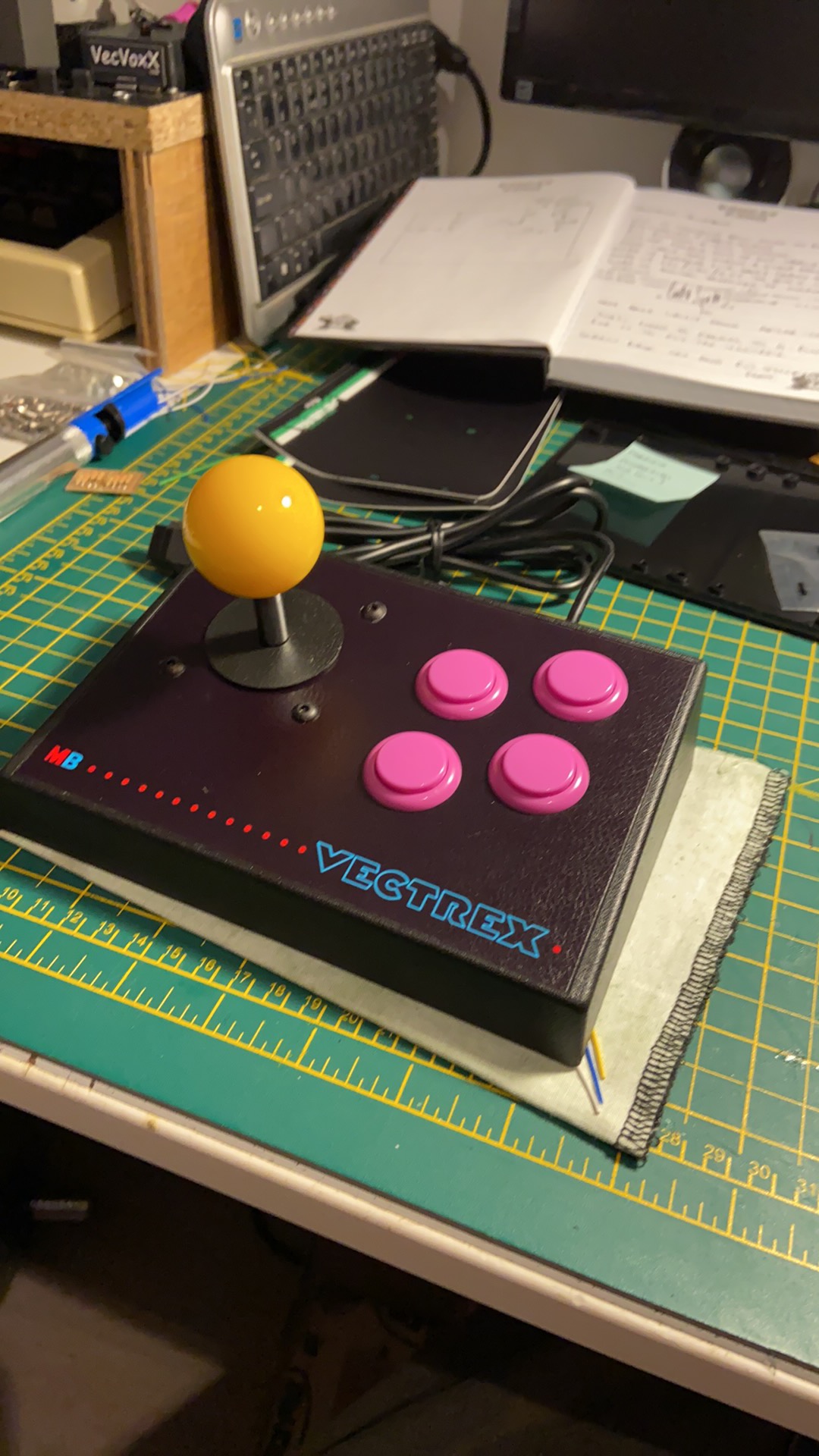

The first prototype

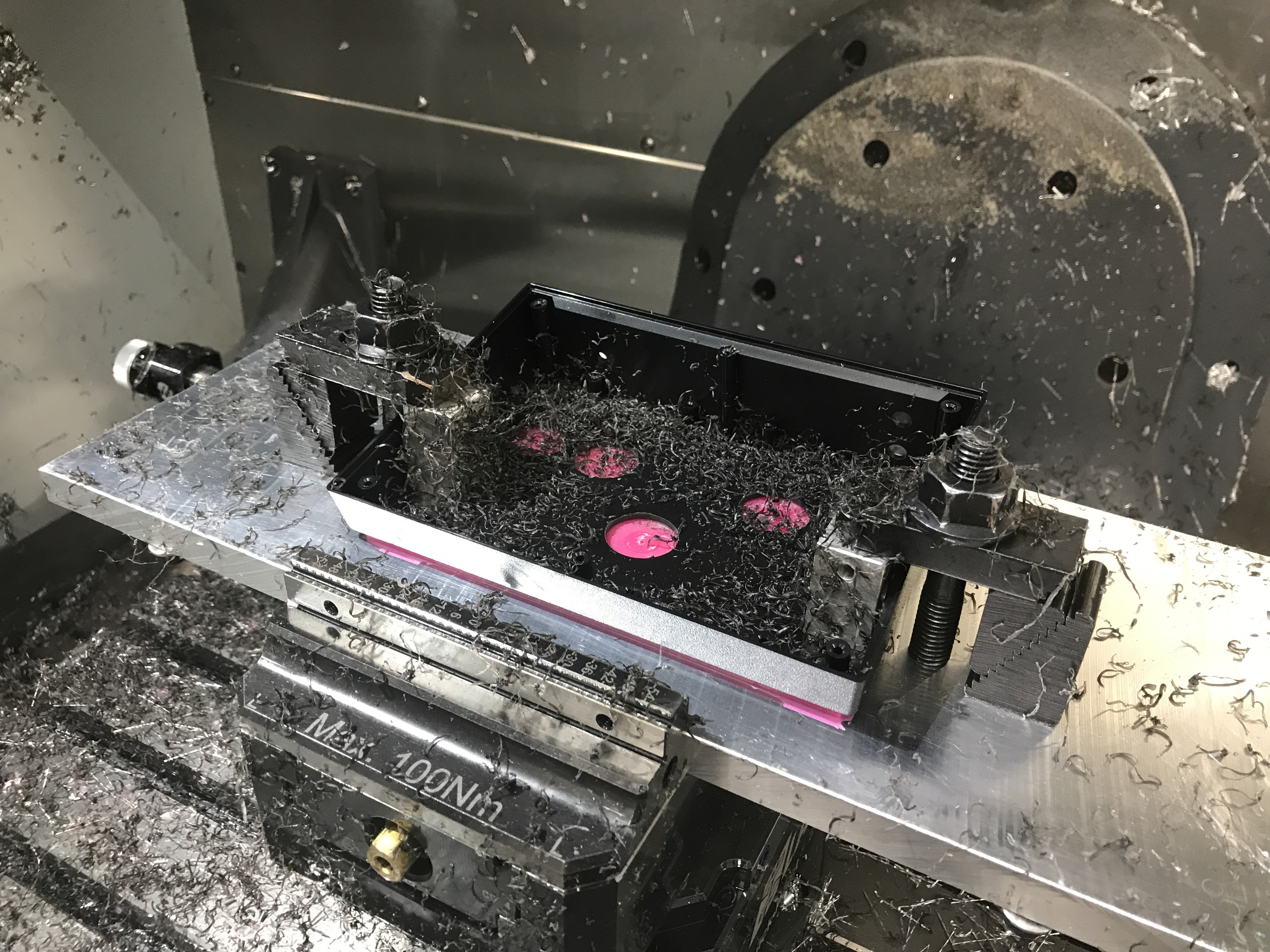

Making a run of them on my work cnc mill
The main 3 types (MB - Europe, GCE - USA, Bandai - Asia)
Some specials -

Post by AdamG » Sat Jan 02, 2021 12:15 pm
What method did you use to apply graphics to the casing? They look pro!
virtvic
Posts: 13
Joined: Tue Dec 29, 2020 5:33 pm
Re: Vectrex Joystick Controllers
Post by virtvic » Wed Jan 13, 2021 4:49 pm
They are a sticky cold laminated textured vinyl. www.arcadeartshop.com can print your designs on the same material.
