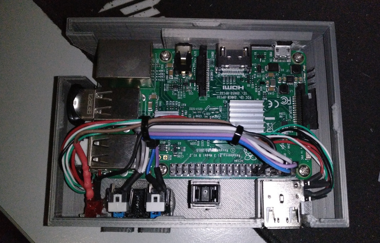

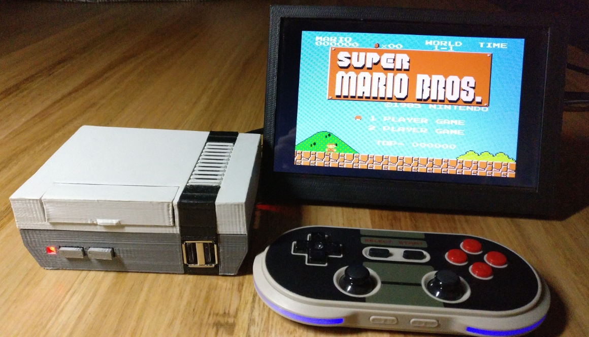

Finally completed my custom 3D printed NES.
Specs:
Raspberry Pi3
Sandisk 128GB microSD - Retropi 4.4 OS
Sandisk 128GB USB - Rom Storage
8dobit NES30 Controller (Bluetooth)

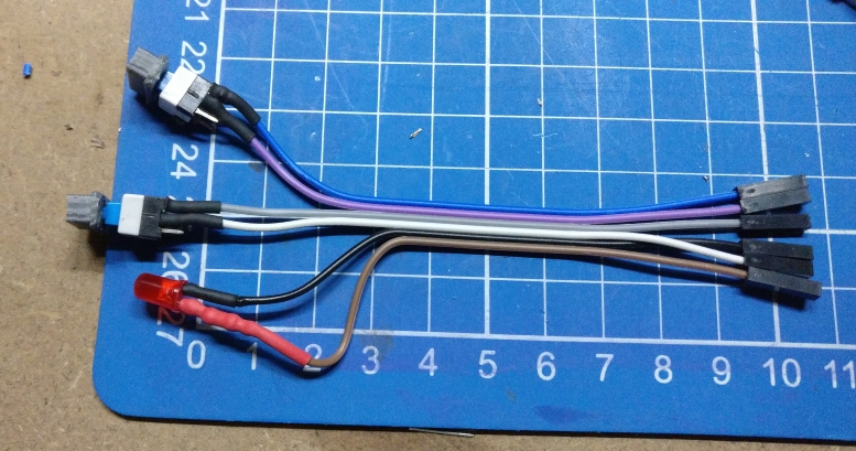

Latching Power and Reset setup for safeshutdown - GPIO Pins
LED to complete the look - Wired to the GPIO Pins with 330ohm resistor
USB ports extended to the front
3D printed shell, top PLA Cool grey and the bottom is ABS for heat.
The cart latch works and you can insert a small NES cart, just for looks.
Was a cool project which I really enjoyed.
I have my rom library split across the MicroSD and USB Flash using symbolic links.

Safe Shutdown scripts if anyone wants to build one, see the zip file.
