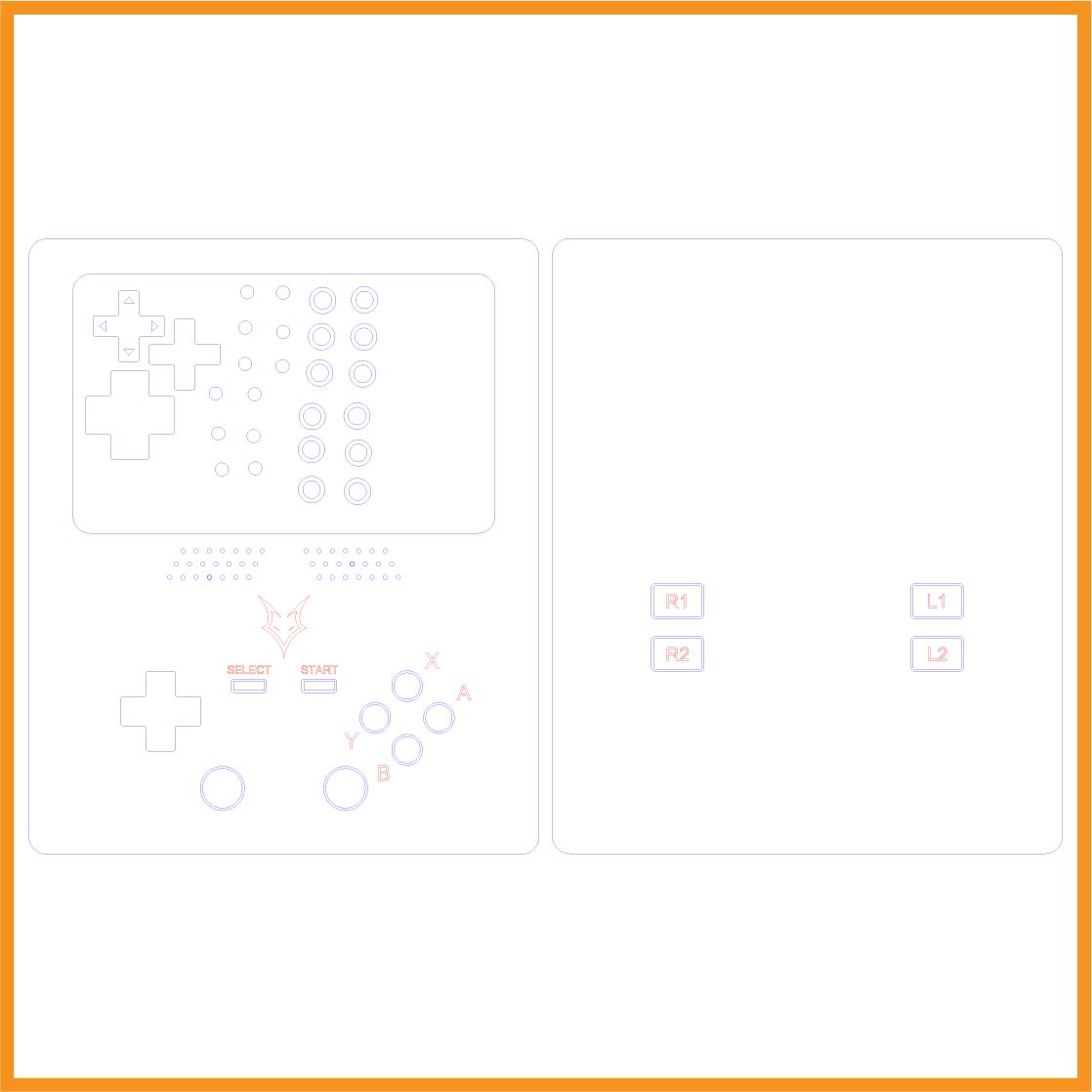

I am going to make the case out of wood and designed it to be laser cut, here is the drawing (hard to see , converted from svg to jpeg),

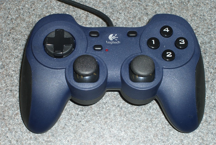

I am going to use an old logitech controller pcb for the controlls, like this one,

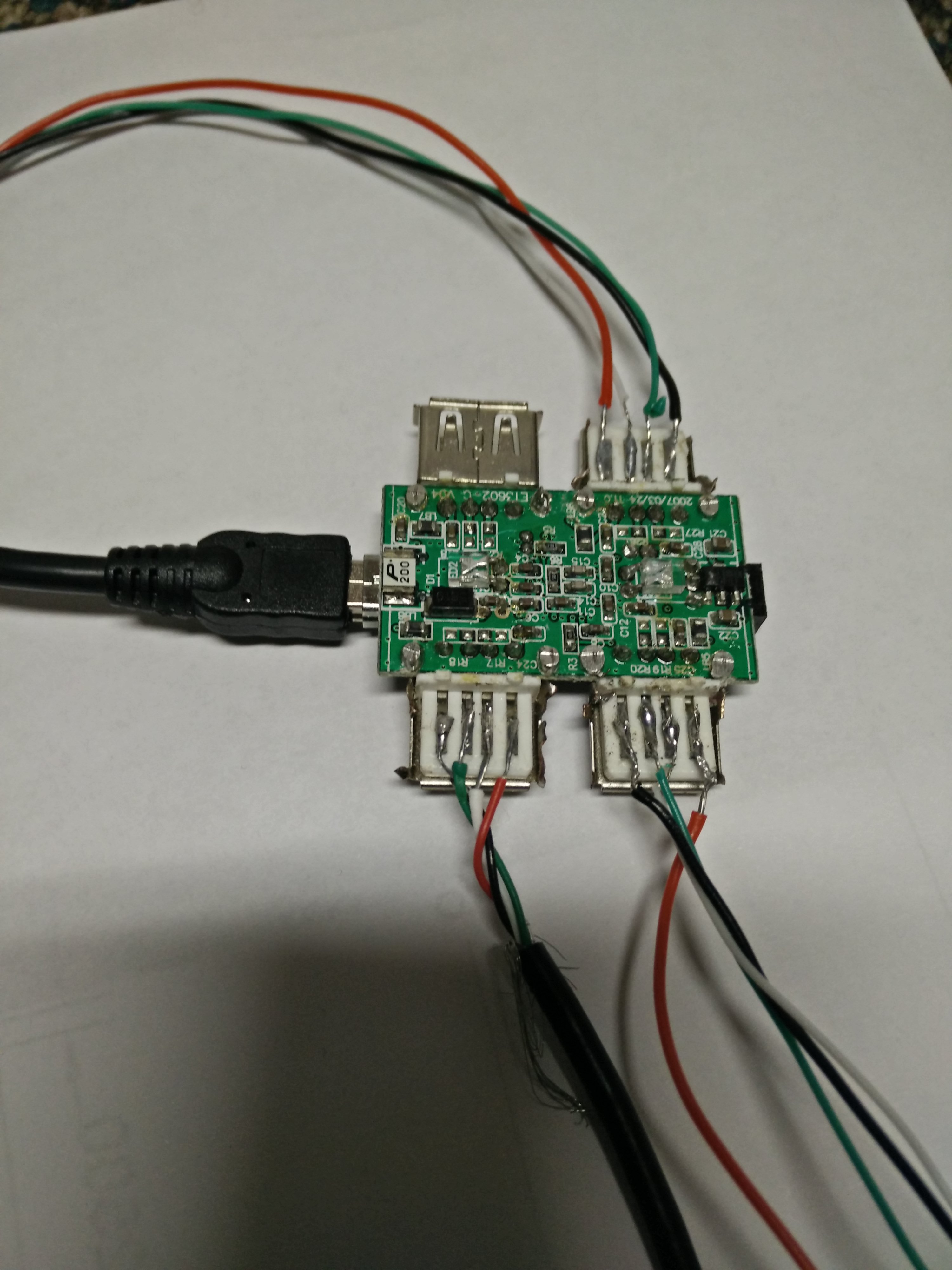

I will be using an OTG cable with the tablet to attach the controller and some USB ports, so I can attach a mouse and keyboard when needed.

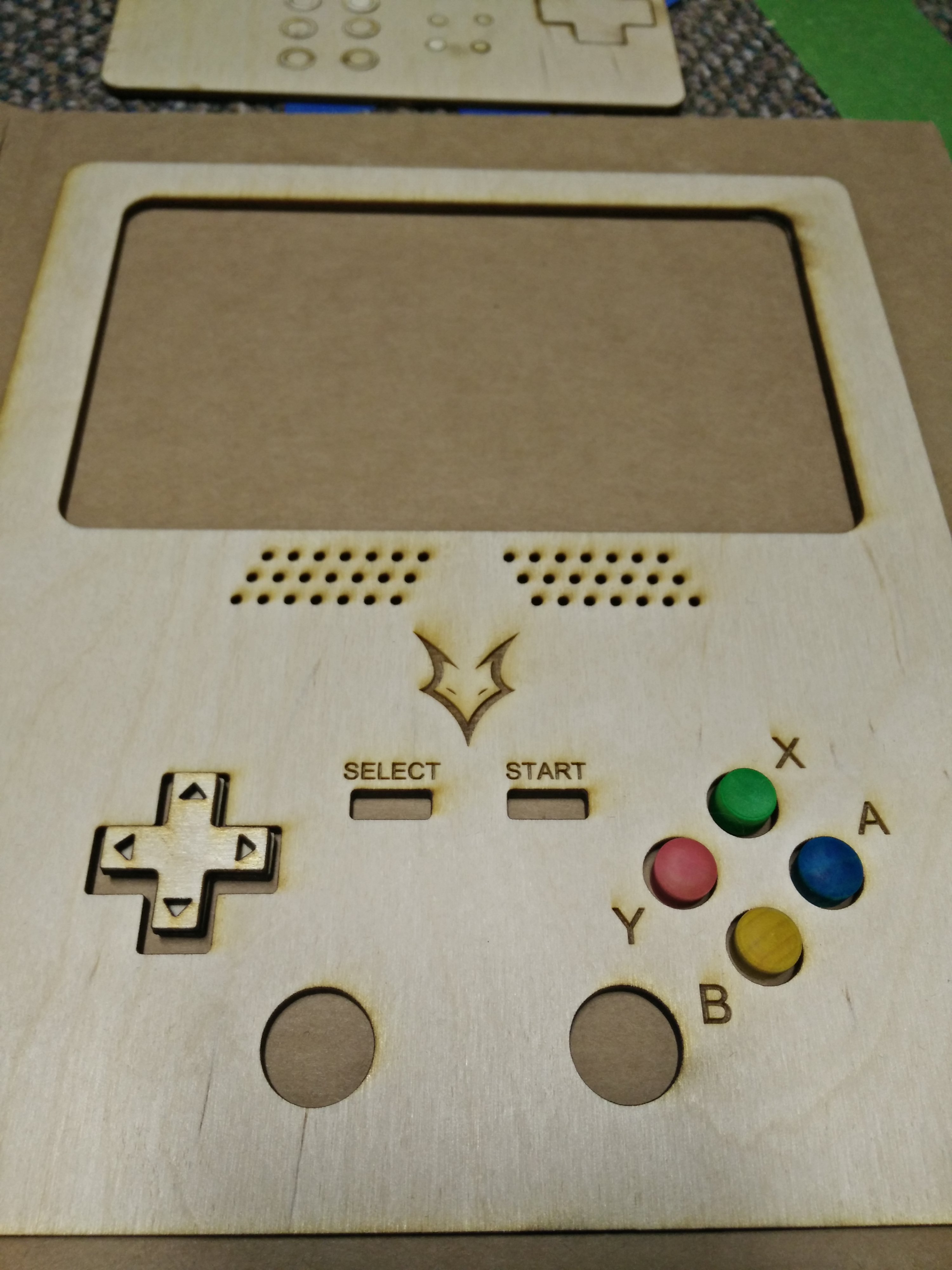

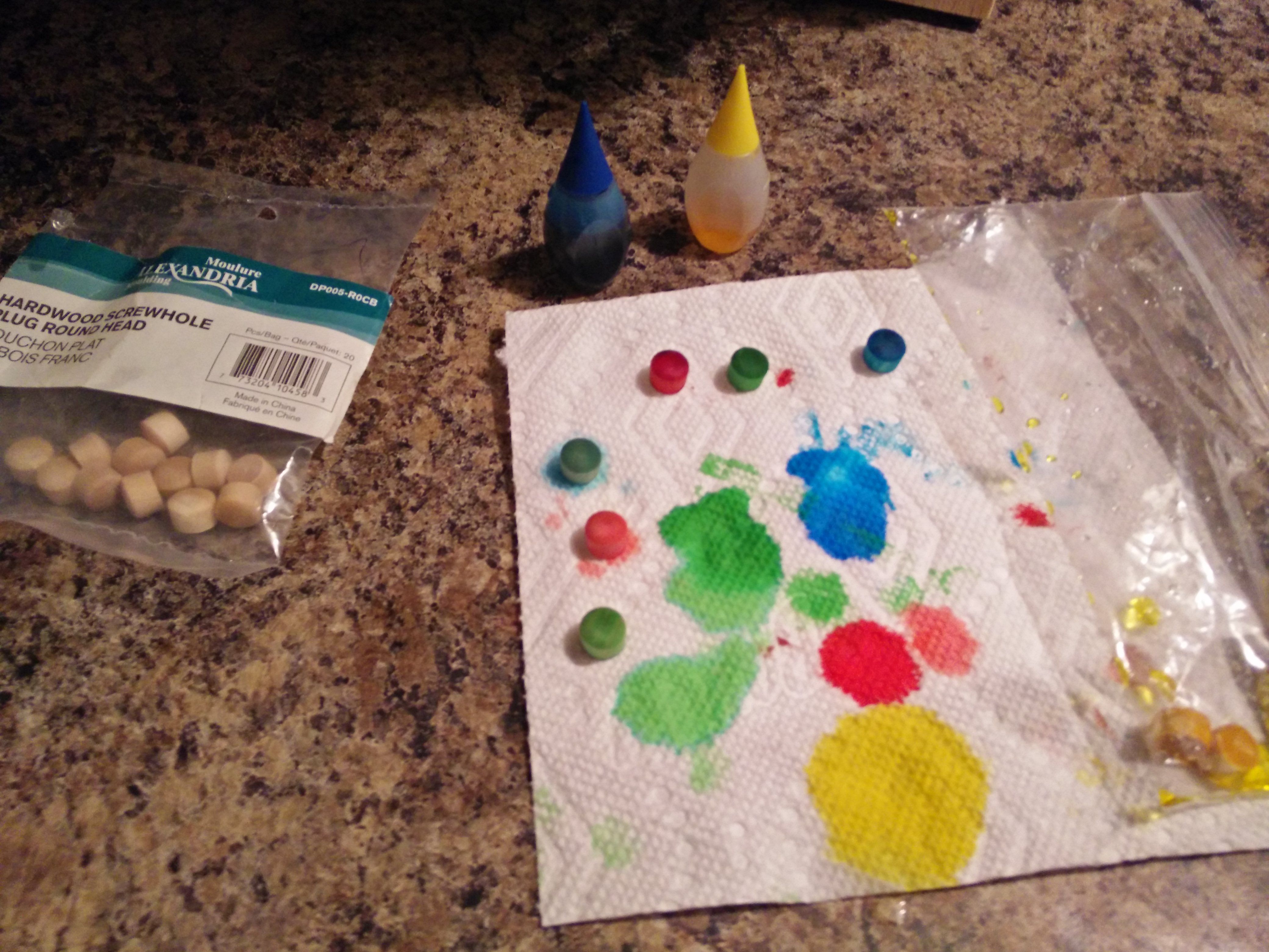

I will also be making all the buttons out wood as well and staining them, hopefully for a really nice look. here is a pic of me staining a couple of the buttons with food colouring,

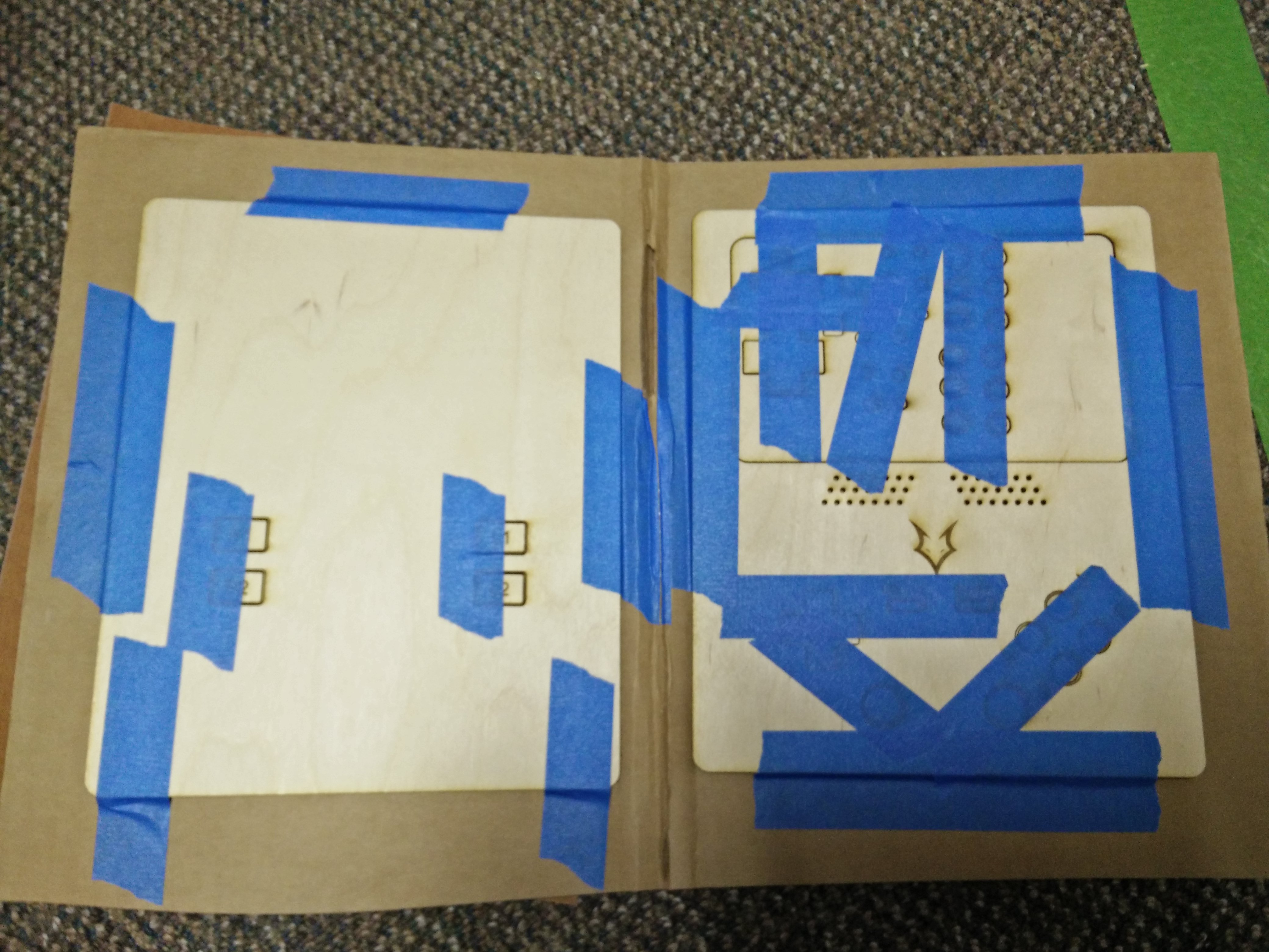

Here is the laser cut wood and a couple other pics,

At first I was skeptical of a wooden case but that looks damn good. I'm super excited to see this finished! Are you planning on disassembling the tablet or just using it in its case?

I do like the laser cut wood look! How do you plan to mount all the "guts"?

you know you can eliminate the scorch marks of the laser by putting masking tape over the cut lines don't you? Otherwise this looks properly amazing! :ugeek:

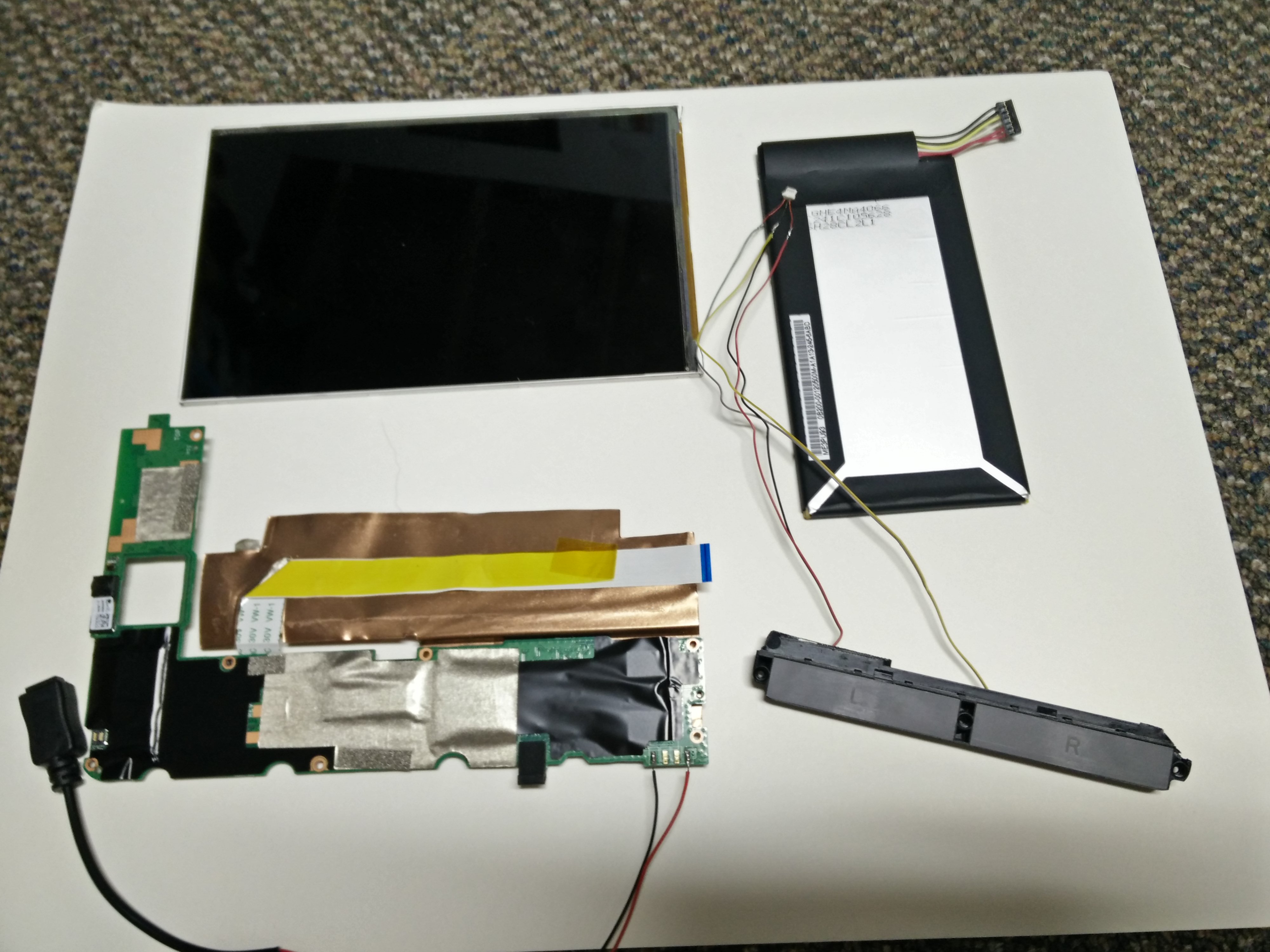

muniosi wrote:At first I was skeptical of a wooden case but that looks damn good. I'm super excited to see this finished! Are you planning on disassembling the tablet or just using it in its case?

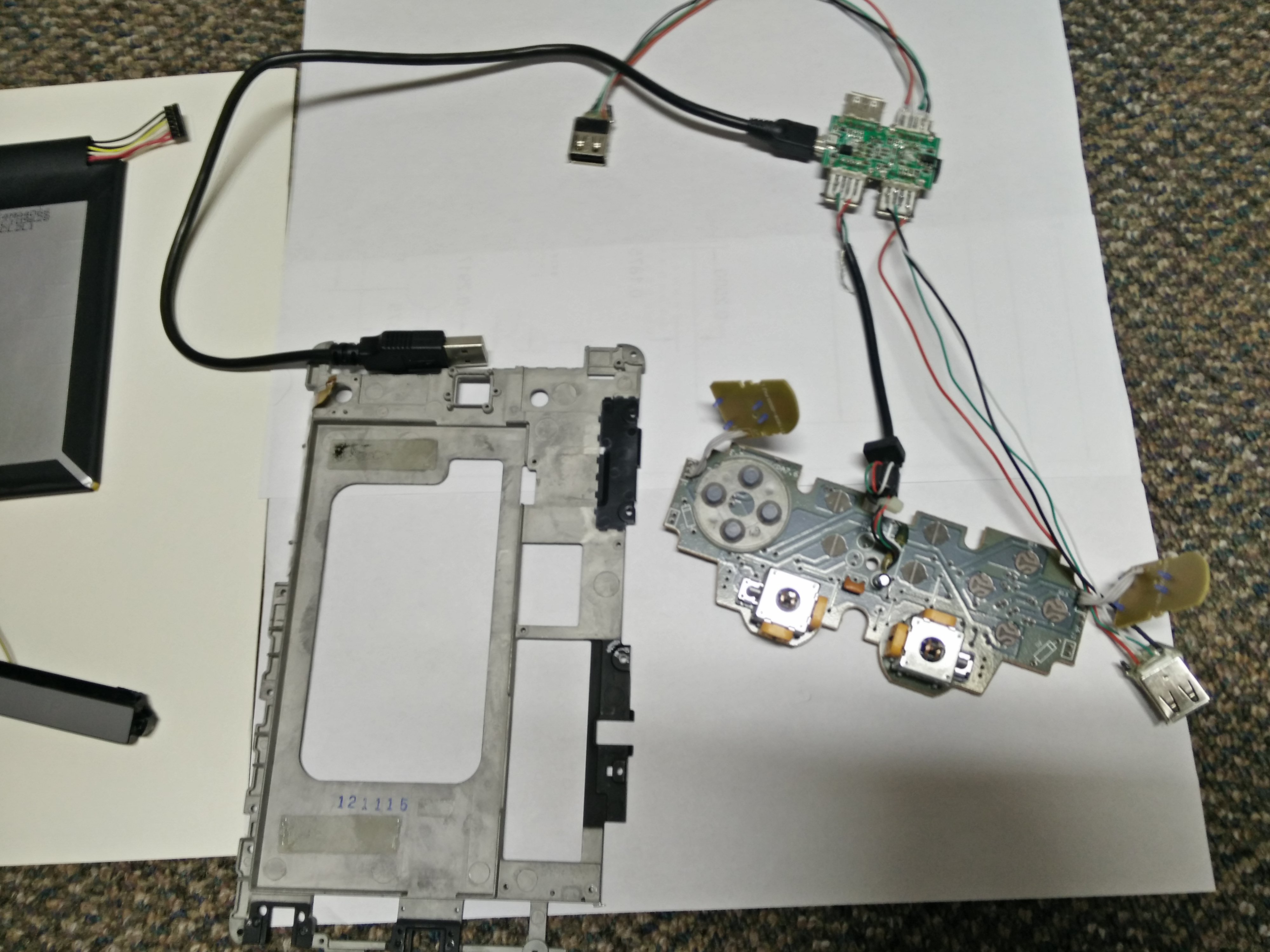

Thanks, I have disassembled the tablet and will just be inserting the components I need (no case),
moosepr wrote:I do like the laser cut wood look! How do you plan to mount all the "guts"?
The laser cutting turned out better than I hoped, I am still trying to figure out how to mount everything, but probably mostly with epoxy, hot glue, wood and plastic. If anyone has any tips or prior experience I am open to ideas.
abrugsch wrote:you know you can eliminate the scorch marks of the laser by putting masking tape over the cut lines don't you? Otherwise this looks properly amazing! :ugeek:
Thanks, I do know about using tape, but I don't have a laser cutter and I had someone do it for me, I have been lightly sanding the "scorch/smoke" marks and they are coming off fairly easily.

Here are a couple more pics of the components I took this morning.

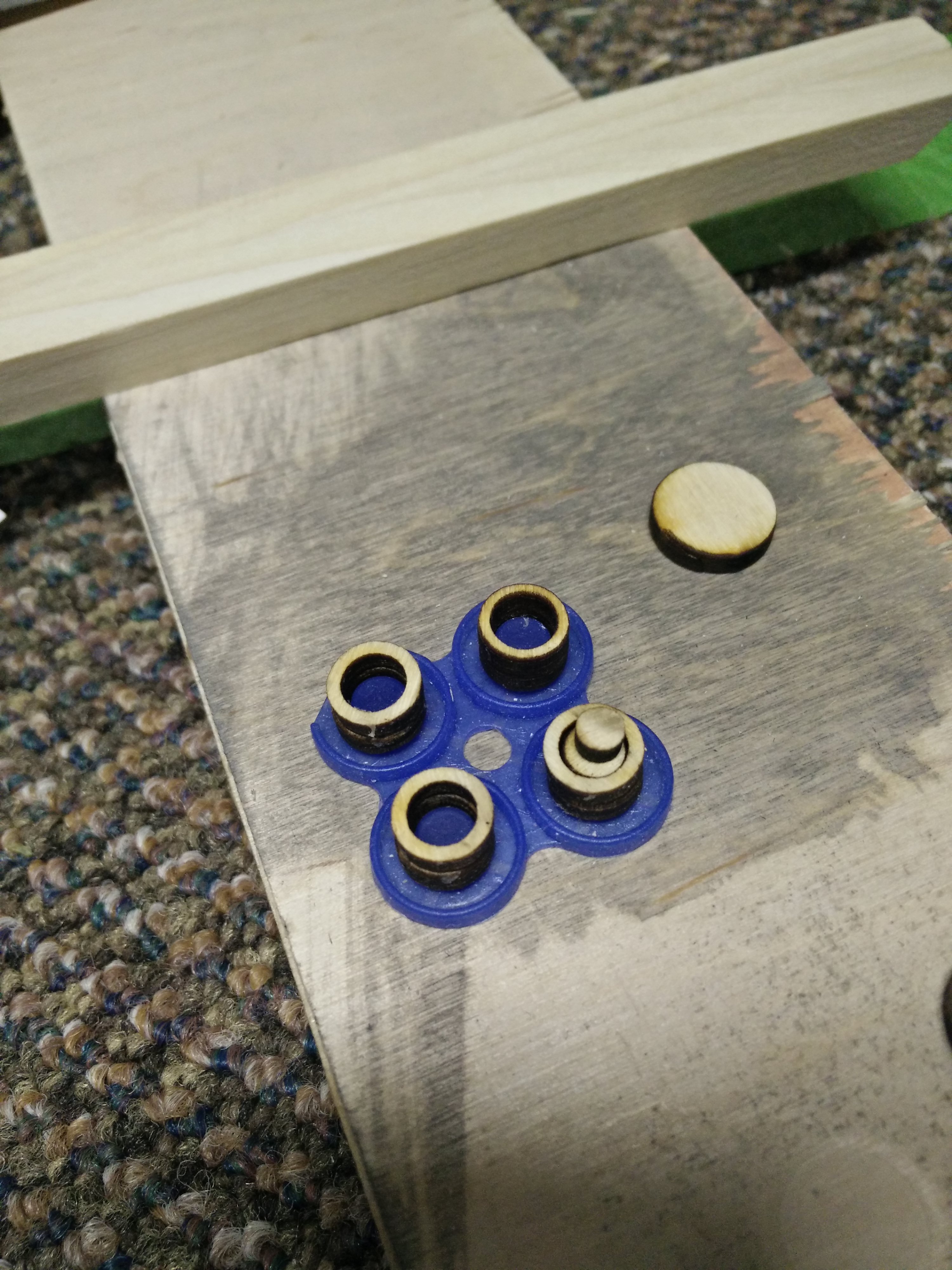

I had some wood rings/washers made when it was laser cut that I plan on using for button wells to make sure everything stays lined up.
