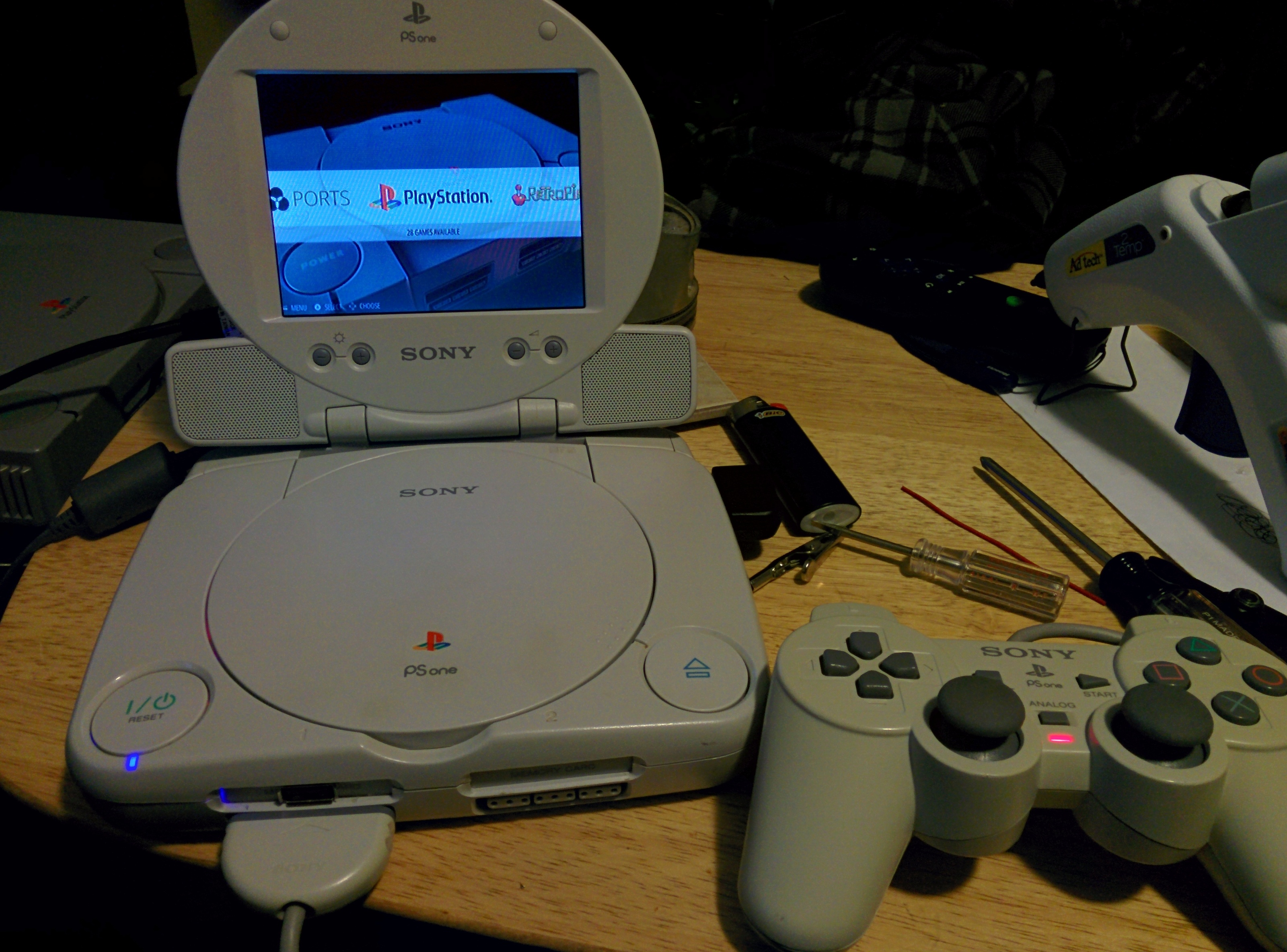

Just thought I would share my PSone that I have been working on. The controller ports work and the LCD connects though the original multi av port on the PSone. The whole thing is powered from the original PSone power brick.

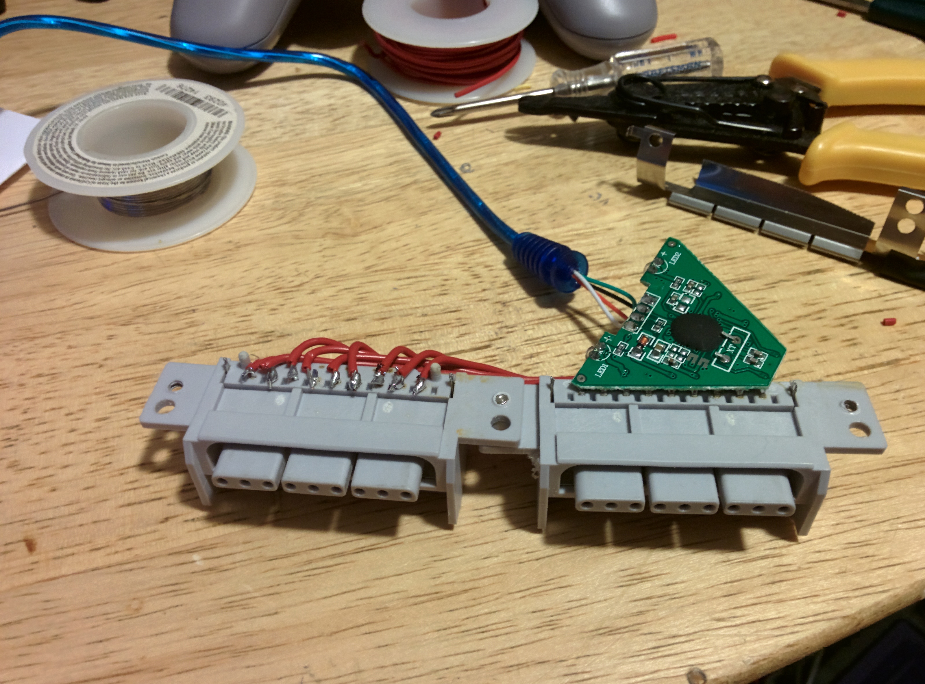

Wiring the cheap playstation controller to usb adapter in to the controller ports.

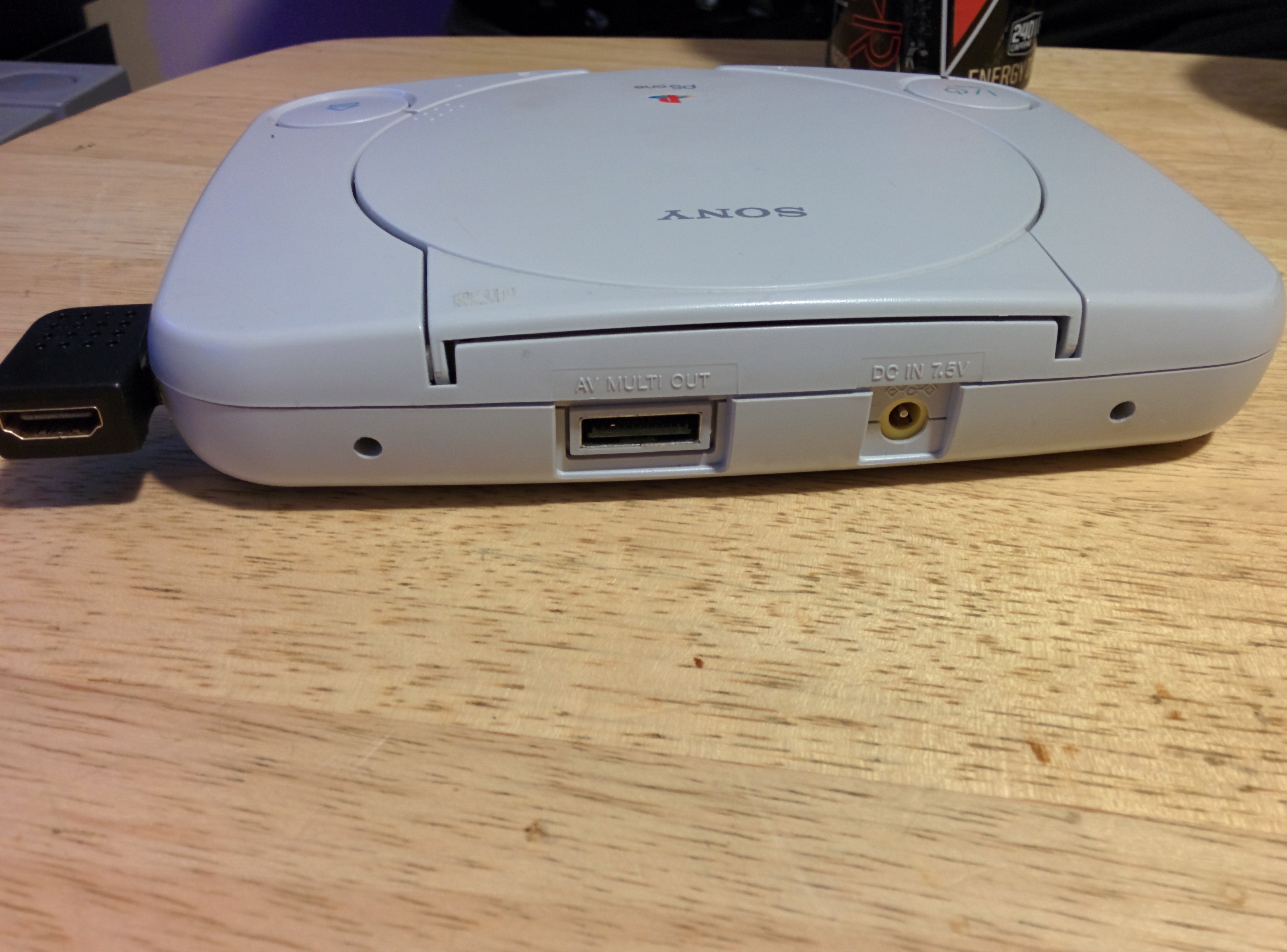

Testing the PSone power brick. I had to route the HDMI out the side since I couldn't figure out a good way to run it out the back and still be able to mount the LCD. On the right side of the case is a cheap USB hub I used so I could turn off the controller ports since I am mostly using Bluetooth controllers. I am also using it for the front USB ports.

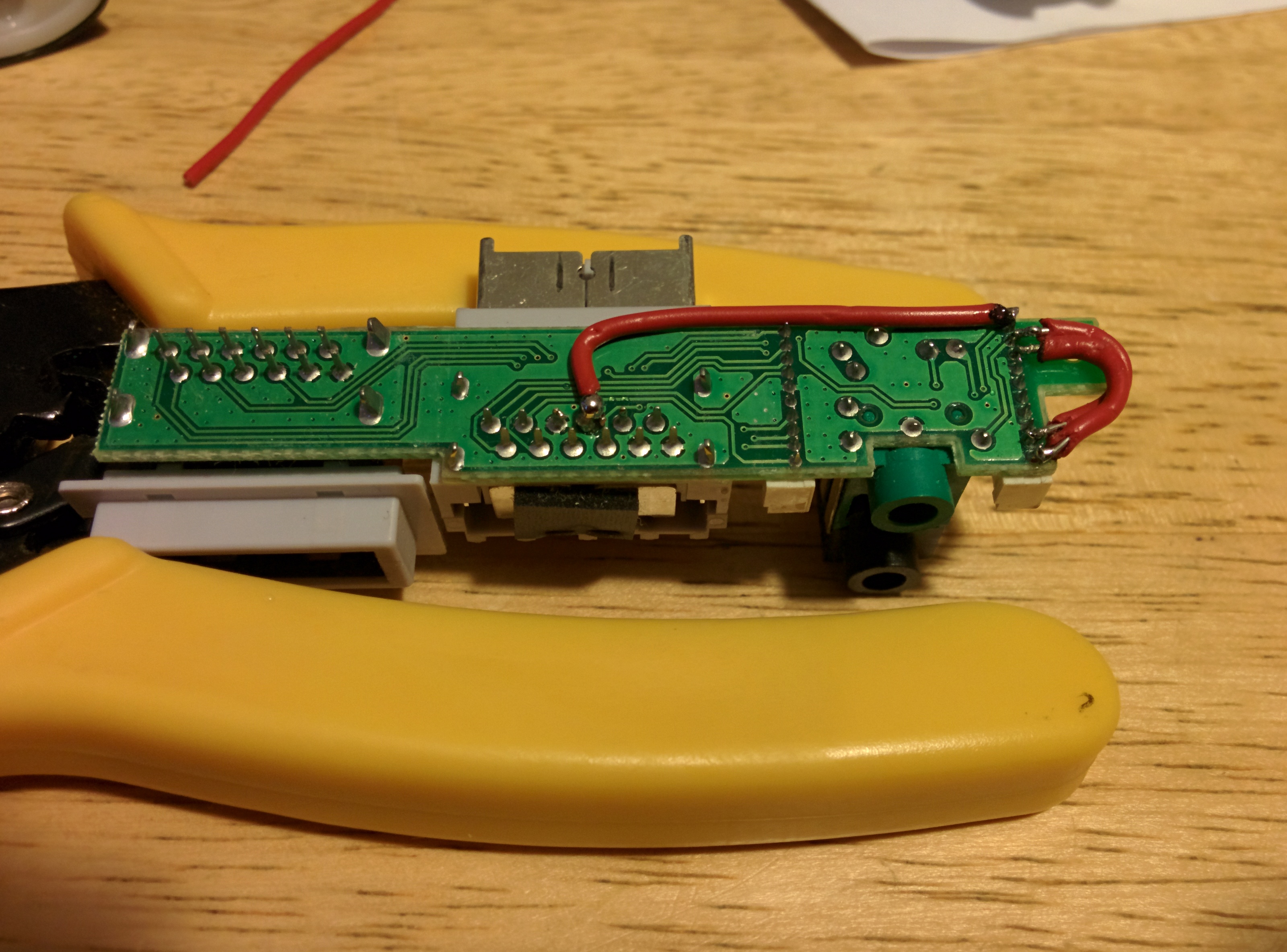

I had to mod the LCD since it expects RGB from the Playstation.
I cut an access hole in the side so I could get the SD card out from the Pi without having to take it out of the case.
How the back looks without the LCD attached.
