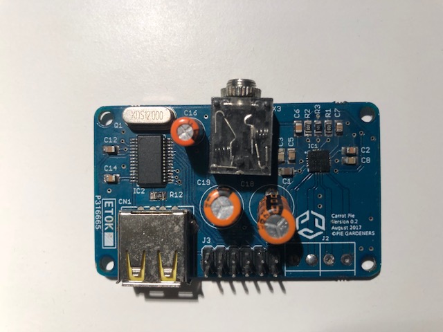

Currently i am working on a 5" Portable. After investing a lot of Time (And Money ;)) i didn't found any good and small All-in-One Audio Solution. So i came up with the Idea to develop my own Audio Solution.
After investing much more Time ... this is the first Prototype:
It contains a PCM 2704 USB DAC and TPA2016 Audio Amplifier all the Pins for external Buttons and i2c Control of the Amplifier are routed to the PIN Header.
Also it contains a Headphone Jacket which switches automatically to Headphones as soon you plug in
Youtube Video: https://www.youtube.com/watch?v=qy0PXclmHKc
It sounds absolutely amazing i am very happy with the board

Looks cool. Where and how much? :)
One small suggestion: if you're selling it for use on handhelds, it'd be nice to have the headphone jack, USB port and header block depopulated - it would make the board more compact and easier to locate inside a cramped build.

Thanks for the Reply ... as i said it‘s just a Prototype.
I want to do following:
- Replace Caps with SMD Ones
- Replace USB Connector
- Make it as small as possible ;)
I thought about JST Connectors for all external Connections or do you prefer PIN Headers ?
