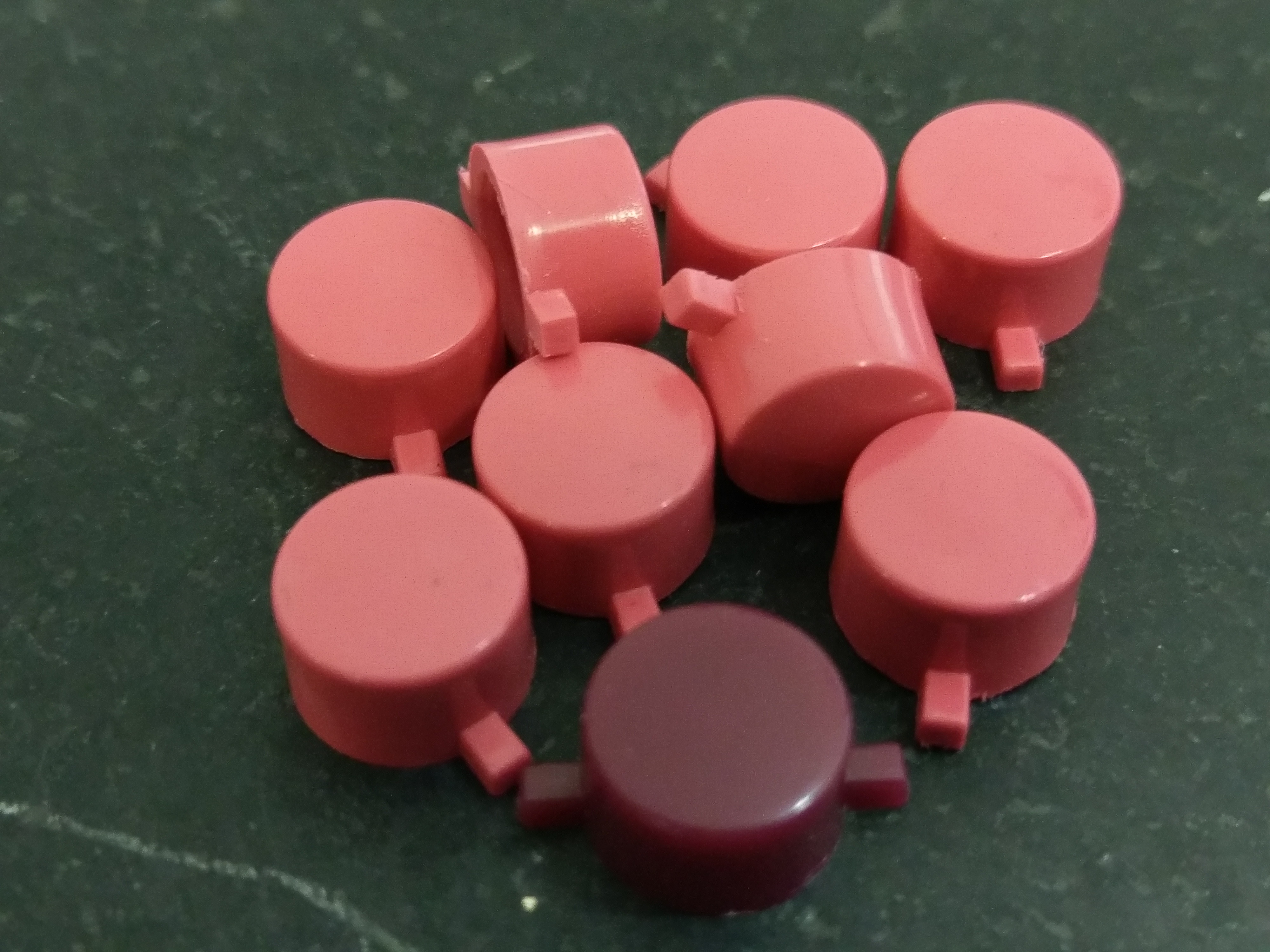

But recently I gotten rather heavily into custom casting things in expoxy, poly and silicone.. It's really enjoyable tbh
Making the molds is a big learning curve, better the mold, better the part. Ive done buttons for most gameboy variants, cart shells etc

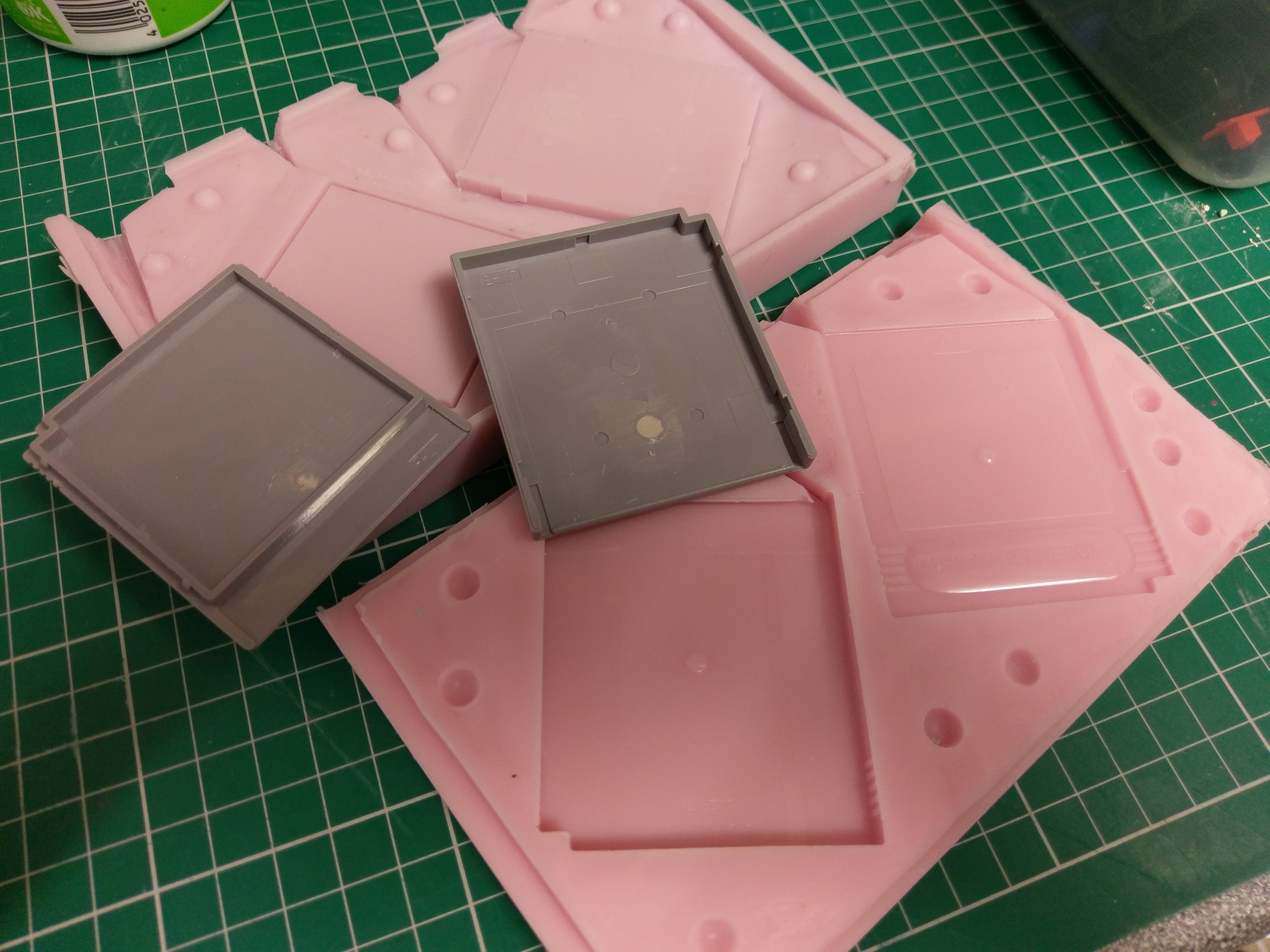

The carts mold was made for a friend of mine that sells pokemon rom hack for the original gameboy
tools needed are as basic as you want it really. You possibly have everything i use already. I have made the addition of a vacuum chamber to degas (remove the air) from the silicone and resins to make better molds and castings.

It is very much a learning curve. The molds I was making a first when I look back now are shockingly bad. But with every mold come an improvement
A vacuum chamber changed things alot. Only cost £200 but ment everything is air free so worth it really
You don't nees that however. If anyone want to try it out then I'm more than will to pass on some tips
Your parts is only as good as your mold, so you need a really good part to make it from and if it's a 2 part mold you need to think how yoy are pouring and venting the part. Pour into the bottom and vent out the top should hopefully mean no air pockets
