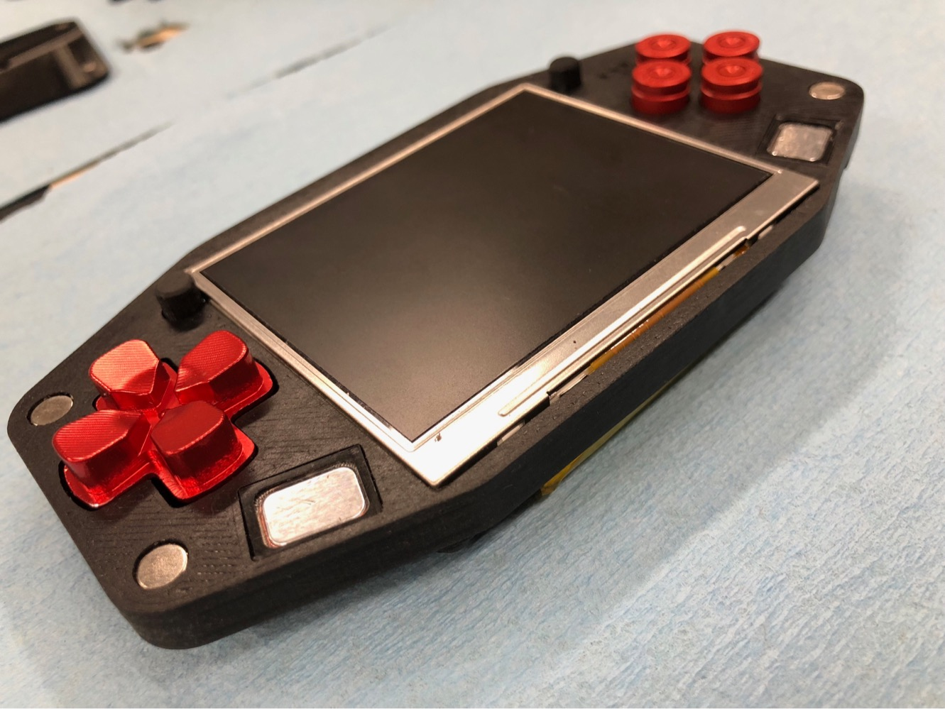

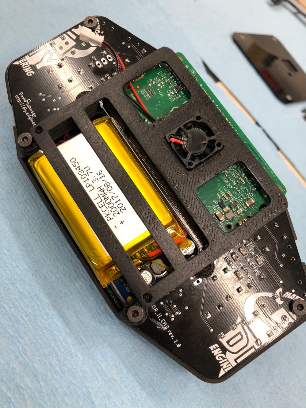

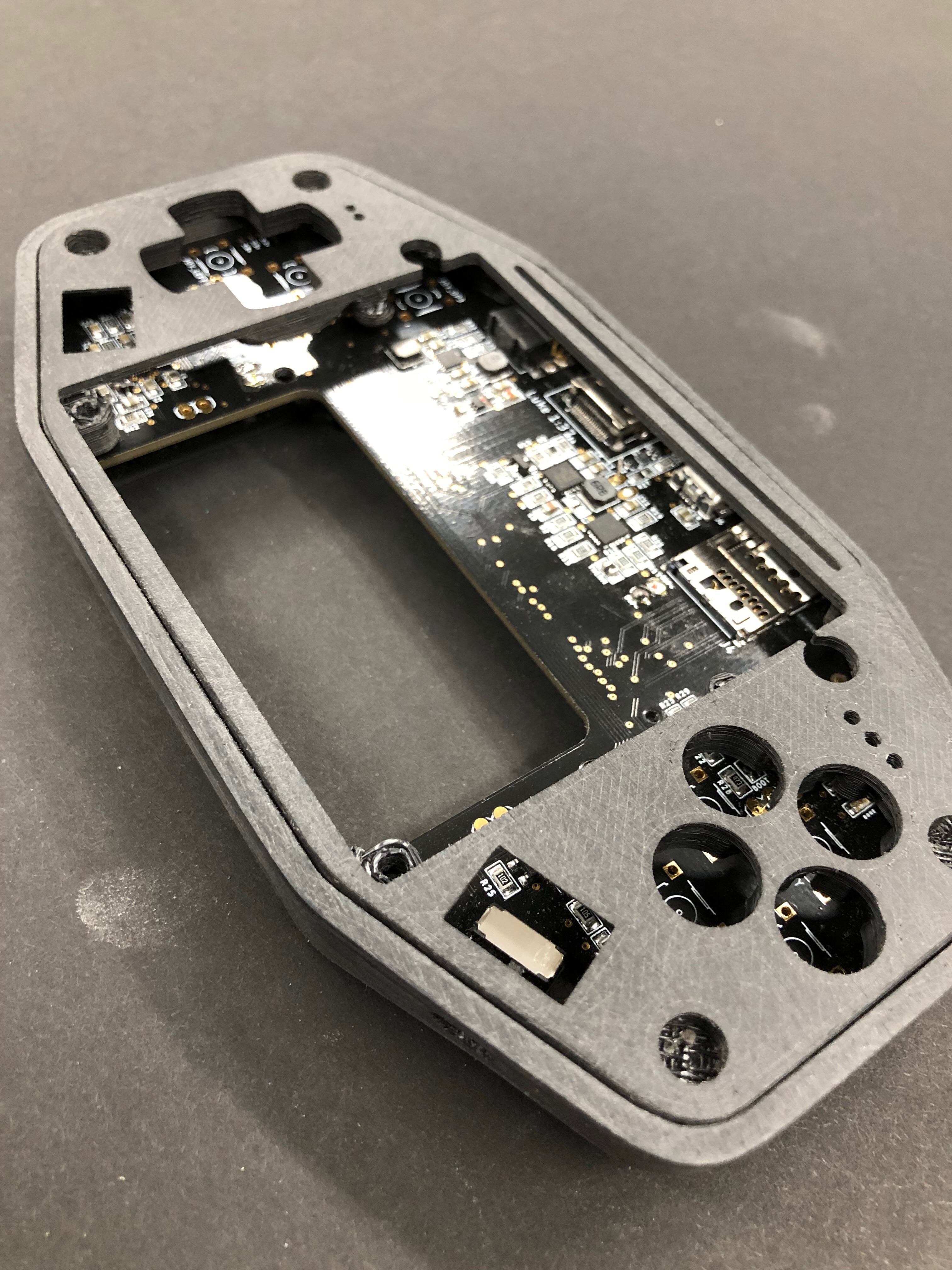

I've made a few handhelds now, they all tend to be custom from the ground up, this time around I've challenged myself in creating a new model.
Built around the PI CM3, a custom developed AIO host board (integrated boost, stereo audio, power monitoring, active thermal control, yata-yata), custom milled body and personalizable aspects (button colors and custom bezels) it's my best work.
I am currently finishing up the production aspects of the design and just recently opened pre-orders for it for delivery this fall.
Most of my build log are in my social feeds, but here are a few pictures from different phases of development.
http://instagram.diy.engineering
I hope you like it.
preorder info can be found at http://www.diy.engineering/shop

yea, it is a 3.5" display
the design was built around some mfg constraints, one that I imposed was keeping the thickness under 3/4" (sourcing the exotic hardwoods is much easier...) as a result I was pressed for space to include everything in that space, one of the compromises was using a 2.5mm headphone jack to save a couple mm in height. I use an adapter (2.8mm->3.5mm) but I realize it's not ideal for most folks.
I don't use headphone jack much so it doesn't really bother me. :)
