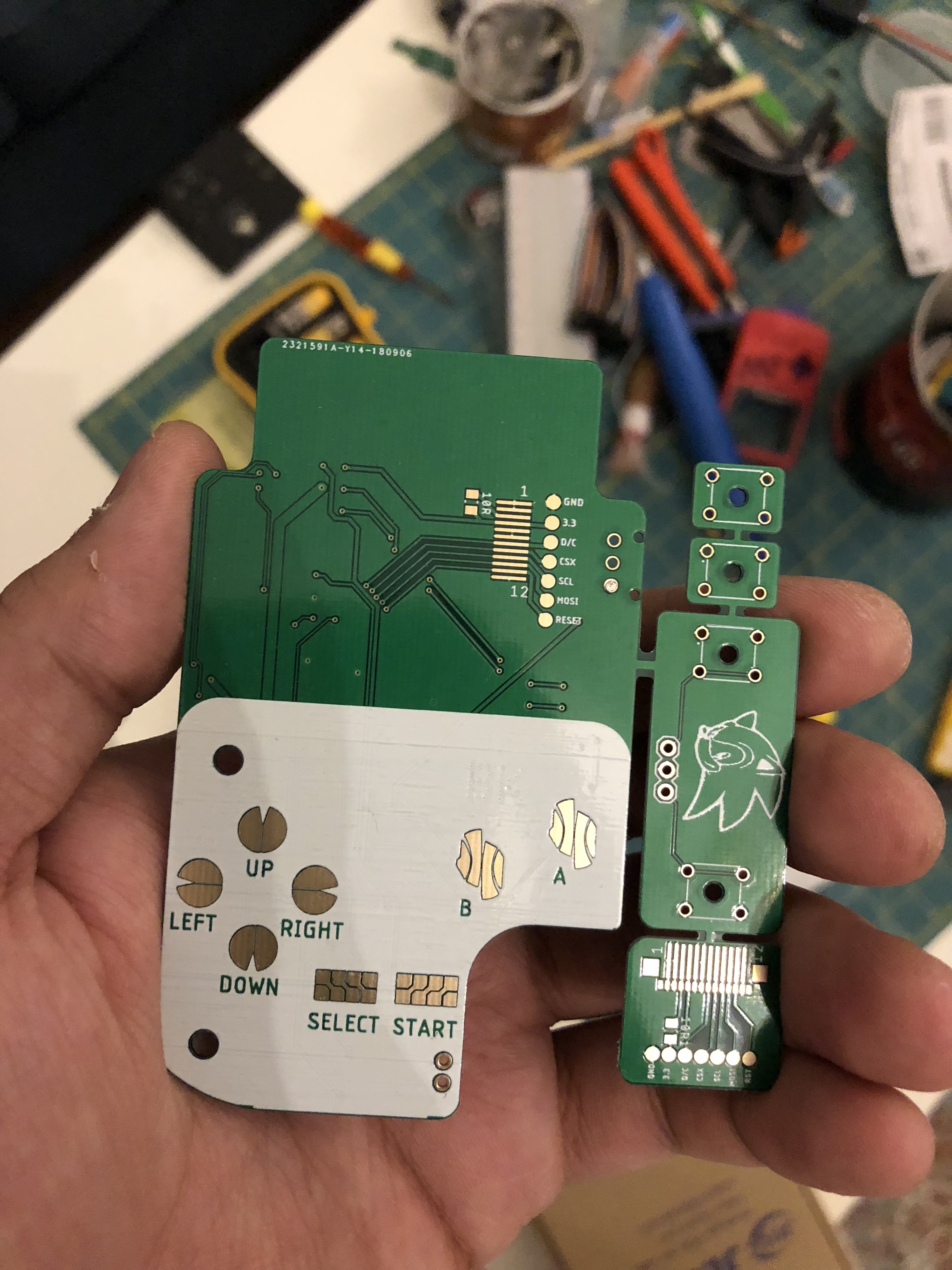

Hi
here is my BurgerKing toy build with custom pcb
I'd like to share it with you.
  • Raspberry Pi zero W
  • 2.0 spi screen
  • i2s audio
  • 1000 mah battery
  • 6 buttons

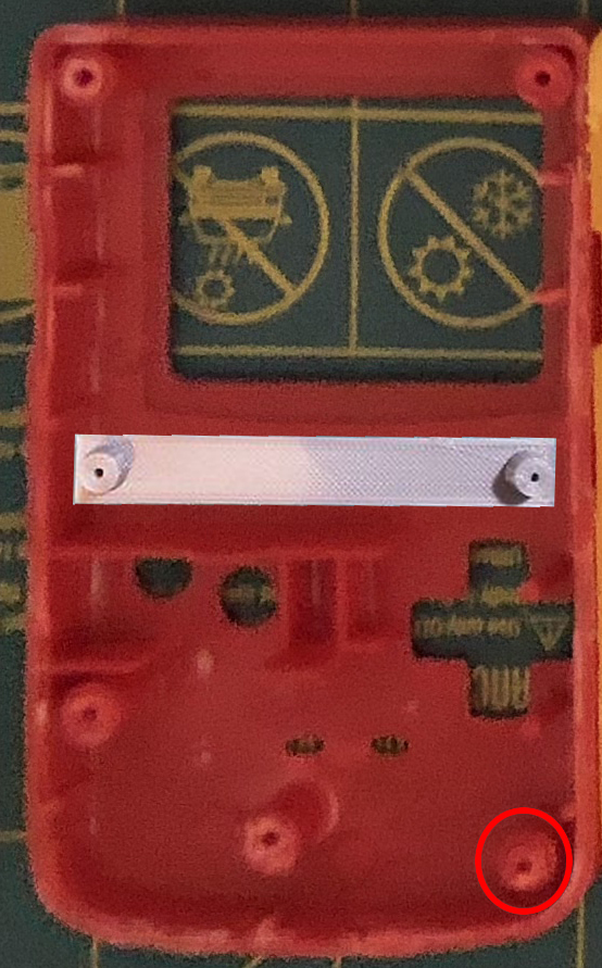

This is my board outline if anyone is interested to start his project.
It is designed to be forced to stick in the housing.

Only issue I see is that if the buttons are pressed hard will it move the pcb inward from the pressure on the shell holding it in place? The one I plan use will have the pegs in the center and corners hold the pcb firmly in place using some 3D plastic shims. If yours is not going to move at all even if pressed in then that is the way to go.

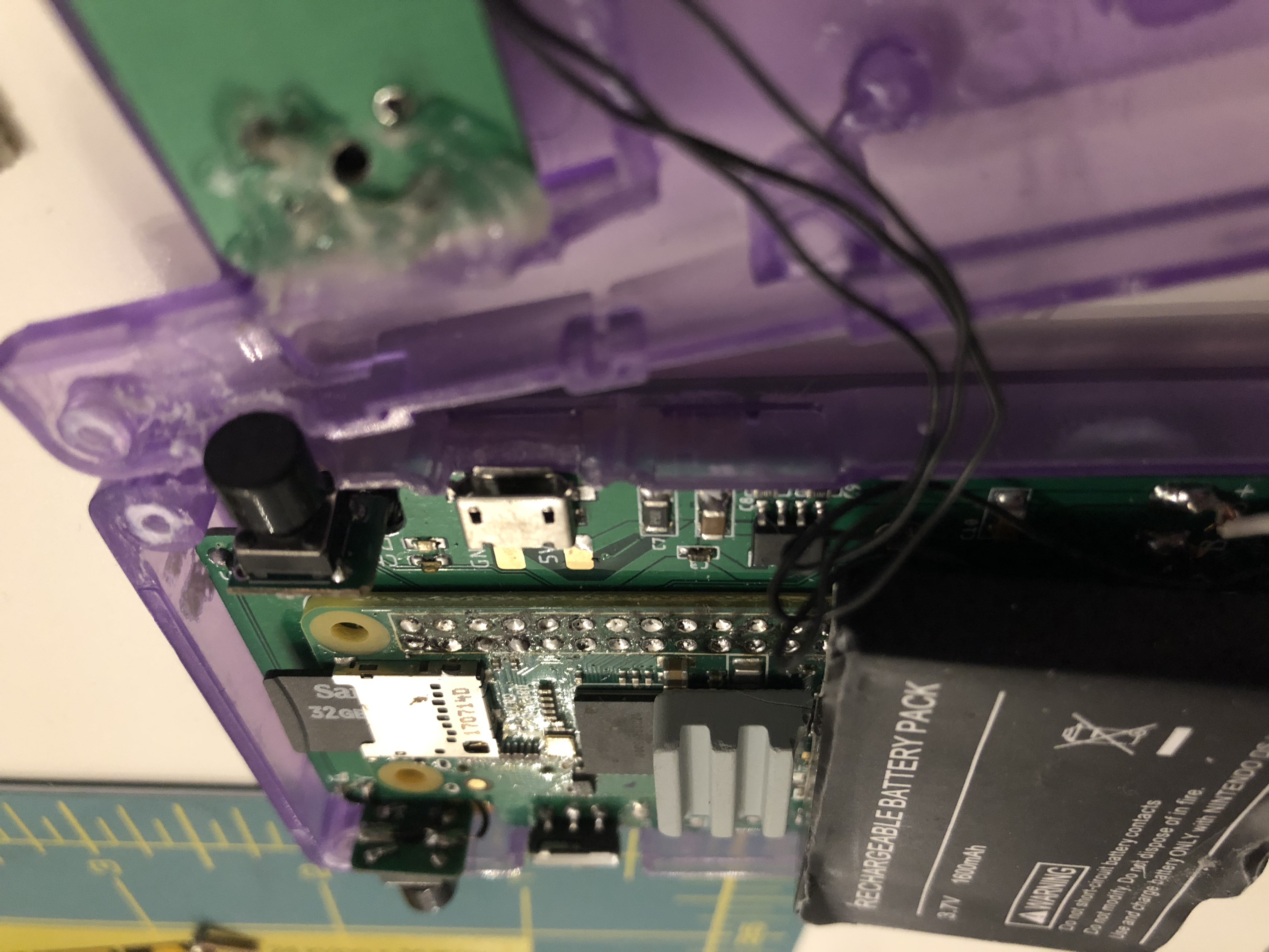

The board itself not enough to hold everything i use one screw to hold the board . But this is not a solution to all the Bk gameboy shapes
There is something in common between them all
this screw (according to my knowledge)
I think this screw + pi and battery pressure is enough to hold the board.
And if you can print a 3d part It will be better + one board support all the gameboy shapes.
