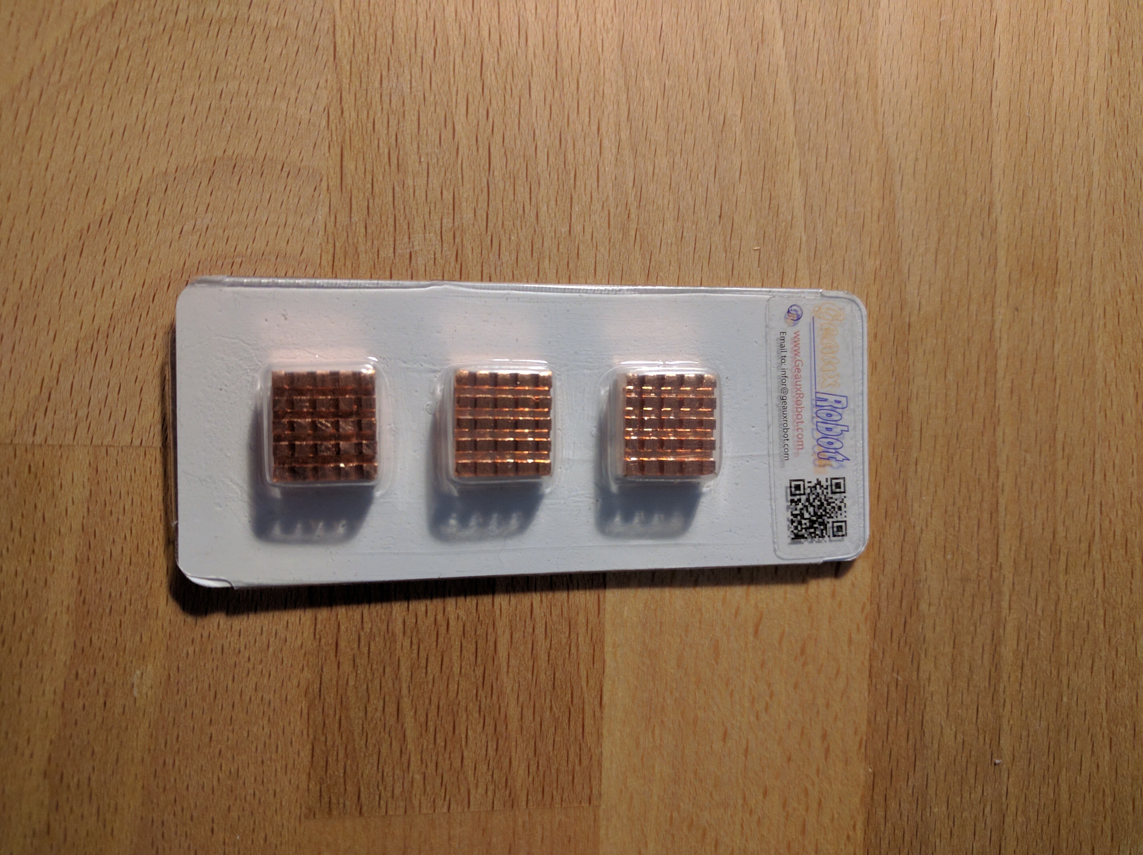

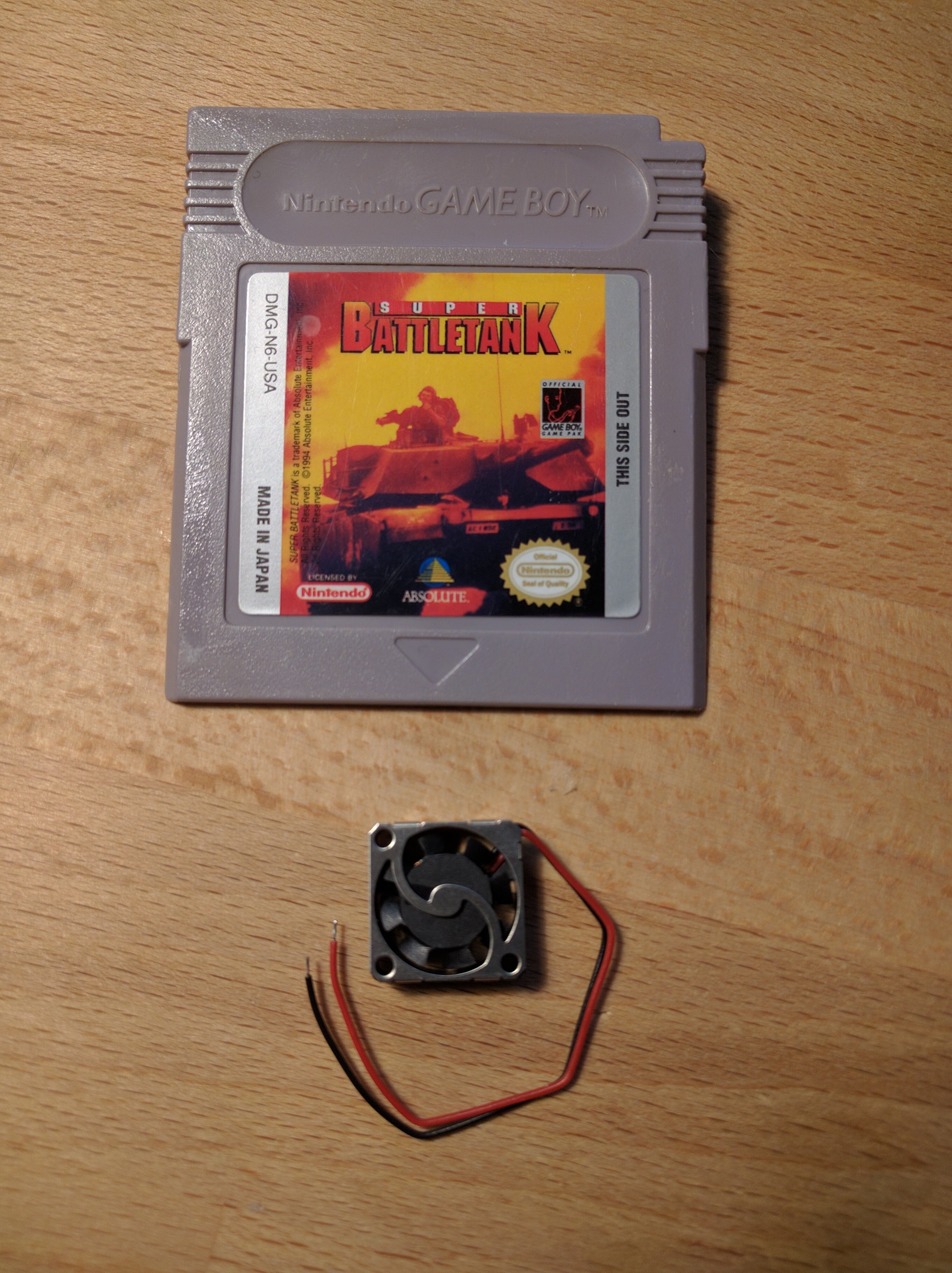

Post by dirtybeagles » Mon Jul 18, 2016 8:14 pm
I played Zelda for about 1.5 hours and here is my temperature reads. I also put one of these on there, not sure if it really makes a difference. No clue where I plan on putting the little fan I bought without modifying the case more. No problems though playing, it just got warm.
[spoiler="Heat Sink"]
[/spoiler]
[spoiler="Attached Heat Sink"]
[/spoiler]
[spoiler="Little Fan, no room though"]
[/spoiler]
