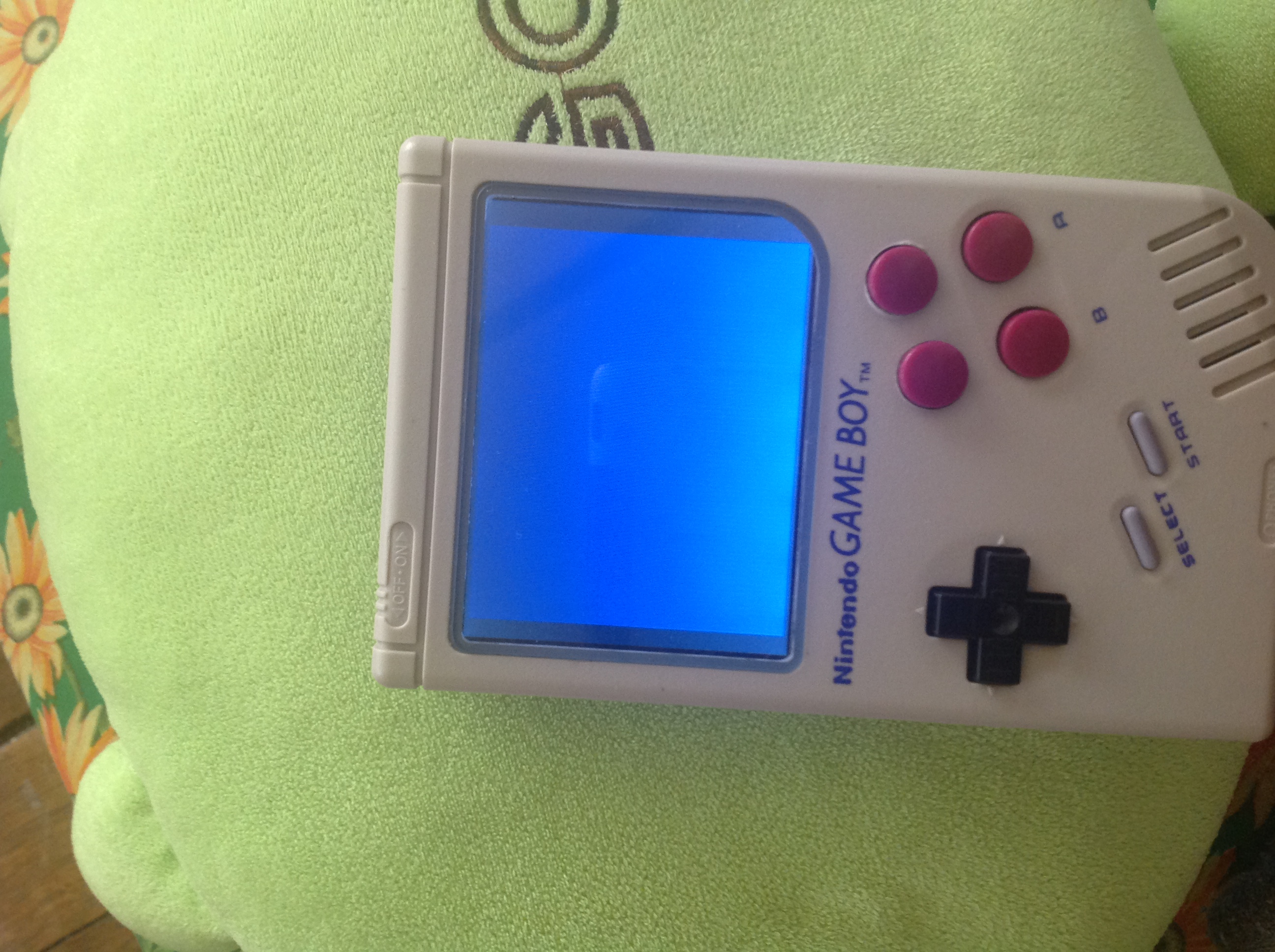

HOWEVER, since completing my Gameboy Zero build using Kite's superb SAIO board, I am no longer able to run pcsx-rearmed on my Pi-Zero. Instead of booting up and running the chosen game, it displays a few screens of blue vertical lines before turning to a shade of green. At this point, the whole system is unresponsive, not even to the safe shutdown switch. The Pi must be hard reset.
I've been trying all sorts of things to get this emulator working again as it did before but so far, no luck. I suspect it may be something to do with the display settings that seem to be causing it to crash, though I may be wrong. For the working version, I had used a Retropie 4.2 SD card image taken from the official webpage, then the Pi was connected to a computer monitor via HDMI. Since completing the Gameboy build, I am now using Kite's most-up to-date variant of the Retropie SD image (SAIO 20170401-1) and the Pi is now connected to a 320-240 LCD screen through the SAIO board itself.
Maybe the Pi's looking for a HDMI connection that isn't there. Maybe this emulator just doesn't work with a DPI screen. I don't know. I've tried tweaking the video mode and framebuffer res for the emulator but haven't seen any difference so far, and I haven't had any luck . Could there be one or two lines of code that might help? If anyone has any recommendations, or if you'd like to try this for yourself and see what you find, I'd really appreciate it!

I tested the emulator on my build with retropie 4.2 and my screen just blue then goes black. Buttons will not response.

Thanks for that guide. Got it working to play Tekken 3 but the screen is flickering though the speed is a lot better than the default emulator. Do you know how to fix the flickering issue? Will try some other game tomorrow.
