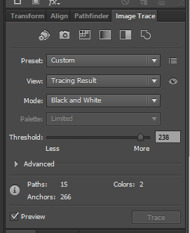

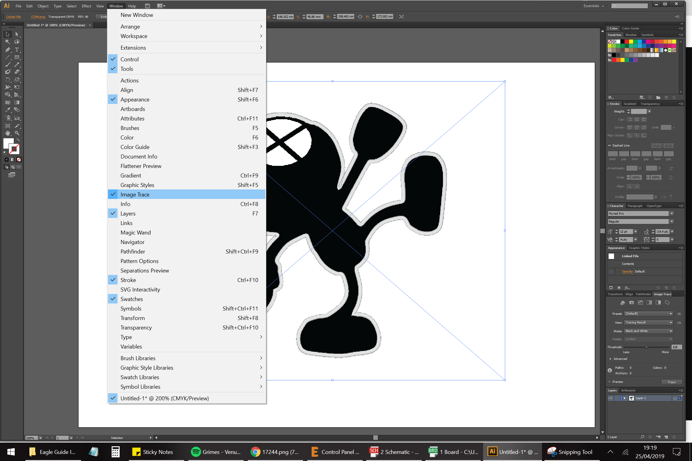

Easily cleaned up in Illustrator by turning on the Image Trace 'window'
Set it to Black and White, click the Preview box, then adjust it until you get what you want.

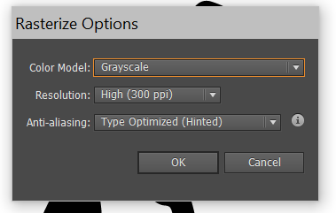

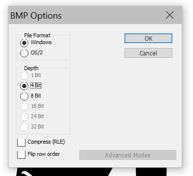

Export it as a Grayscale BMP:

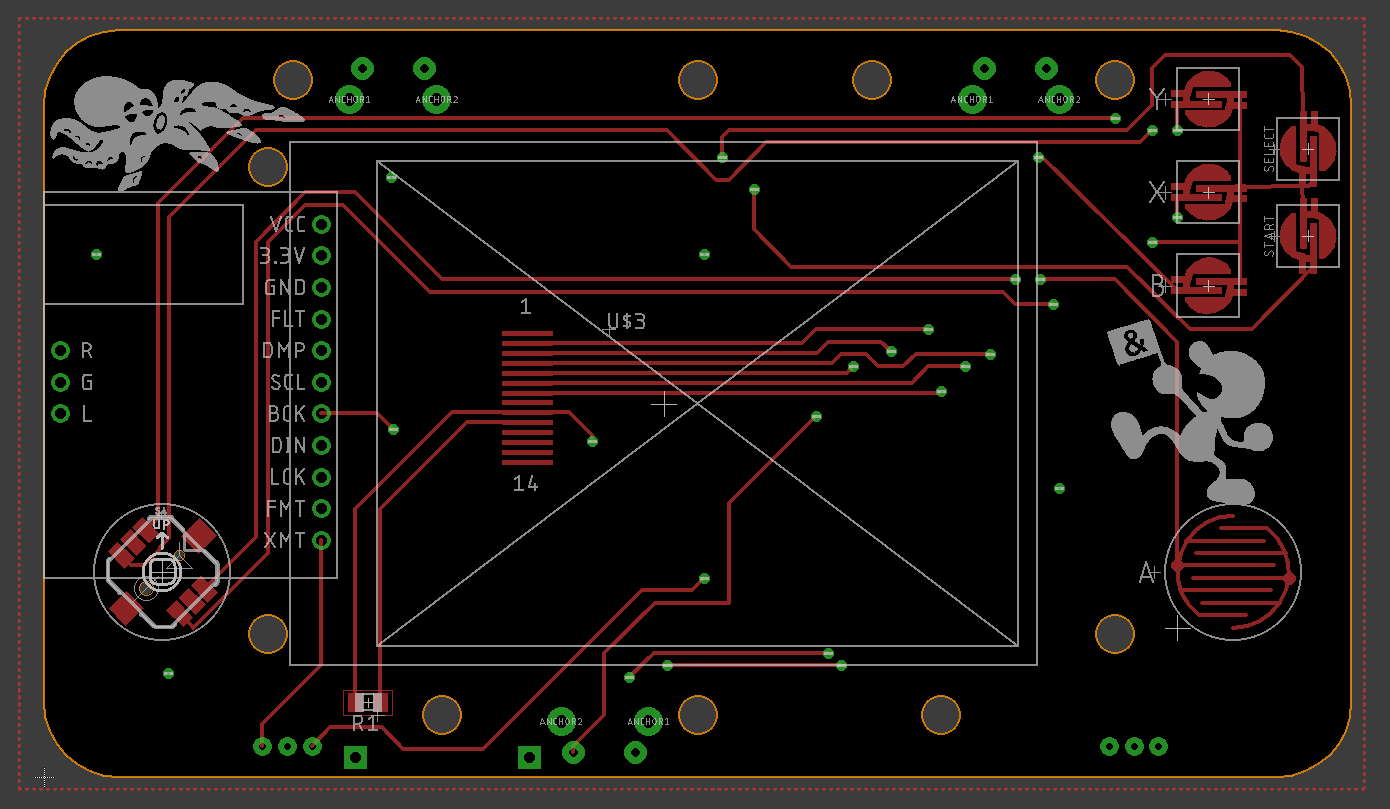

Here's the board before:

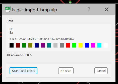

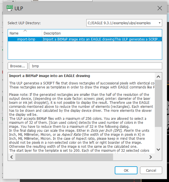

Select File>Run ULP type bmp to find this
Click ok and find your image to see this:

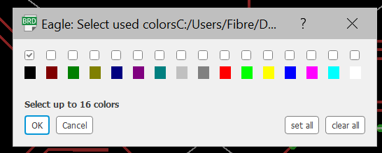

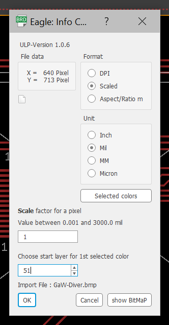

Click Scan used colors. Clear All and select just black:
You'll see this next:
Make sure you change this bottom number to either 51 for the tDocu layer or 52 for the bDocu layer to save yourself a headache.

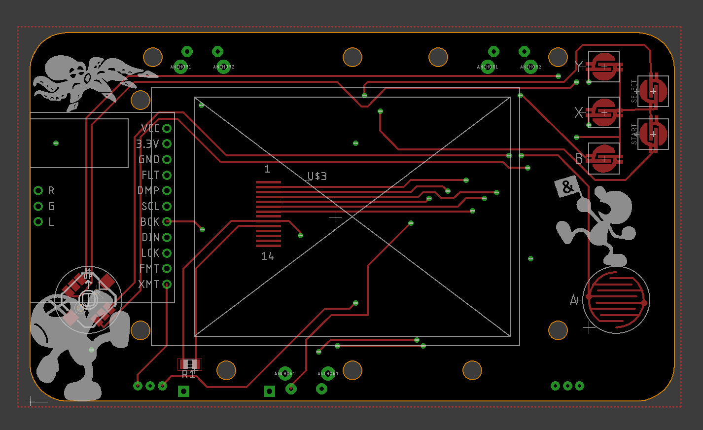

Click ok and Run script.
You should now have something like this:

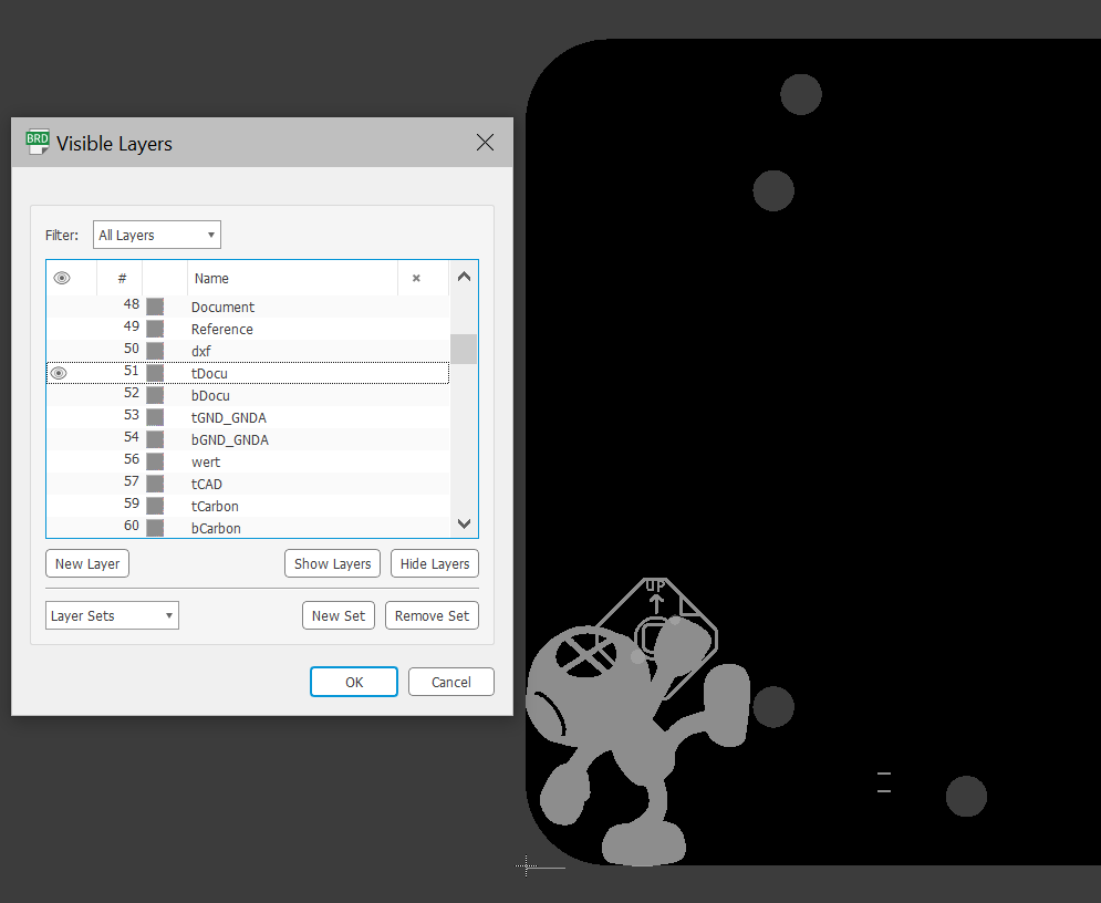

It's on top of everything and made from a ton of tiny points, making it a pain to move around. This is why we put it on the tDocu/bDocu layer.

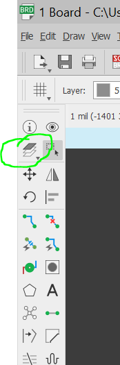

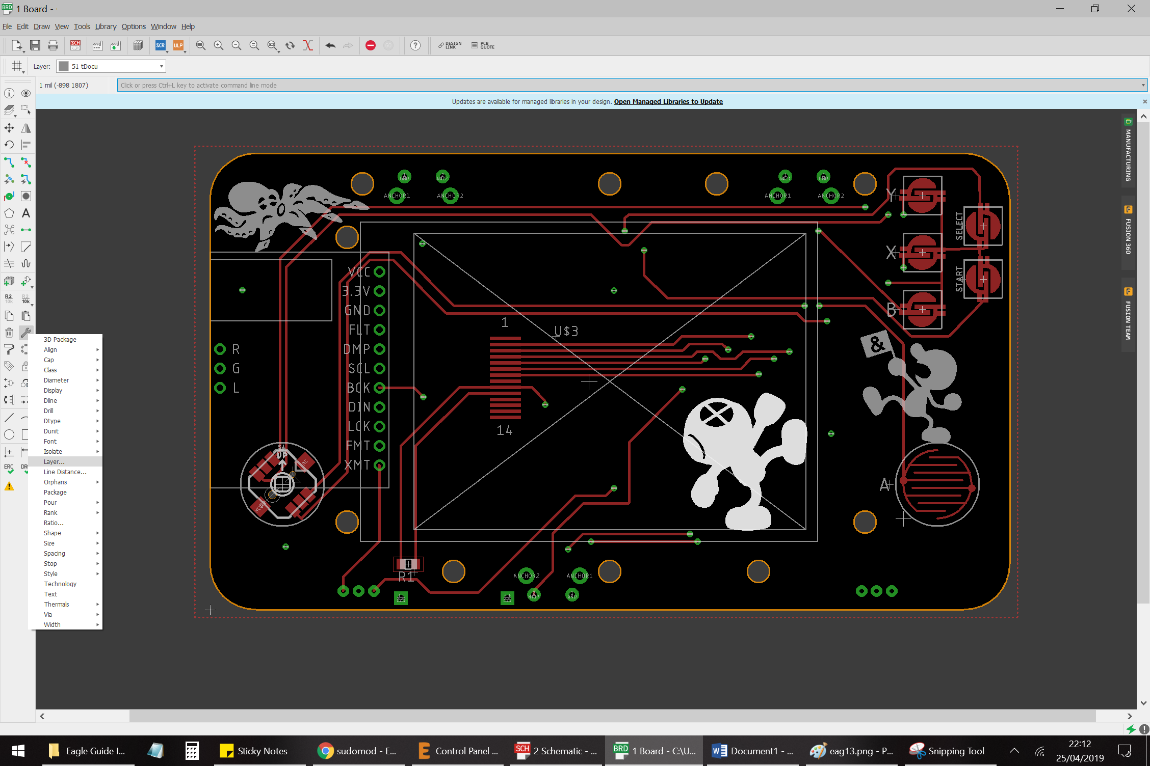

So click the layer button:

Hide layers and show only either 51 or 52:

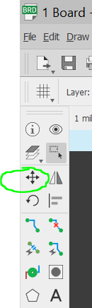

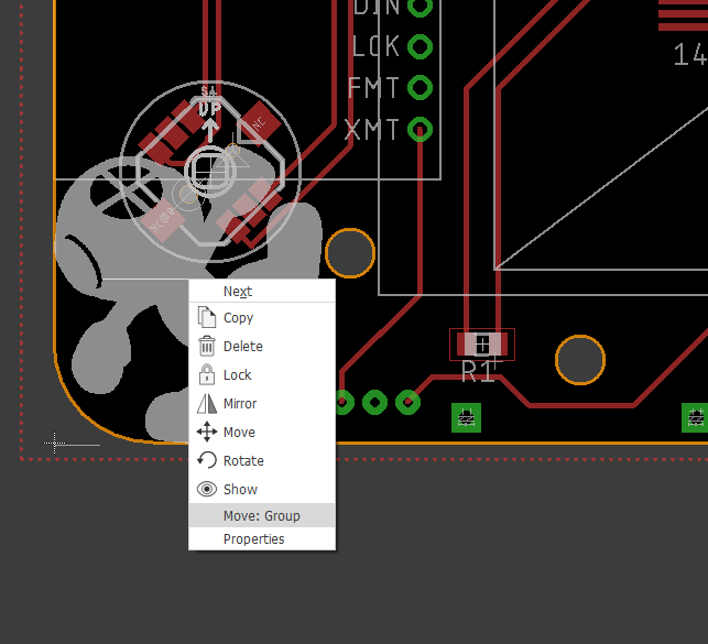

Now click the Move tool:
Right click over your graphic and select "Move: Group" from the list:
You'll be able to move the graphic into position:

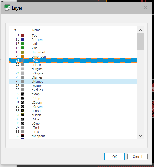

Almost done. Once you're sure you have it where you want it, hopefully you still have it as the selected group (if not repeat the steps in this comment), click the Change button, then click Layer...
and select either tPlace or bPlace

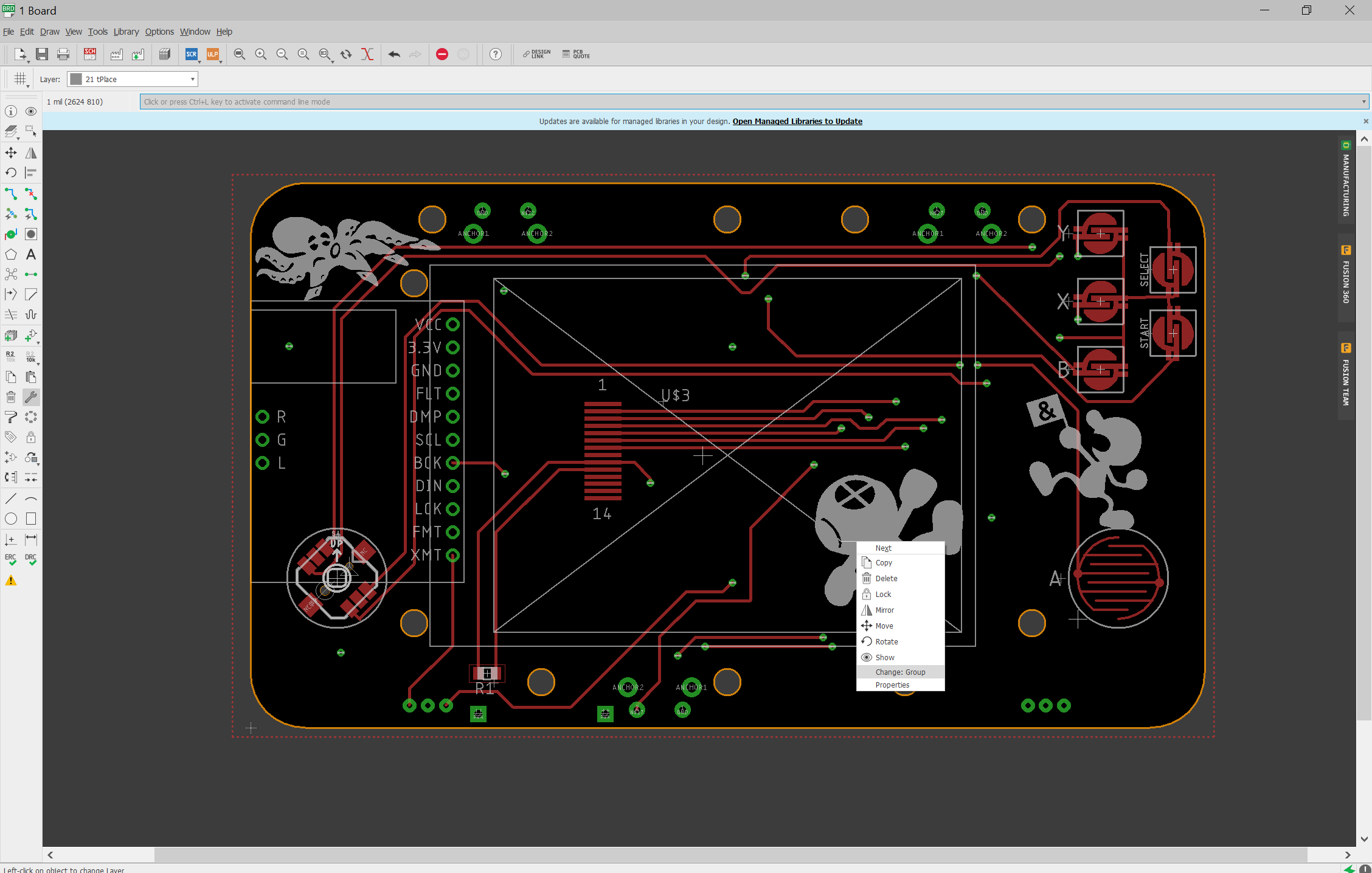

Now right click and choose "Change: Group" from the menu to move it to the silk screen layer:

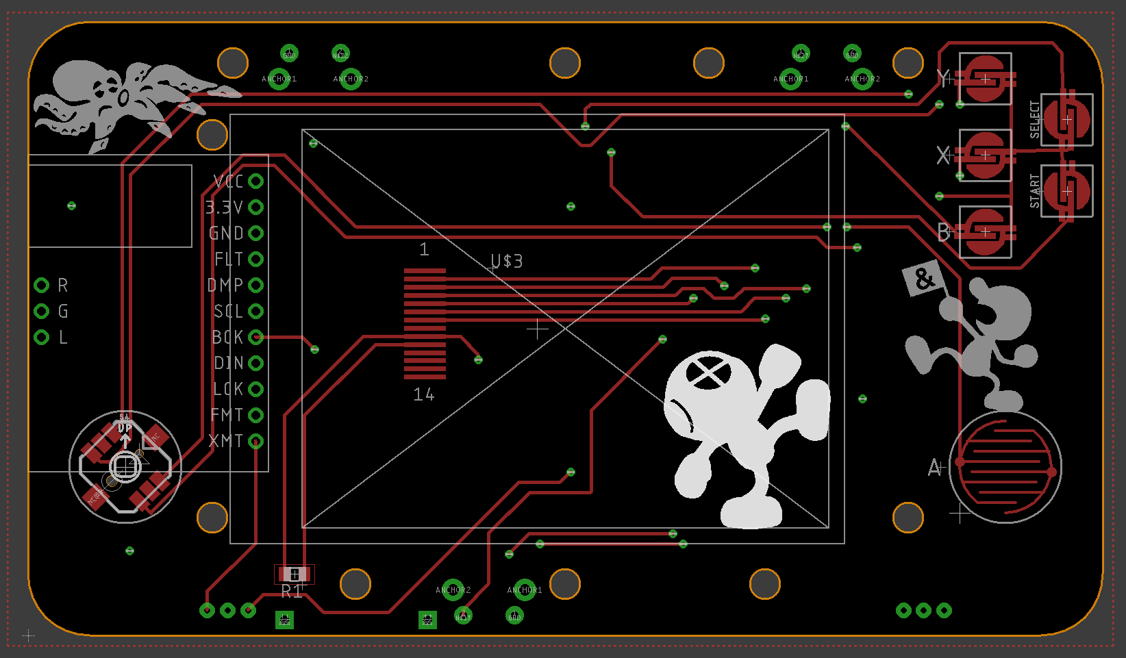

All done!

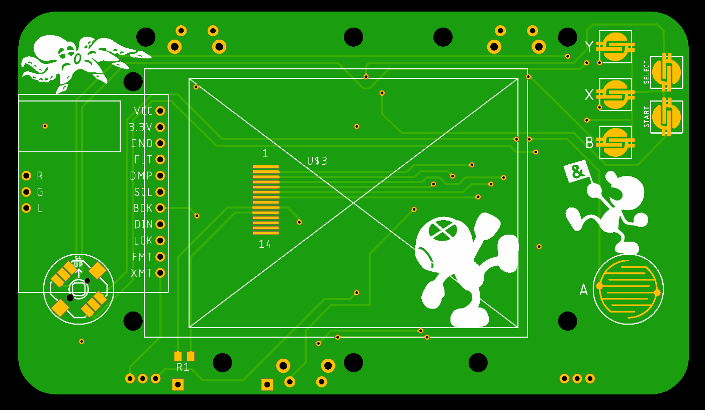

You can see roughly how your board will look by clicking "Manufacturing" on the far right side of the screen:

Getting the sizing right involves some guesswork, I recommend changing the size of the image before you import it, alternatively you can change the scale factor when you're on this screen:
Your grid settings will probably change when you do this, just set them back to what you had before once you're done.

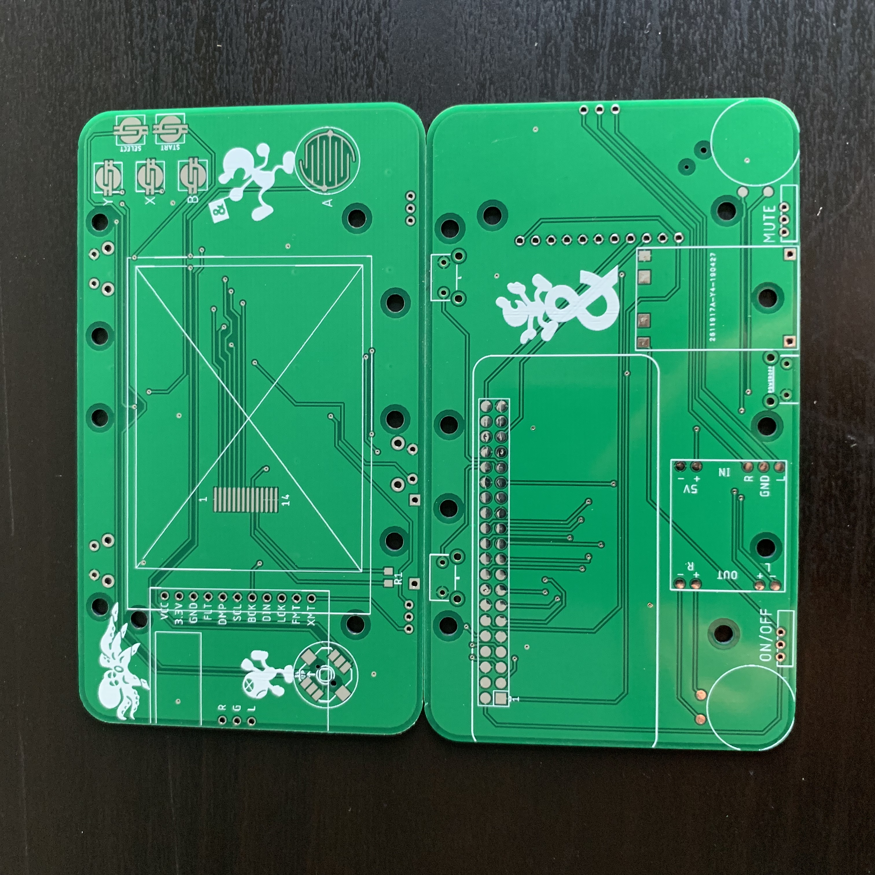

Here's how the board turned out:
