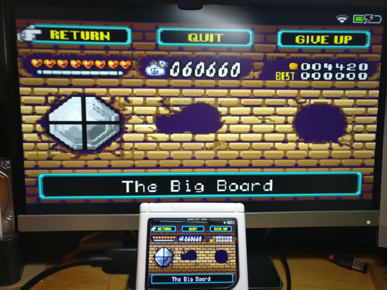

This guide explains how to mirror the content of the gbz display (composite, SPI, DPI) to the HDMI output (and viceversa), as shown in the picture below and in the famous closed-source unreleased Sword project. Since this solution automatically detects when the HDMI cable is connected in order to turn mirroring and power on and off it's even better and more sophisticated than Sword's one)
mirroringShow
First, we need to understand that every screen plugged to the RPi GPU has a dedicated portion of memory (framebuffer) attached to it which is used to store the image shown on screen. The mirroring software basically copies the main screen's framebuffer into the secondary screen framebuffer at a given frame rate (this is when the gpu effort comes into play), more the frame rate, more the gpu effort.
