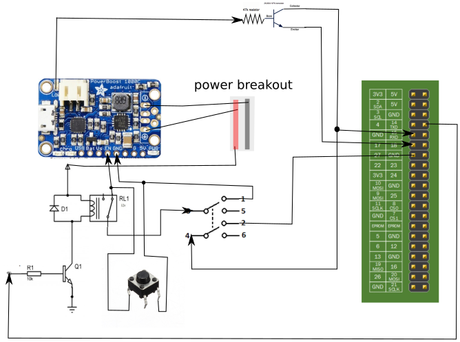

Felix
Posts: 44
Joined: Wed May 11, 2016 7:17 am
Location: Antwerp, Belgium
Been thanked: 12 times
Re: Tackling Graceful Shutdowns on the GBZ
Post by Felix » Sat Jun 11, 2016 3:37 am
@Camble, I think I found a solution but it actually makes the pololu obselete. The solution is mechanical in the meaning of a small relay switch. I'll attach a picture of the wiring.
Without pololu.png (142.01 KiB) Viewed 8523 times
