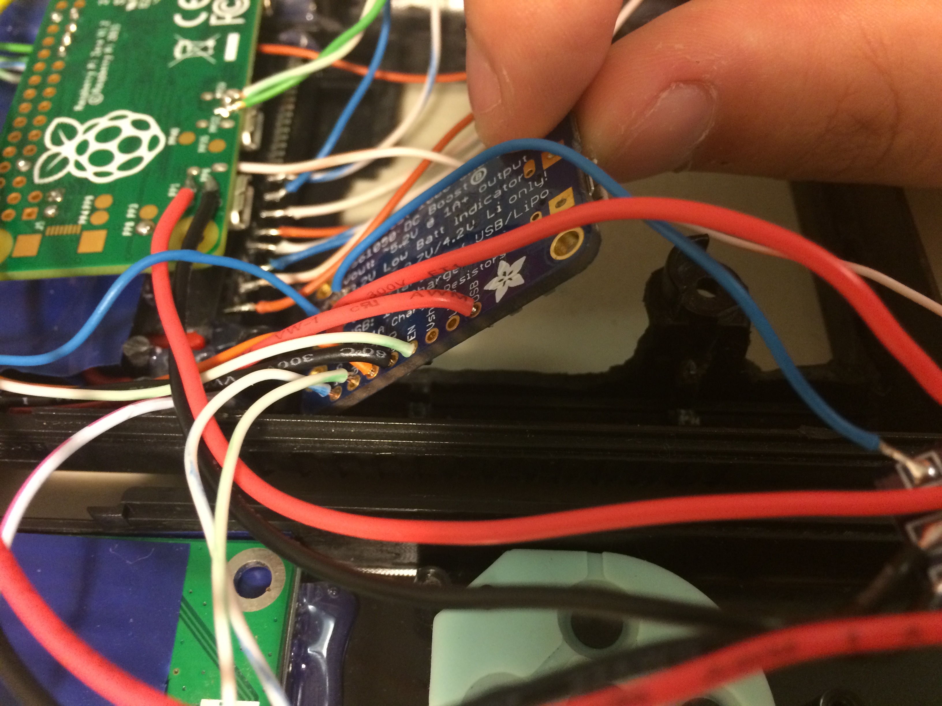

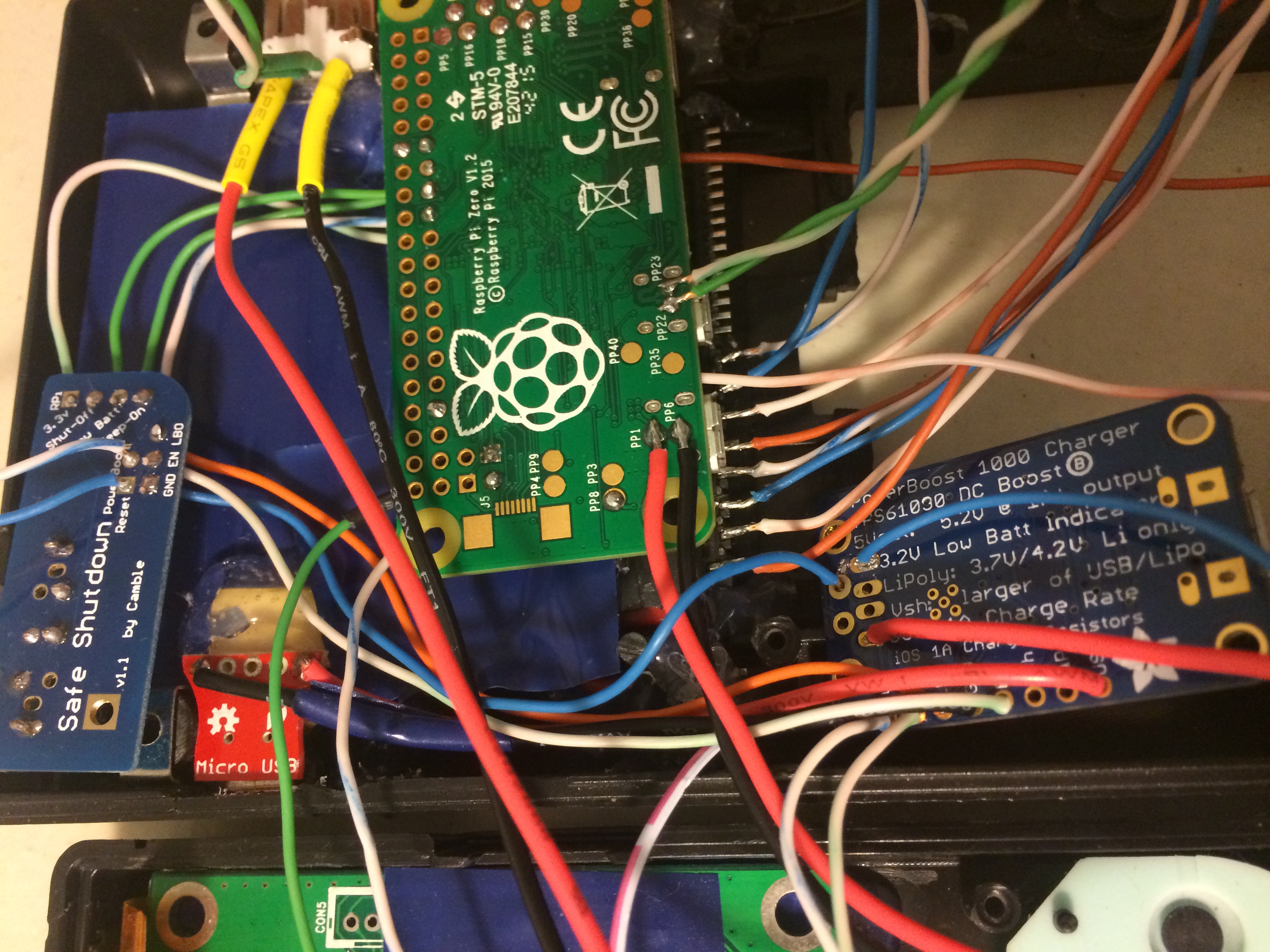

Ganreizu wrote:@camble
I got a metric ass ton of wiring and whatnot done these past few days. Fully wired up the shutdown pcb today and it works great! I noticed that when the battery is plugged into the powerboost and it is charging through the micro usb, it doesn't safely shut down (and similarly when the battery is unplugged and the system is powered by the micro usb). When the battery is the only power source it works like it should though. Have I done something wrong or does the graceful shutdown just not trigger for those cases?
PS: When i was setting up the script I noticed that rasppi's default keyboard is for the UK and had trouble finding "~" for a good half hour lol. May want to mention changing the keyboard default to people's "normal" layout in the guide. :D
I actually have the same behavior with mine. As long as it's only on battery it works (most of the time), but will never shutdown nicely when plugged into power. I'm guessing it's fluctuations in either the FET or maybe the 100k resistor? not sure, but I exhibit the same thing...

Camble wrote:@Ganreizu Glad to hear it! I'm not sure how you'd find the tilde on a US keyboard if the layout is UK to be honest. I know the tilde is beside the "1" for you, but it's beside Enter for me, along with # (our pound is £, on the 3 in place of # funnily enough) :roll:
It should shutdown regardless of power source, so as @SidSilver has said you may have missed something. I can take a look to confirm if you post some pics.
~ ended up being above enter on the british keyboard haha. There's a code to change they keyboard to us in the optimizations thread, i'll edit this post with it in an hour or so.

@jsawhite @Ganreizu That is very strange. Your wiring looks fine to me. I'll need to see if I can recreate this.

Camble wrote:That is very strange. Your wiring looks fine to me. I'll need to see if I can recreate this.
I'm going to replace the wires for the micro usb itself and see if that's it. The ground wire was slightly burned through exposing some wire so that's why that tape is wrapped around it, and the connections to the pcb are strained because of the wire length. Besides that I don't see what is abnormal.
Once this is fixed I only need to connect the cartridge reader and finish wiring the AIO and i'm done!
Edit: @camble I switched out the wires for the micro usb port but same behavior. D:
