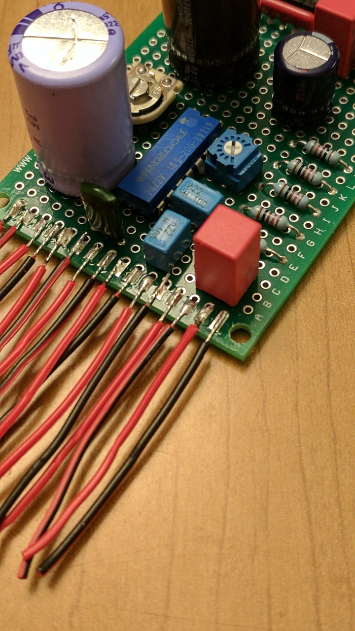

JadeDragon4866 wrote:
Mon Jul 10, 2017 10:42 am
Awesome guide, took your advice and got some practice in and now I'm more confident and ready to start my 3 pending Sudomod projects!! Can't wait to read the next part! :D
That is some mighty fine soldering right there. Congrats!
Turn the board over and show the upskirt shot ;)
JadeDragon4866
Posts: 10
Joined: Wed Oct 26, 2016 10:10 am
Has thanked: 18 times
Re: [GUIDE] [UPDATE! Part 2] Soldering School - AKA Don't wreck your new AIO board!
Post by JadeDragon4866 » Mon Jul 10, 2017 3:25 pm
Lol here it is, not the best I've done but at least I think I can more than likely solder a RPi to an AIO without destroying it!
abrugsch
Posts: 971
Has thanked: 356 times
Been thanked: 430 times
Post by abrugsch » Mon Jul 10, 2017 4:34 pm
Yeah a bit of a mixed bag there but nothing terrible. If you get a flux pen you'd be able to clean those right up. It's mainly just too much solder with some very good looking joints mixed in
