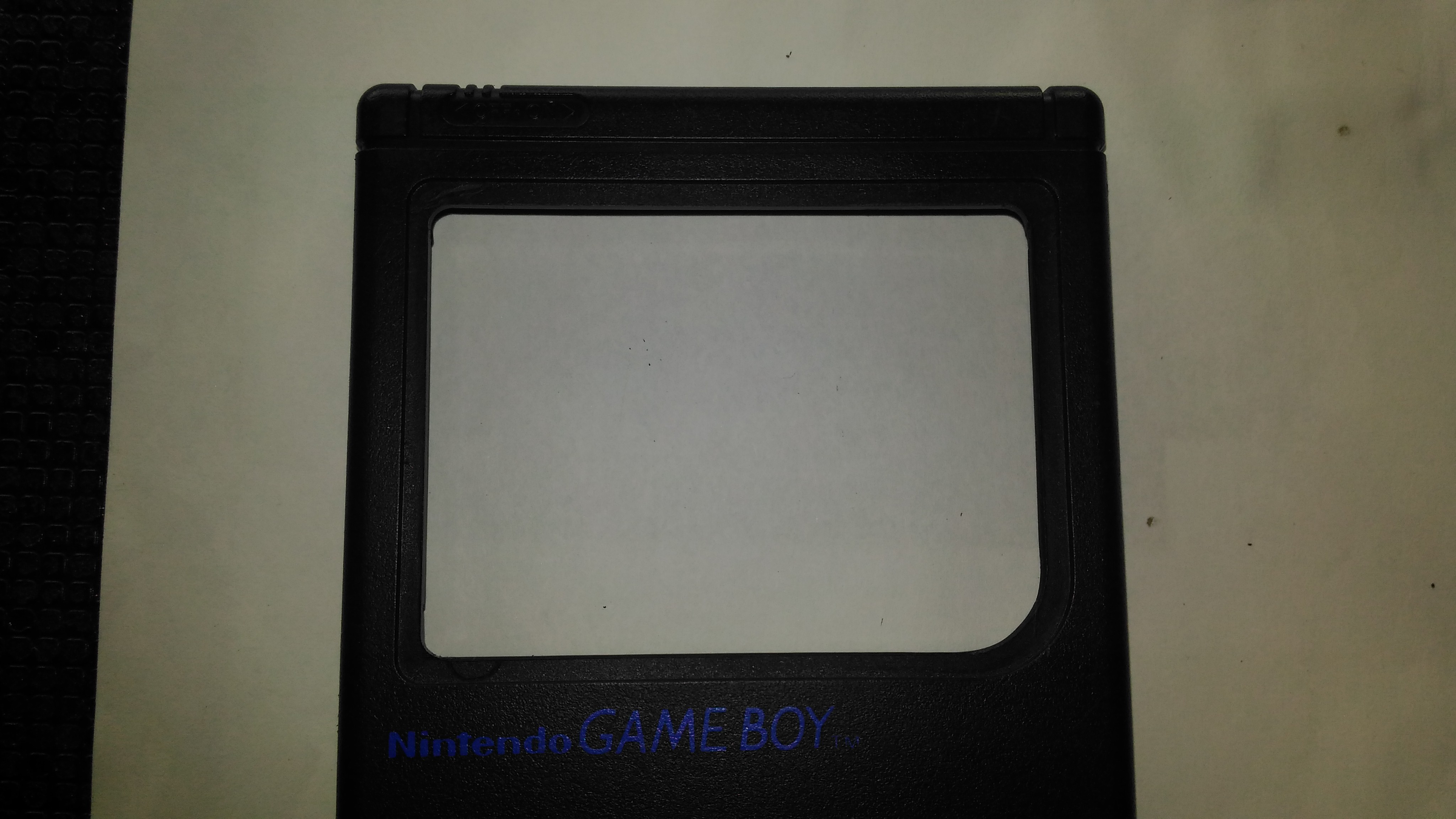

Actualy mine was cuted by 2.5W laser. there was needed plenty of passes, but the result is OK I think. next case I will try by CNC router.

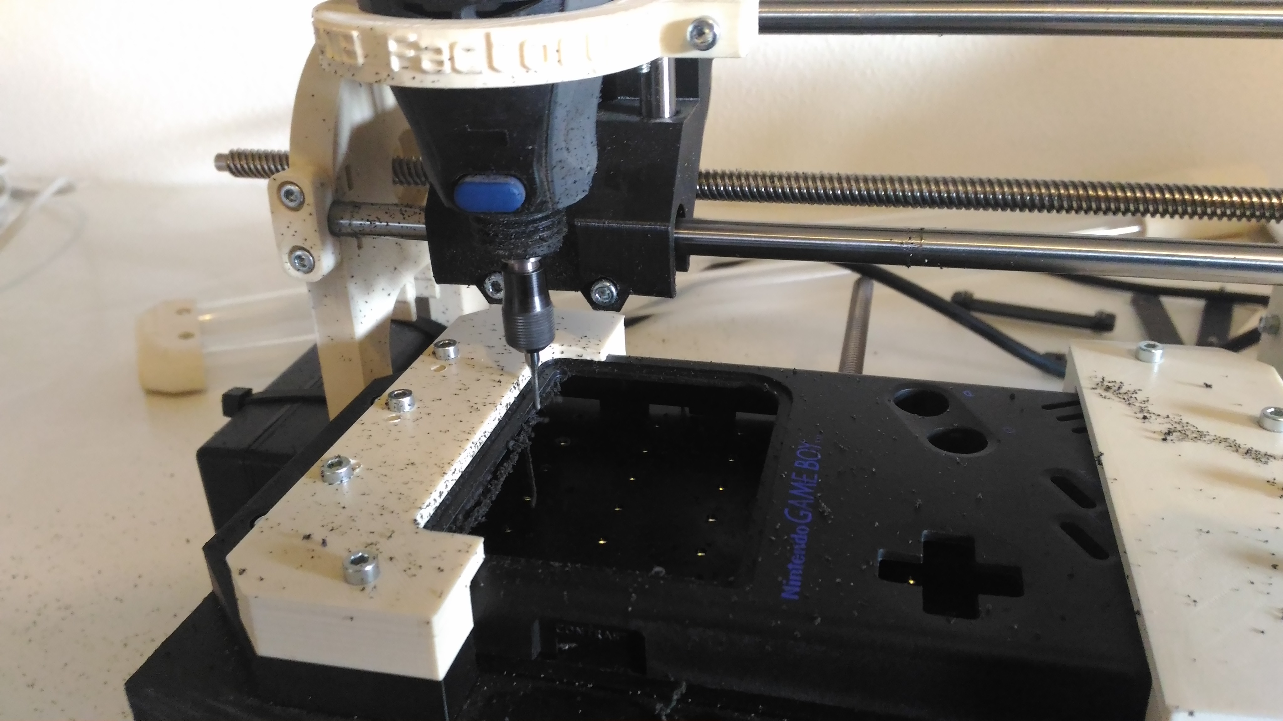

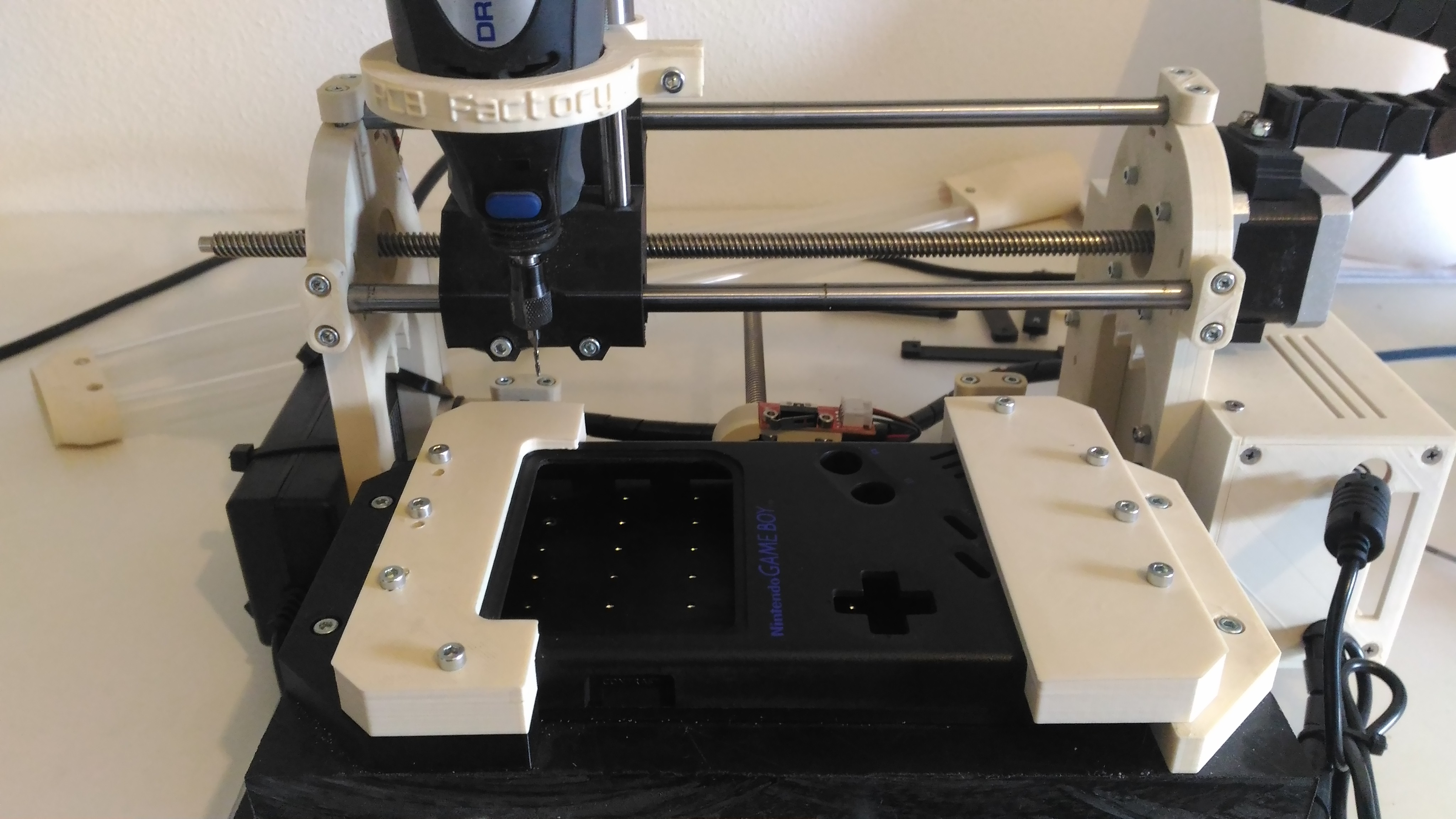

ok hope OP won't be upset for Hijacking the thread :roll: , but jig tool is done:
Unfortunately don't have spare case for tests so I tried to clean the one I had:
anybody have exact placements/dimensions for buttons?

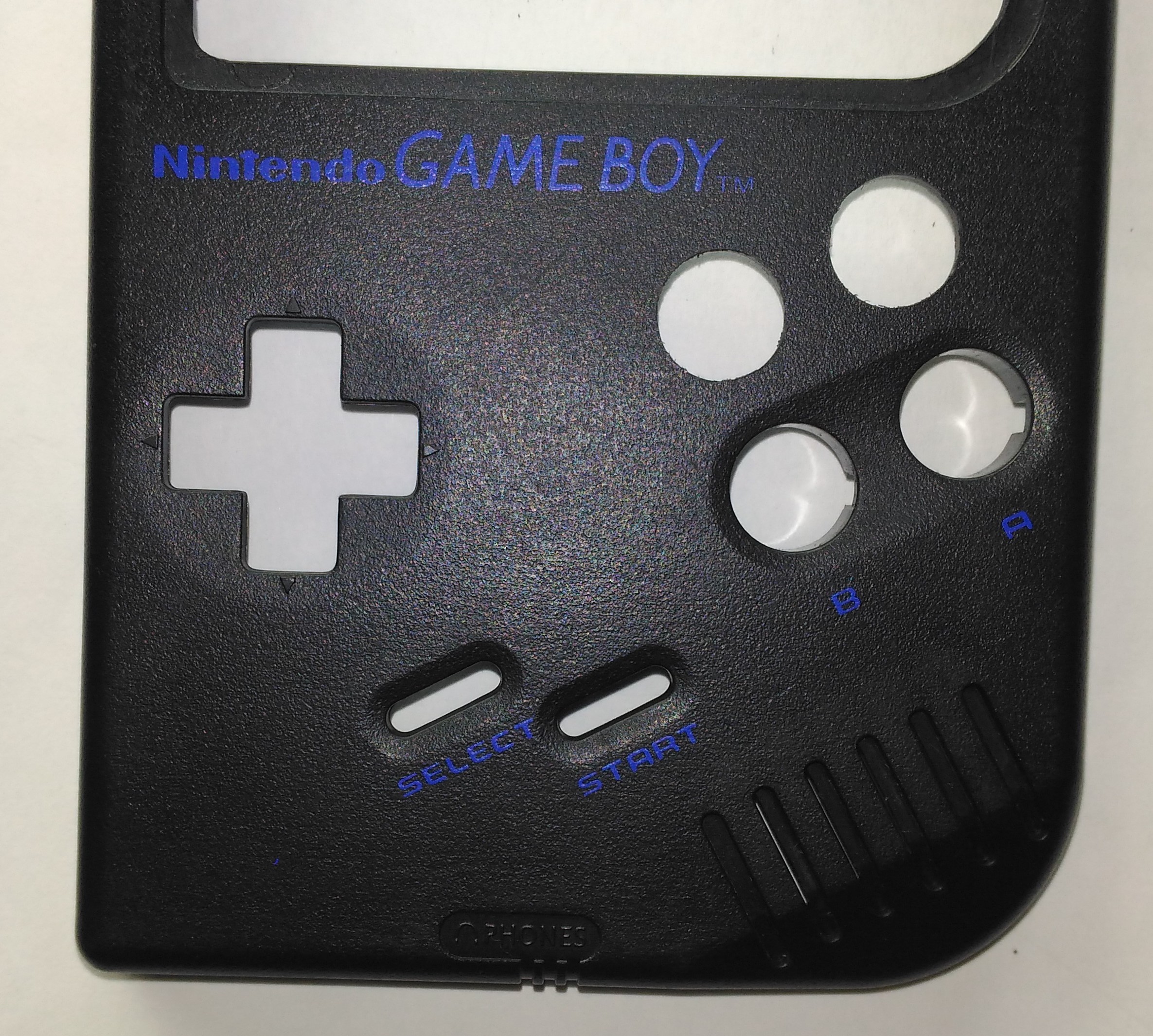

as per the position of the buttons, it varies by PCB manufacturer, I don't believe there is a standard. and I might be wrong, but I believe that the popular cards here on site (helder, kite etc.) are not open source. but you seem to be comfortable with calipers, so...

correct it's PCB factory with some of my mods, e.g. direct drive leadscrew motors for x/y. I build this some time ago, but haven't much time to play with ...
What factory you means? just a few CNCs (laser burner, few 3d printers, CyclonePCB, H-300 CNC ;-))
I have already some measuring/drawing done, however better apporach is to wait for AIO board.

I think the button hole placement is public knowledge. In fact Kite, in his guide, discusses the exact measurement in relation to the A and B buttons. In there he also has a 1 to 1 image of his board that if printed at 100% is an exact duplicate. Helders hole placement are the same. ;)

sorry I was wrong: I just checked, I can confirm tho that Kite's IO, Helder aio2.2, Helder's PCB V1.3, as well as kitsch-bent control panel rev.1 all match. (keep in mind that Kite has 2 ways to drill the buttons). I seemed to recall that some cards had different button placement. maybe it was just an old version of of 1 of them.
of course in the guide it tells you where to drill the holes, it is 16mm between all holes, and holes are 11mm. but I assumed they don't give you the .gc file or .dxf file or whatever. and I'm not sure of the holes are a perfect square from eachother, or if they are more of a diamond set-up, if you understand what I mean.
but I might be wrong again!! :mrgreen:

Post by kubino » Wed May 10, 2017 3:11 am
ok X/Y routing completed :
