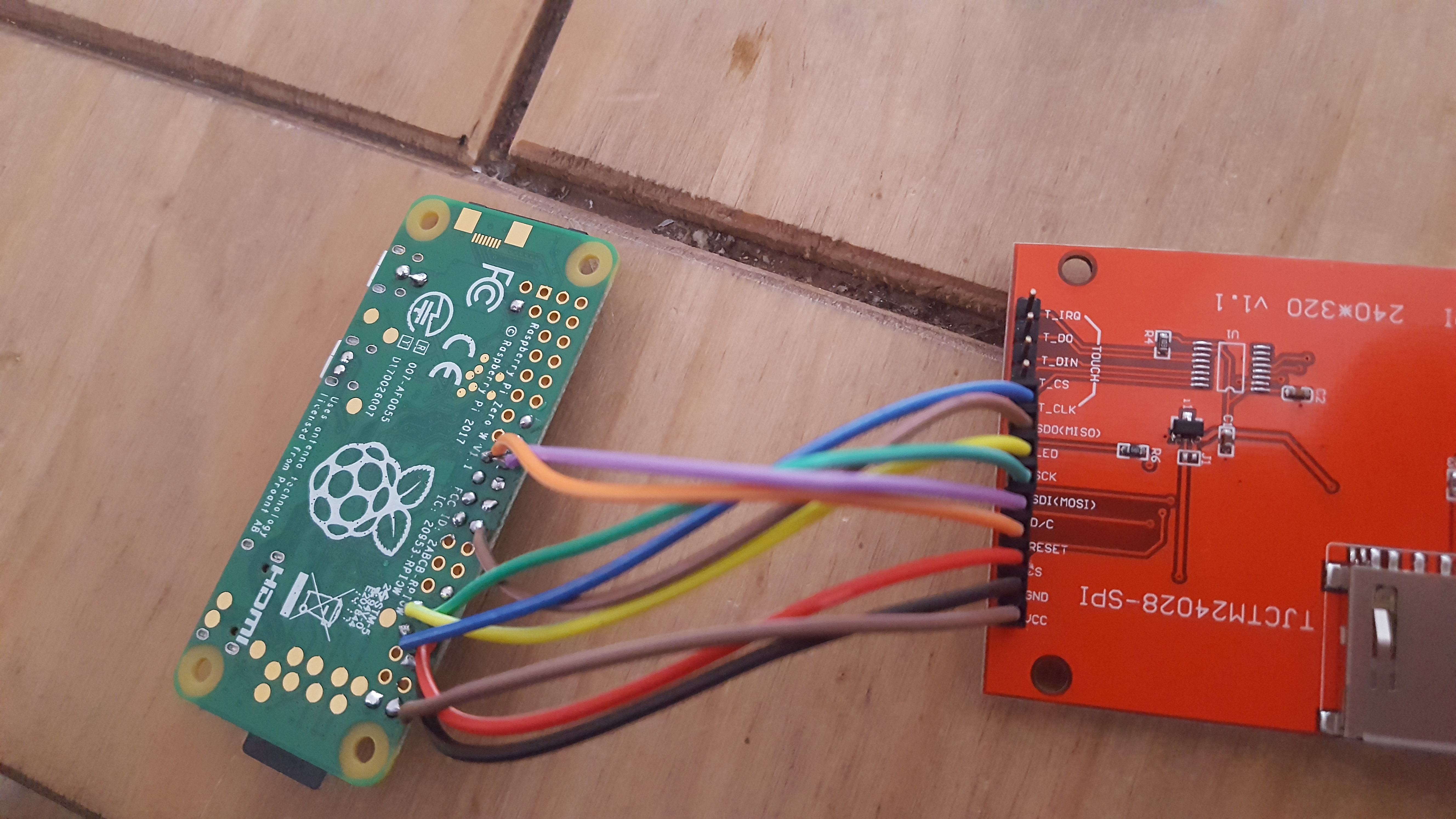

right, so i now get the white screen but can not get my text to show up, it stays white? is this likely to be the wiring?
hopefully you can follow the wires :D
gpio layout
vcc - gpio 2
gnd - gpio 6
cs - gpio 8
reset - gpio 25
d/c - gpio 24
mosi - gpio 10
sck - gpio 11
led - gpio 18
miso - gpio 9

ah i think you might have pin and gpio mixed up the screen pins tend to be in a bunch near the center of the gpio
kinda like this
the bunch at the bottom are for GPIO buttons
Display--------Raspberry Pi
BL--------------pin 12 (GPIO 18)
SCK------------pin 23 (GPIO 11)
MISO----------pin 21 (GPIO 9)
MOSI----------pin 19 (GPIO 10)
CS--------------pin 24 (GPIO 8)
RST------------pin 22 (GPIO 25)
D/C-------------pin 18 (GPIO 24)
VIN-------------pin 17 (3.3v)
GND-----------pin 20 (GND)
