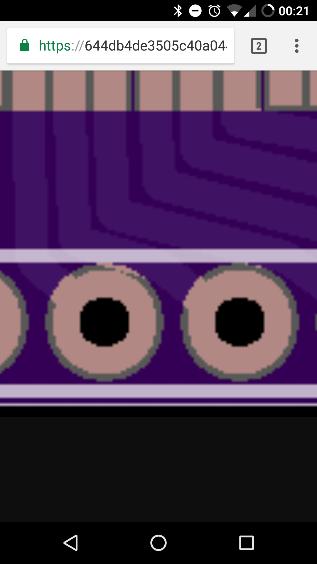

moosepr wrote:
Sat Aug 26, 2017 2:28 pm
Hahaha, mine worked ok, they are cheap enough, maybe check for shorts though
Check for shorts between the pads I mentioned in the previous post before soldering.... I think the spacing might be too tight relative to the manufacturing accuracy.... could be sold however with a small knife cut.
I will post a video later!
moosepr
Posts: 524
Has thanked: 69 times
Been thanked: 241 times
Re: [Guide] ili9341 SPI TFT Screen on Retropie
Post by moosepr » Sat Aug 26, 2017 5:22 pm
Ah yes, looking at the board on osh I can see where might be an issue now!
I need better traces on there! Good spot
