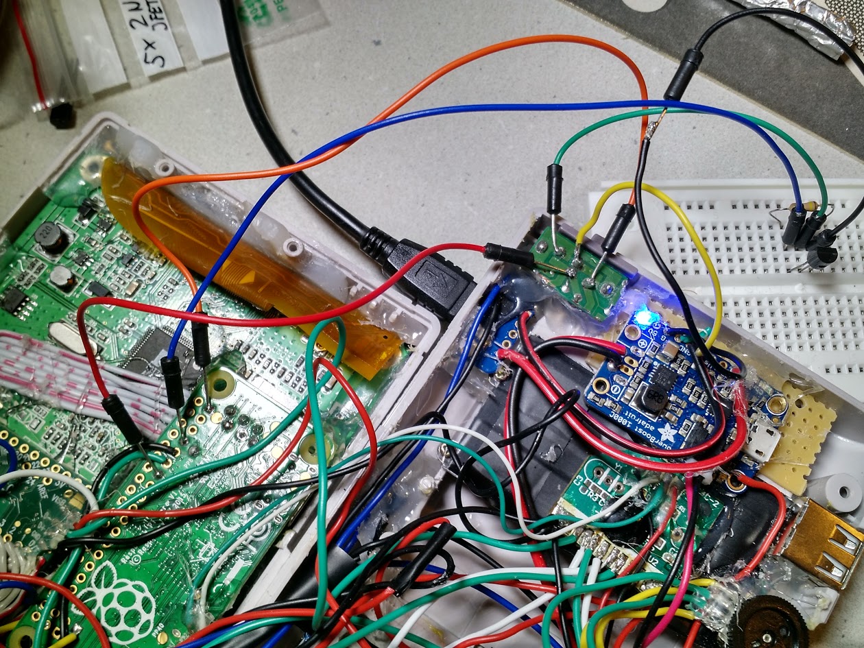

I'm trying to get this working. Can someone review my wiring? It boots just fine when the switch is set to "off" position, but when put into "on" it just cuts the power.
I connected it like this:
Drain to switch
Source to GND
Gate to BCM 4
EN (powerboost) to switch
the other side of the switch is:
3v3 to BCM 27
