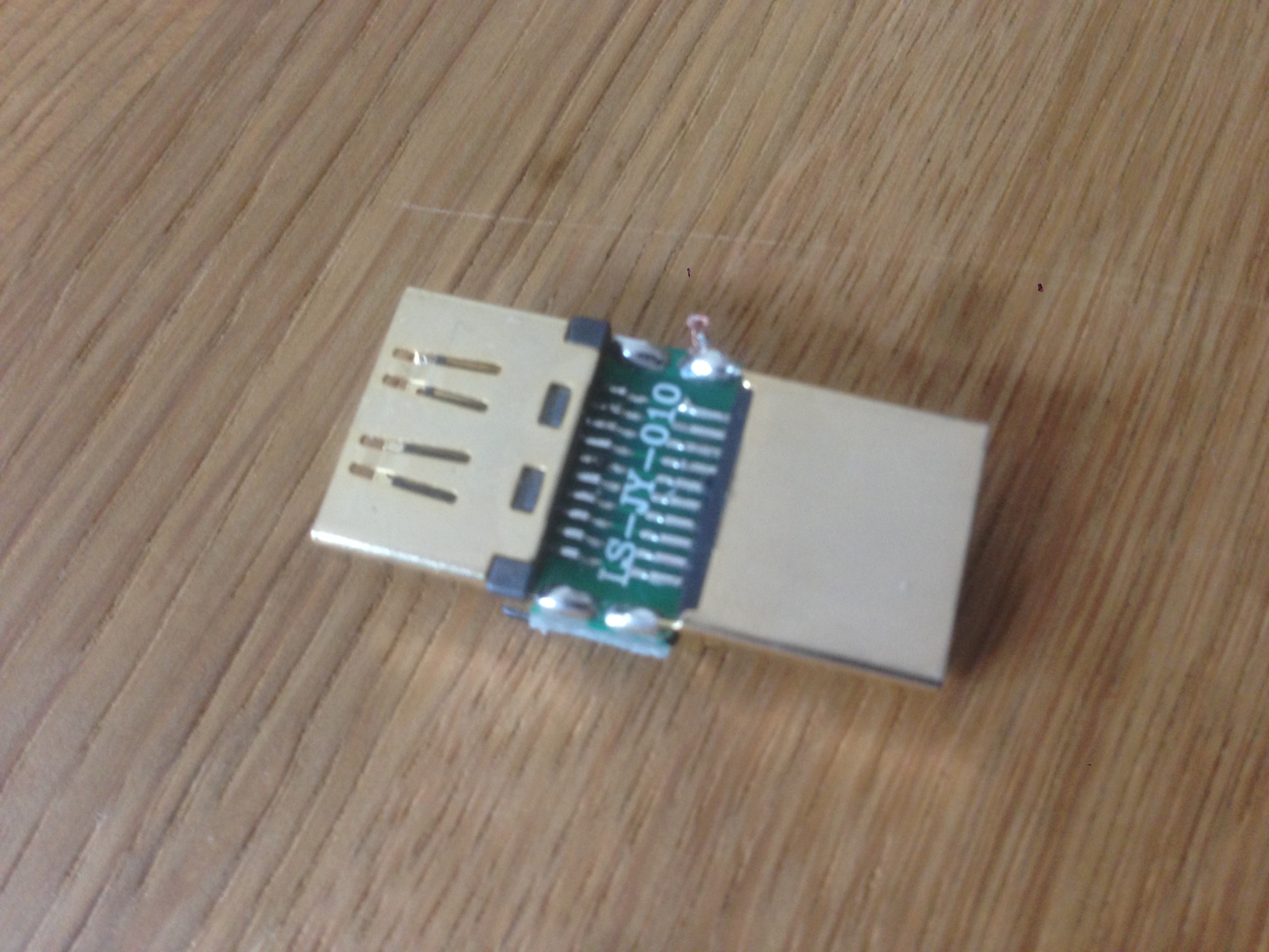

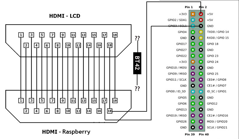

I've a question ... about HDMI Power USB, where in your SNES Controller did you put this adaptater ?
And regarding solder you've done on this adaptater, I saw 5V pin (18) and Ground pin (17), in order to get 5V from HDMI Power, I've to solder the component we see in your picture ?
A unmount all my adaptater (I've got another one) and I think the + cable (red) have been solder on between pin 18 from in/out ... but don't know how they solder the ground cable (black) ? And help with picture includes , could you tell me where and how solder the component you add ?
IF someone can help me in the schema ? Where solder the BAT42 Diod ? Why wired like this, there is no 5V output ?
This is not the adapter that you need. you need the adapter in my tutorial that gives you a usb level 5V on the hdmi at the TV end. on the pi you only need the one wire jumper shown to get the power from the hdmi connector on the pi zero to the gpio 5V pin.

Is the sole point of the diode to reroute 5V back up the HDMI cable to power the Pi Zero, and without the diode, the USB power adapter would not power the Pi Zero in its stock/unmodified state?
EDIT: Nevermind. Answered my own question (it's "Yes").

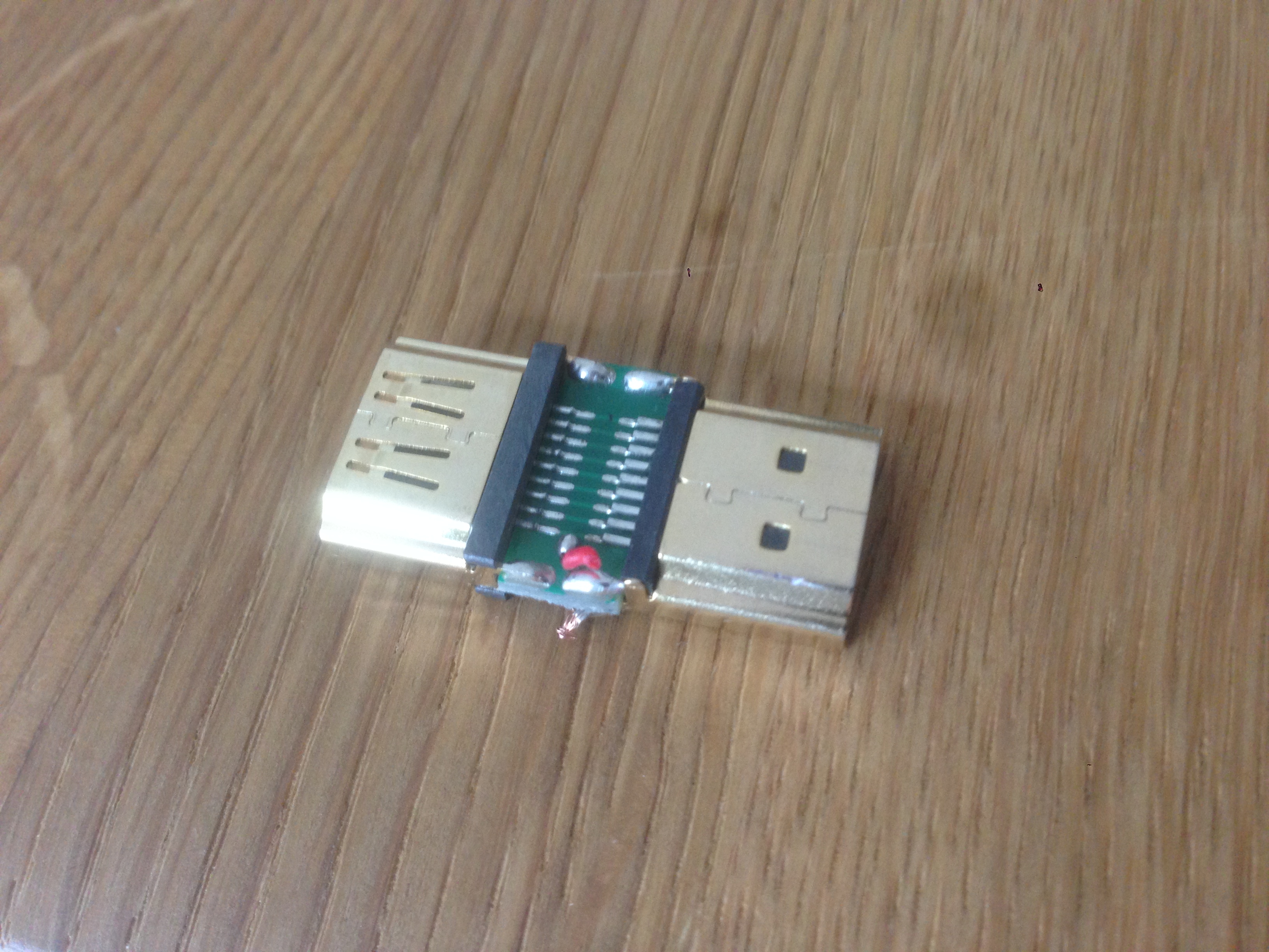

I'm not sure I completely understand how the hdmi-usb adaptor powers the pi. Does the usb have to be plugged in on the TV-side of the cable, or does your modification mean you can power the pi directly from the hdmi plug?
The USB cable needs to be plugged into either the TV or a 5v supply somewhere, such as a usb wall adapter. The diode modification inside the adapter then allows a fairly large amount of current to flow back through the HDMI cable to power the pi using that orange wire soldered to the pi.
So yes, you need to plug in the HDMI cable coming from the pi to the adapter and into the TV, as well as supply 5v to the USB plug however you choose.

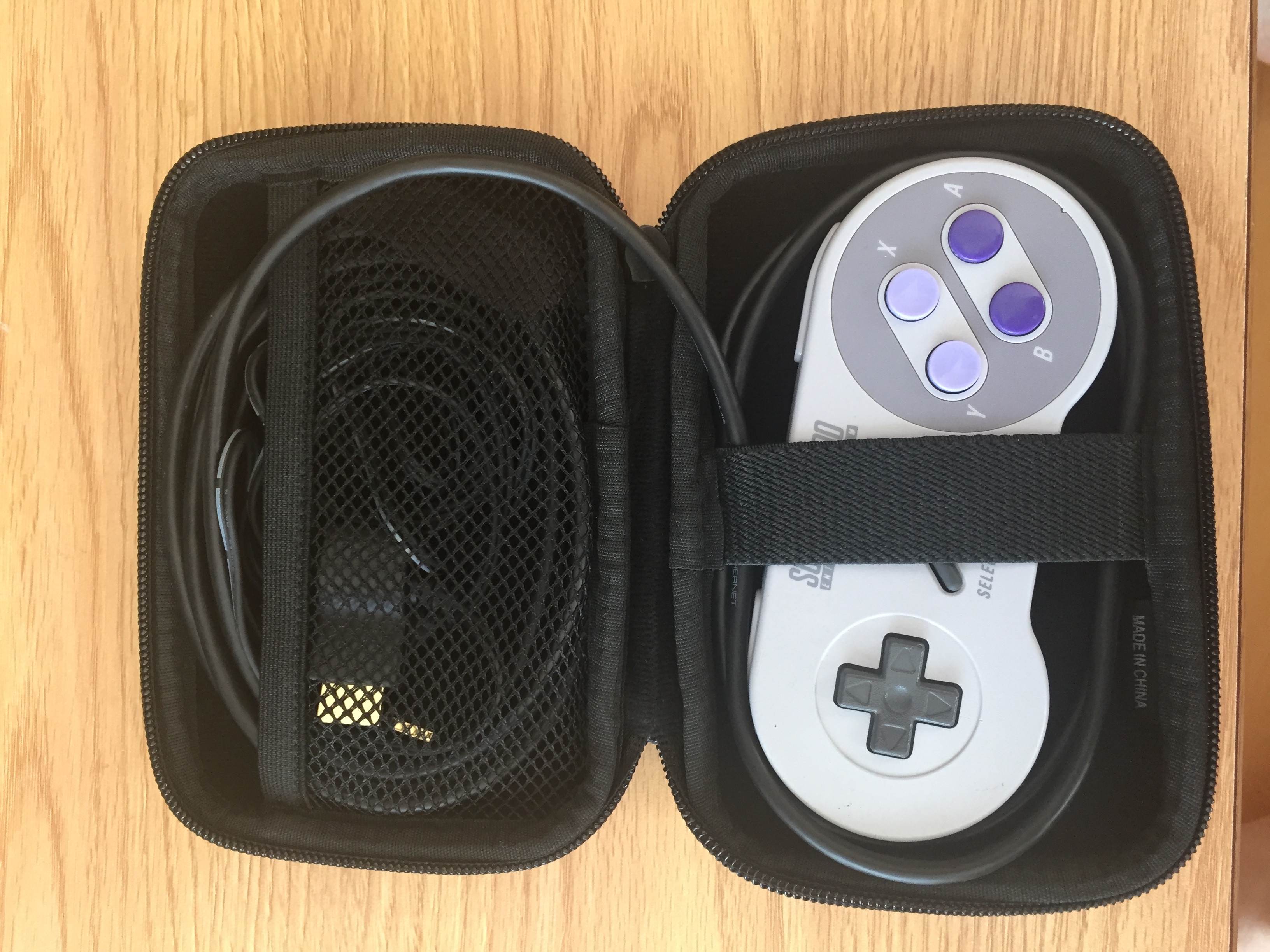

Finished mine. Love it!
A 6' HDMI cable would be less snug of a fit, but 10' fits as long as you wrap it properly
This is with the 10' HDMI cable and the USB cable, and it all still fits.
