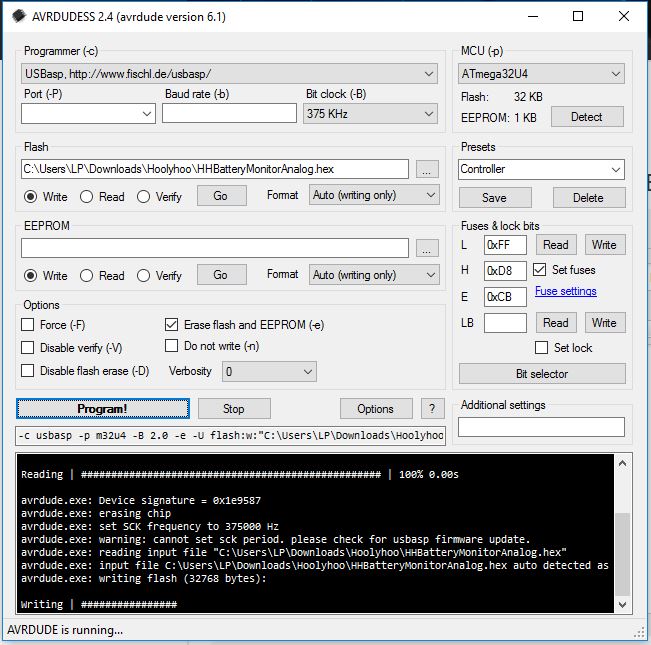

Upon connecting it detects AIO:
'Detected 1e9587 = ATmega32U4'
I then programme and all seems OK. As above, i tried Helders Hex and it detects so not sure its the programming? Odd though as others have had success and im using an AIO2.2

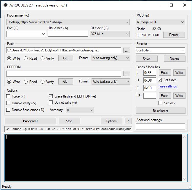

Here are screenshots of the programming start to finish:
Setup:
Writing:
Complete:

It looks fine. I uploaded a file called TestAnalog.hex to my github. Can you test that please?

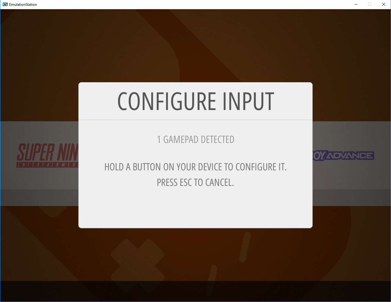

This is with a leonardo on my computer since I don't have a Helder board available right now but its the same thing.
Screen Shot 2017-05-18 at 10.59.44 AM.png (372.28 KiB) Viewed 17030 times
