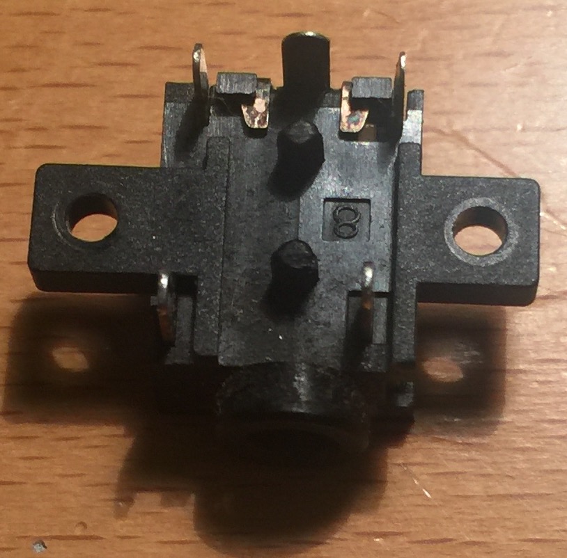

Hi,
I've been lurking in these forums for a while as I build my gameboy zero. I'm getting ready to work on sound. My DMG headphone jack seems to behave as alien0matic describes it. Perhaps there are indeed two different versions of the DMG jack. There are subtle differences between the tops (non-pin side) of the jacks in the first post and mine. Namely, there is no "3-1" imprint and there are two smaller windows exposing metal on the side opposite of the jack, instead of one bigger window. I have two gameboys, and both the headphone jacks look like this.
See the photo.
See the photo.
- DMG headphone port
- IMG_5093.jpg (2.97 MiB) Viewed 58022 times

Re: [Guide] Audio-/Headphone Jack Information Thread
This looks like a 4 pin jack, as far as i can tell by that blurry picture.BigEternalEnd wrote:Hi,
See the photo.
I have the same DMG jack (actually 2) as BigEternalEnd - no "3-1" on the top side. If you flip it over with pins up and jack facing you (these are desoldered from the board) and use the numbering scheme from the diagram on p1 of this thread you get the following with a DMM:BigEternalEnd wrote:Hi,
See the photo.
NOTHING PLUGGED IN
Pins 3 & 4 have continuity, nothing else
JACK PLUGGED IN
Pin 1 = Sleeve (Ground)
Pin 5 = Ring (Right)
Pin 2 = Tip (Left)
I'm not sure, but based on these findings, I don't understand how this jack will pass audio to the speaker with nothing plugged in. However, it DOES appear that the 1, 2, 5 pinout for using headphones would be right.
I would be VERY excited for anyone to correct me. If not, I'll make a stop at Radio Shack in the morning and pick up Catalog #2740246.
THANKS IN ADVANCE!
I second that. After wiring per the general wiring diagram and per the shown wiring for the original GB jack, I had no sound. After checking the resistance on my jack and reading through this thread, I found my jack to also be different to the one shown in the first thread. The wiring from @alien0matic works perfectly.alien0matic wrote:I did use a DMM, I inserted a headphone into the jack and I measured continuity on all pins. There are NO output pins.
The pins you labeled with 1, 2 and 5 are correct to be ground, left in and right in. But there is NO continuity betweent pin 3 and pins 1,2 or 5. Same goes for pin 4.
But there IS a connection between 3 and 4. The connection is cut when the headphone is inserted.
Have a look into this thread: http://www.sudomod.com/forum/viewtopic.php?f=22&t=197
He connected the input pins (2 and 5) to pin 4 and pin 3 to the speaker. I did something similar, I have stereo sound connected to the jack and forward right to Pin 3.
I only have this image, everything else is blurry. Green is left, yellow is right, black is ground. White goes to the speaker. The jack is in the same orientation as in your image. This way everything works as expected.
[spoiler="wiring image"]IMG_20160807_130332.jpg[/spoiler]
@Fleder here are some pictures of my jack, which are not as blurry as the ones yet in here, in case you want to update the first post, showing that there might be different wiring solutions.
