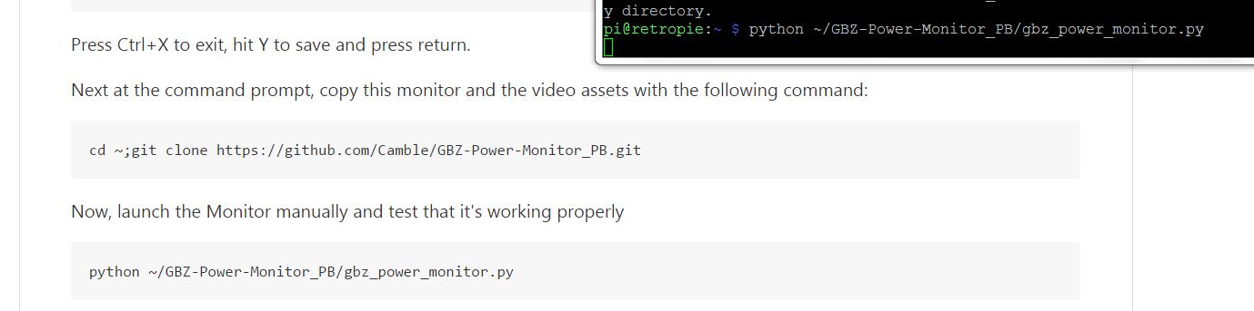

Hi there,
I have two issues on this (with the second potentially being a result of the first):
1: My power switch works "vice-versa", in off position it switches on, when sliding to off position, the GBZ shuts down. I have posted pics in my build log: http://www.sudomod.com/forum/viewtopic. ... 891#p20891
2: When trying to setup the power monitor, putty input "freezes". I can't do anything after entering this command, and nothing happens on the screen, so I'm not quite sure what to do here.
I'm happy to hear any idea on how to fix this.
Thanks!

Post by Camble » Sun Nov 27, 2016 6:21 am
@larsen2011 You have your switch wired up backwards. And you won't see anything in PUTTY while the python script is running, until it acts and causes a shutdown.
