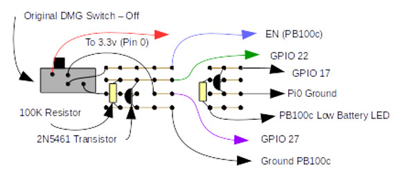

I'm trying to figure out Camble's Graceful Shutdown Switch and Popcorn's Low Battery Monitor using the DMG switch. Am I even in the ballpark with this?
I forgot to add the labels for the 47k resistor and the 2N3904 transistor.

Re: [Guide] Graceful shutdown switch without Pololu
Post by alien0matic » Fri Aug 26, 2016 12:55 am
Regarding the tutorial it should be an 2n5460 JFET transistor. Don't know if you've misstyped it (two times) or got the wrong.
