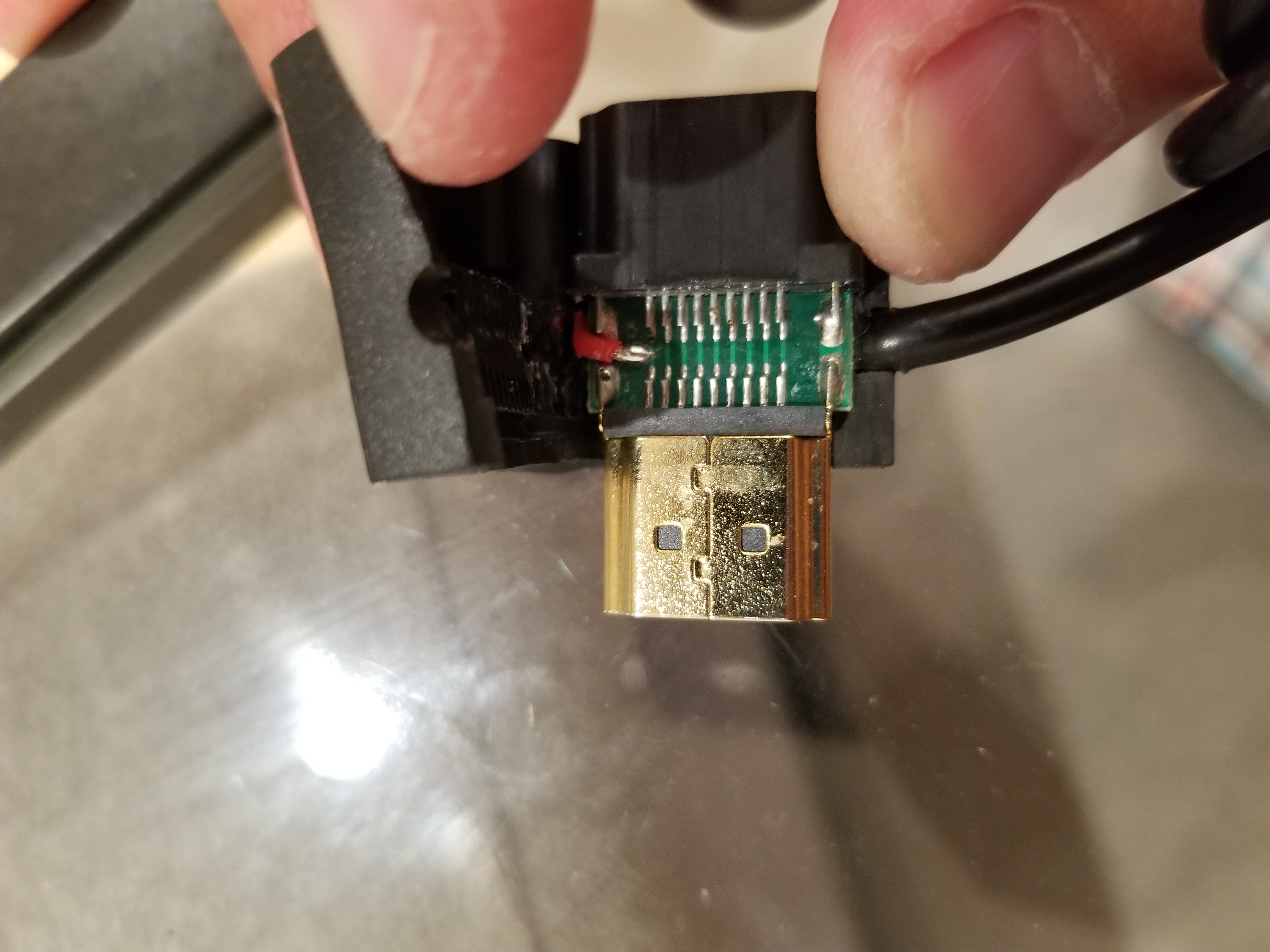

This is the hdmi adapter that I bought. Any one can provide insight has to how I need to wire the diode. Looks alittle different and I'm not 100% sure...Image

dkandy18 wrote:
Mon Oct 09, 2017 9:16 pm
Yeah I think it’s basically the same as the instructions tell you. The last pin to the positive wire... I’d use a voltmeter and check though, I don’t remember how exactly I wired mine. I don’t wanna be responsible for frying your tv somehow.

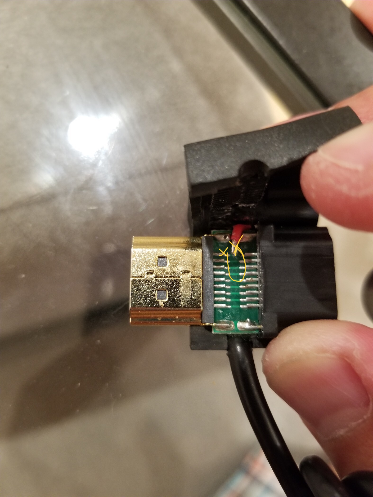

Ok I just opened mine up and the way I illustrated was correct. It’s hard to see because the power wires are in the way and I put glue over it to keep it in place but It’s the same as I described in the previous photo

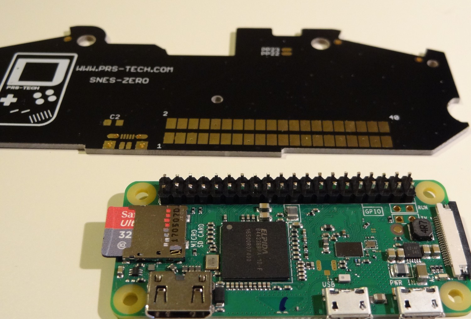

I guess it's too late, but in case someone else from Germany might have the same question, here's what I got ... I also have a question for those of you who already built the SNES Zero. I just got my PCB board today. However, I don't know how to solder it to my Pi. As you can see in the attached image, I got a Pi with presoldered header because I thought that would make it easier. I'm quite new to soldering, so I don't know how to connect the pins to the flat surface of the PCB board. Any hints/pictures that might help me?
EDIT: Never mind, I just realized that I totally misunderstood how this worked. I thought the SNES Zero PCB was through-hole because I couldn't really tell from the pictures. So I guess I'll have to desolder the header and get an SMD one. What a waste of money (and time)... :?

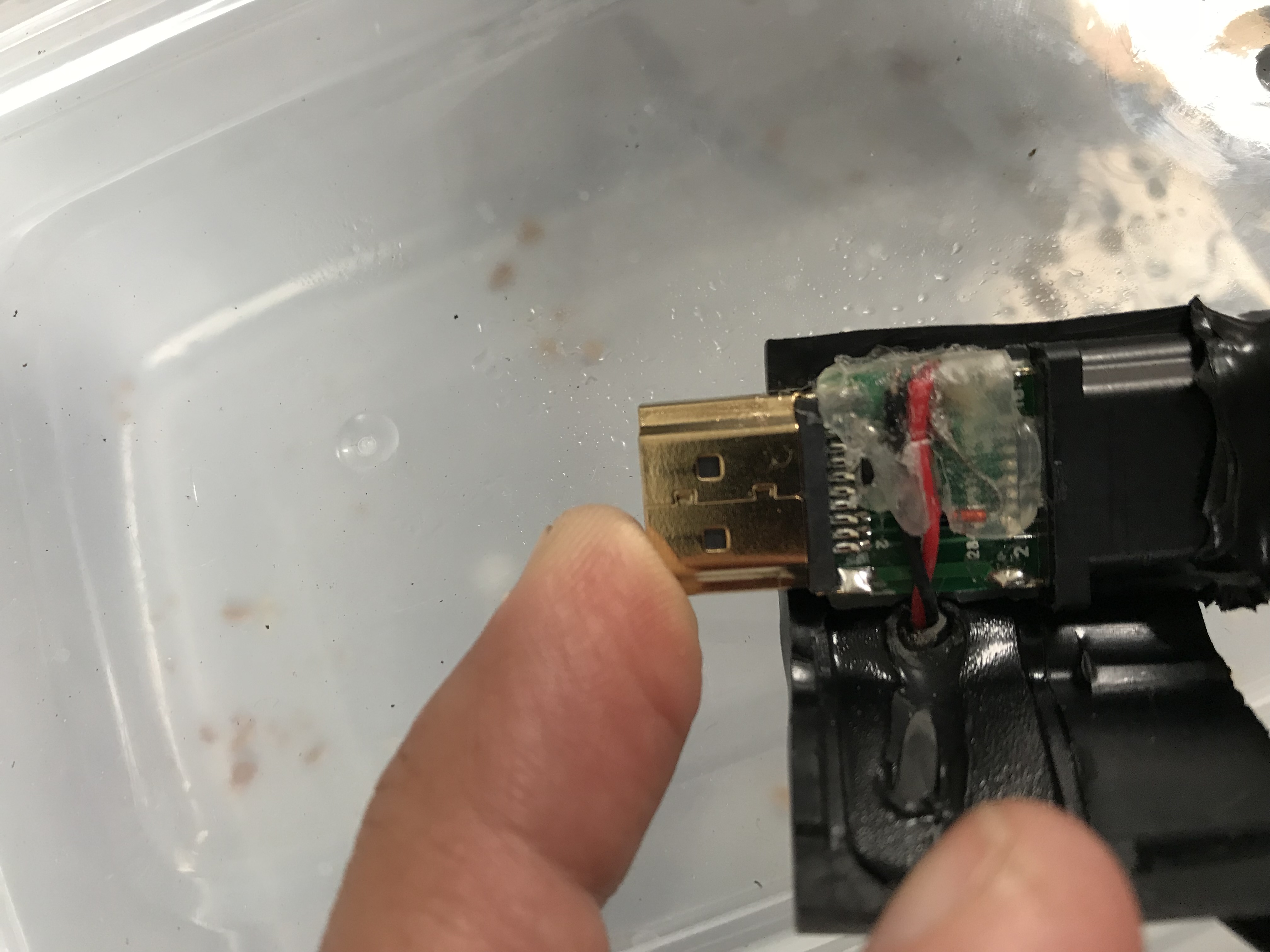

Ok I just opened mine up and the way I illustrated was correct. It’s hard to see because the power wires are in the way and I put glue over it to keep it in place but It’s the same as I described in the previous photo 41769C7B-98ED-4203-902C-E996F3D7740A.jpeg
In fact this was wrong. I just did one with the same unit. The red wire is soldered onto a pad which accesses the power pin, so if you simply add the diode, it does nothing (as the power can already go through the pad). If you want to use the diode (you don't need to) - you need to remove the red wire from the pad, then put the diode between the pad and the wire.
Ahhh good eye.
